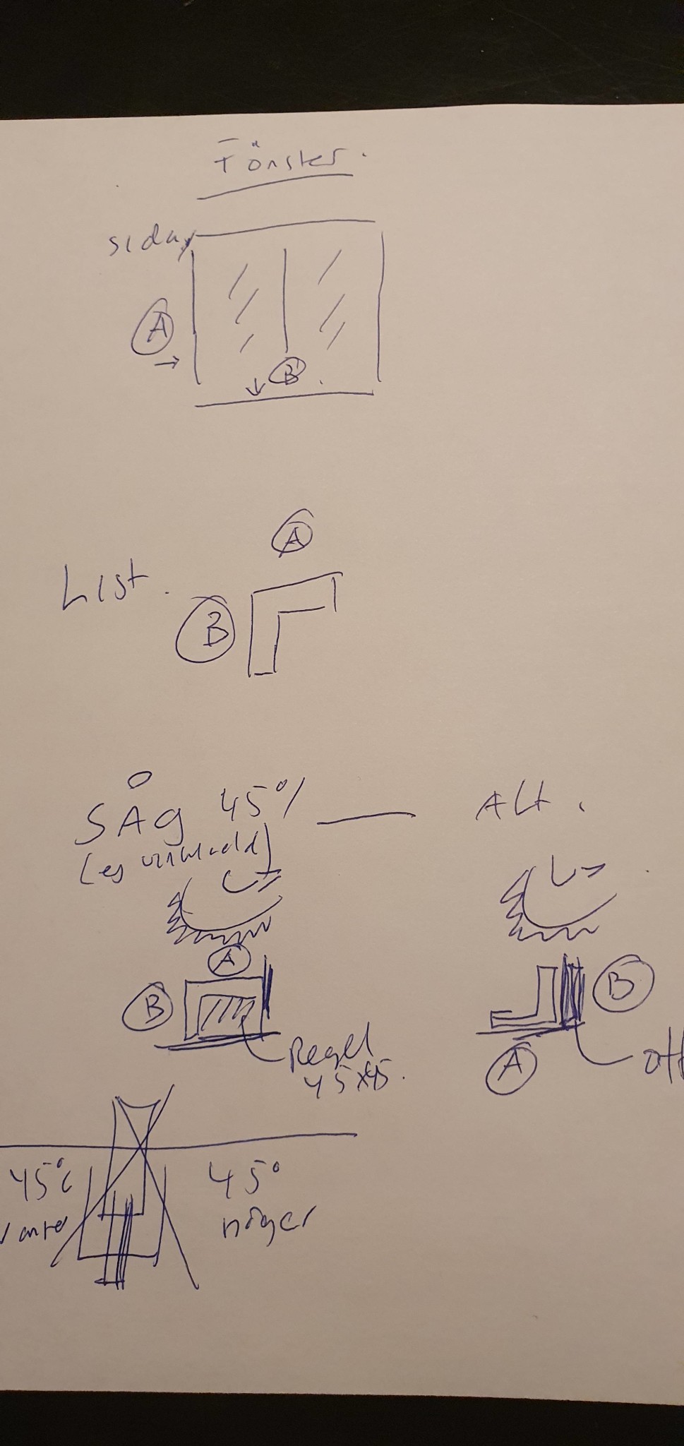

How to miter corner trim around windows?
Then your friend is joking with you. Exactly one cut is needed. (Or two, one at each end, of course).Hammare&Spik said:
But is your list symmetrical? Or is there a long and a shorter flap? In the upper picture, it looks like the list is asymmetrical and you have turned the pieces in different directions. You must also have the cut completely clean. You can't have protruding burrs, as it will never fit.
How are the angles around the window? It looks like the drywall is very unevenly cut. You need to prepare the surface so that the moldings truly meet at 90⁰.

Look at the pictures and get back to me when you see how the conditions look for me exactly!Mazen said:
But is your molding symmetrical? Or is there a longer and a shorter flap? In the upper picture, it looks like the molding is asymmetrical, and you've turned the pieces in different directions. You must also have the cut completely clean. You can't have protruding burrs, then it will never fit.
How are the angles around the window? It looks like the drywall is very unevenly cut. You have to prepare the substrate so that the moldings really meet in
Check the conditions for just me and get back to me once you have looked closely at the pictures.

Show a picture of how you are going about sawing, and we can explain what you are doing wrong.

I have to swallow my pride. I was wrong and you were right. Figured it out now.
You are not alone, I asked the kid who is doing Construction and he scratched his head for a long time before he could say how to do it... and he's not new to figuring things out.Hammare&Spik said:
