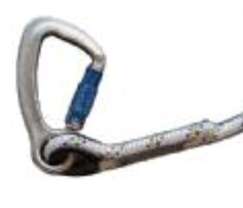

I've had such grommets in the sail, to be able to reef when needed. But I think it's an advantage to have removable reef hooks instead of fixed thimbles (even though it's a completely different situation). The ones I use are flexible carabiners or snap hooks of sufficient size to handle the grommet. It's more flexible if you need to replace broken ones, or change the length, of the tarp rope. See example

I have had such grommets in my sail, to be able to reef when needed. But I find it advantageous to have removable reef hooks instead of permanent thimbles (even though it's a completely different situation). The ones I use are flexible carabiners or spring hooks of sufficient size to handle the grommet.
It's more flexible if you need to replace broken ones, or change the length of the tarp rope. See example

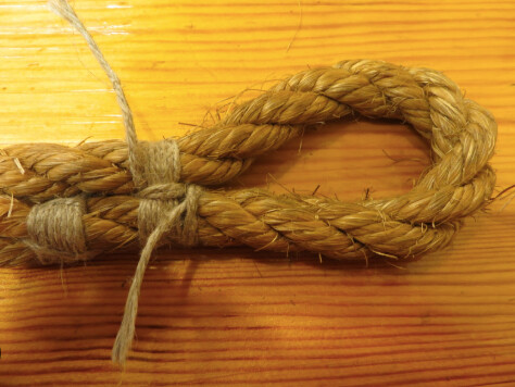

Absolutely, it holds well even without metal as there are both soft and hard solutions available. You can also use sailmaking tools to whip a loop if you don't feel like splicing, depending on how flexible or fixed the arrangement should be. I also just leisurely sail and prefer simple, uncomplicated solutions. However, for a heavy-duty tarp, the solutions for lightweight covers won't work.redarn said:
