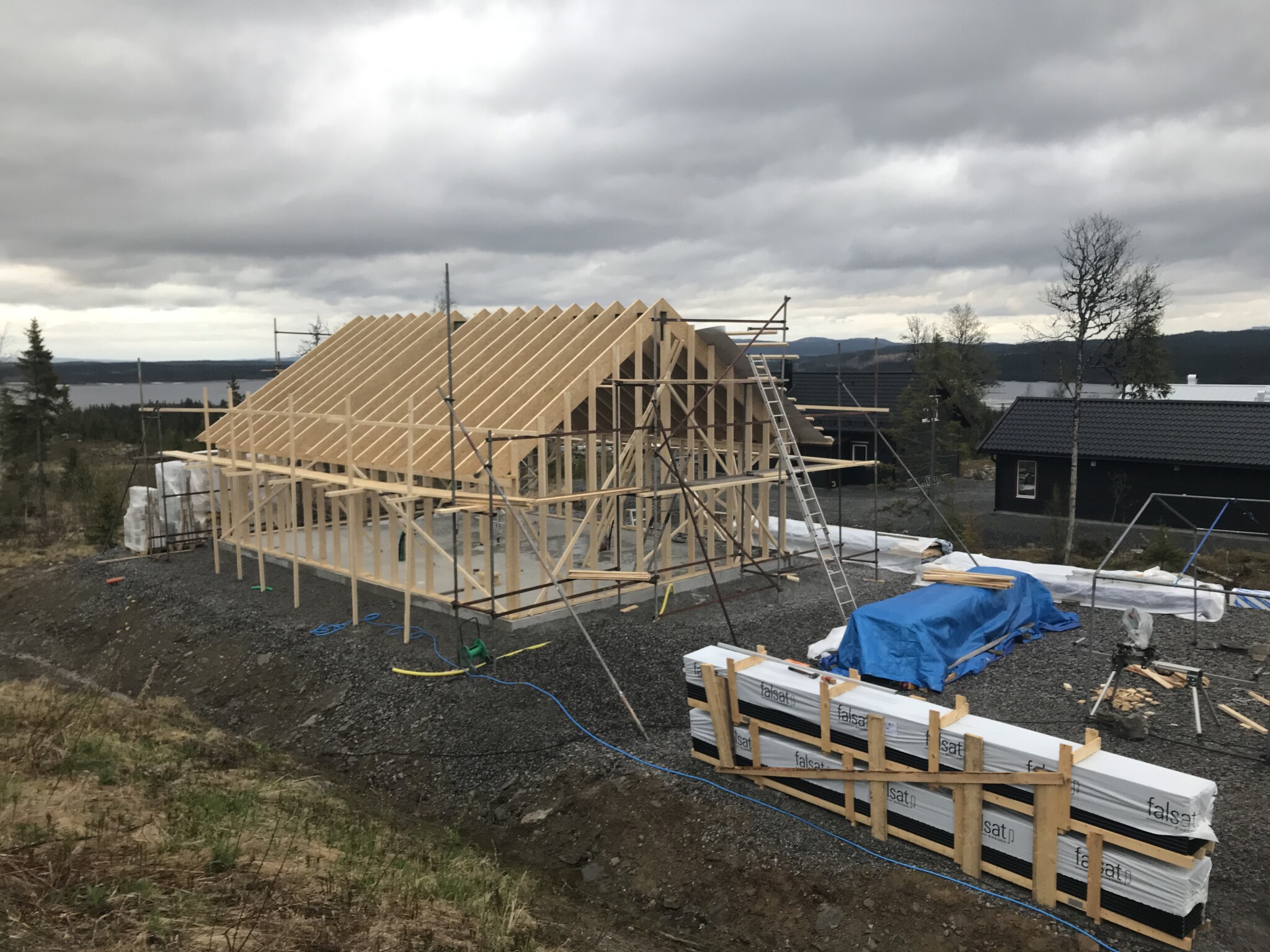

I meant if I build a house for myself, can it then be approved to use my own light beams in the walls, floor, and roof?
I wouldn't dare promise that. However, I know that it went well in my case, I've had these lightweight beams as rafters in my house for two years now. Neither the municipality nor the control architect had any comments or required any papers/certificates.

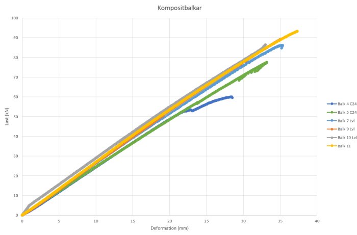

I have made similar beams in the form of box beams. However, they were not optimized at the end supports. I also considered using regular insulation but switched to XPS after some consideration. Tested the beams, a total of five, with both three-point and four-point loading to failure.
Material: C24 45x95 studs that were split to 70 mm, OSB 3 11 mm, XPS 70 mm, PU glue, and construction screws W 6.0x40 were used for beams 1, 3, and 5.
Beams 1 to 3 were 2500 mm, i.e., one OSB long. Beams 4 and 5 were 4200 mm long. The short beams were loaded with three-point loading and the long ones with four-point loading.
Beam 1 was constructed with only screw joints and a core of XPS. Beam 2 was both screwed and glued with PU glue. The XPS was also glued to the studs and OSB. I then removed all screws to simulate only gluing, i.e., the screws were only there to hold sufficient glue pressure. Sure, the screw holes theoretically provide a slight weakening, but considering the other distribution in material parameters, it is negligible in the grand scheme of things.
Beam 3 was both screwed and glued just like beam 2, but with the difference that the screws were left in place.
Beam 4 was the first beam I made and served as a bit of a pilot project. This beam was also screwed and glued. However, countersunk screws were used.
Beam 5 had the same dimensions as beam 4 but different screws, see above.
Since this is a hobby project, it may take a while before the full report is ready.
Hope this can inspire others.[image][image][image][image]

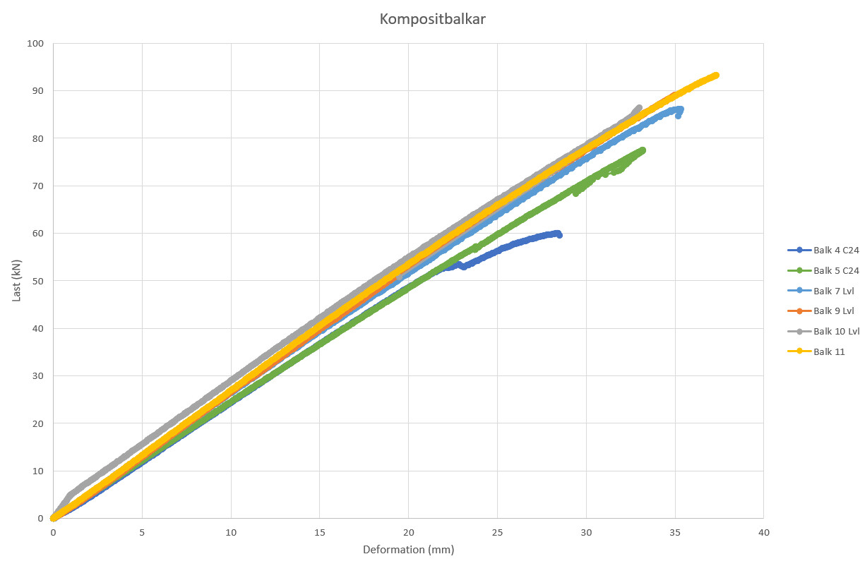

I have now started pressing my updated beams, which can be seen here. https://studio.youtube.com/video/w42MOqaZyZs/edit
In the first ones, I used construction lumber (C24), 45x95, which I split to 70 mm to match the thickness of the XPS insulation. In the new variant, I tried splitting a Lvl (Kerto) beam. The beam was originally 51x400x4000, which I later split to 51x45x4000. The reason for choosing Lvl was that they are significantly more dimensionally stable and therefore easier to handle. So far, I have pressed 4 beams with OSB as the core and have very good repeatability in my trials. I will press two beams where the core consists of 12 mm k-plywood for comparison. I will return with more information when time permits.
