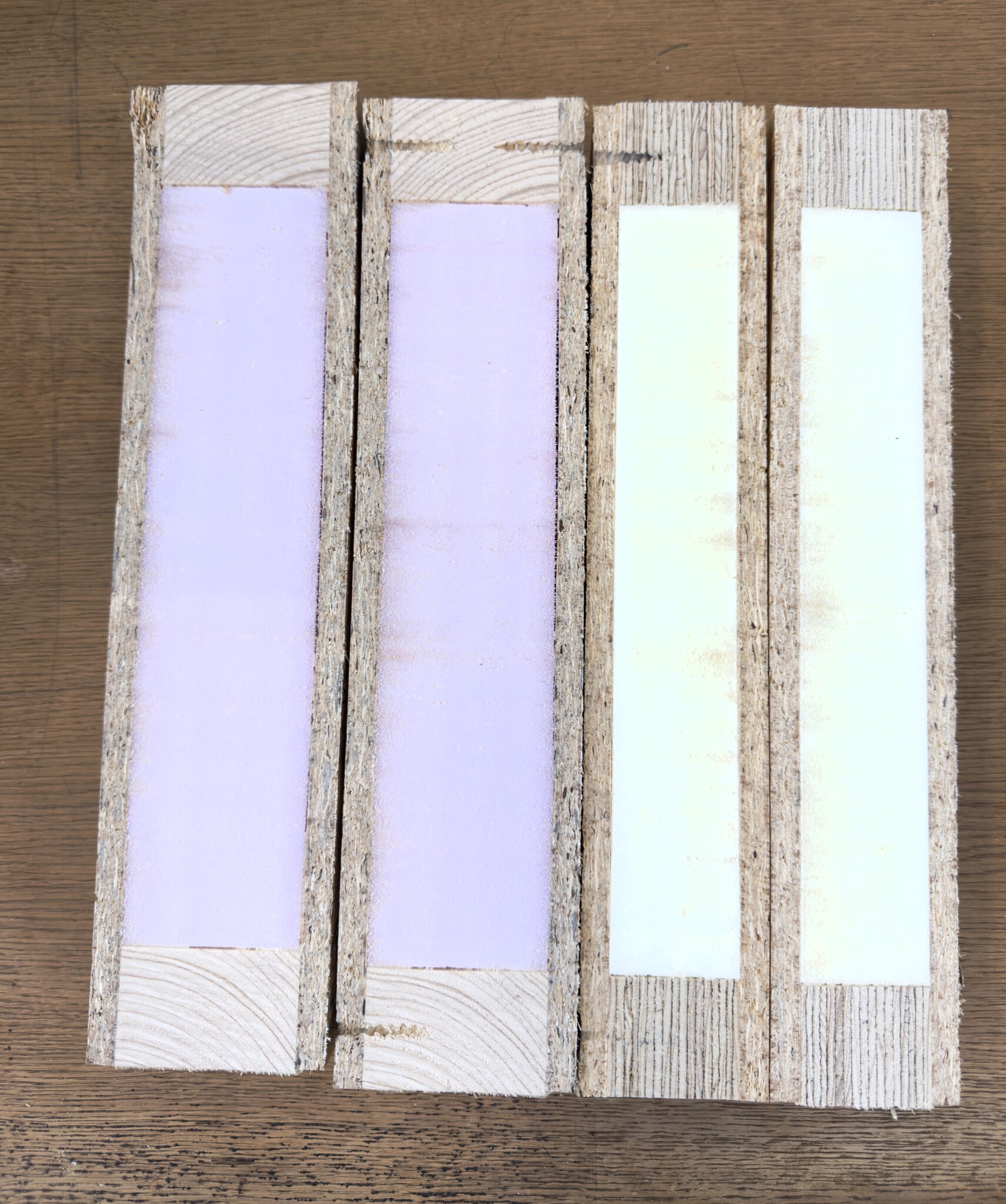

I have now started printing my updated beams, which can be seen here. [link]
In the first ones, I used construction timber (C24), 45x95, which I split to 70 mm to fit the thickness of the XPS insulation. In the new version, I tried splitting up Lvl (Kerto) beams. The beam was originally 51x400x4000, which I later split to 51x45x4000. The reason for choosing Lvl was that they are significantly more dimensionally stable and therefore easier to handle. So far, I have printed 4 beams with OSB as the core and have very good repeatability on my attempts. I will print two beams where the core consists of 12 mm k-plywood for comparison. More information will come when time permits.

I will choose lvl which I cut to suitable dimensions and then 11 mm OSB, but likely replace XPS with PIR as it has better fire performance, OSB provided better performance than plywood. Since the beams won't be visible, OSB seems best for performance/price.

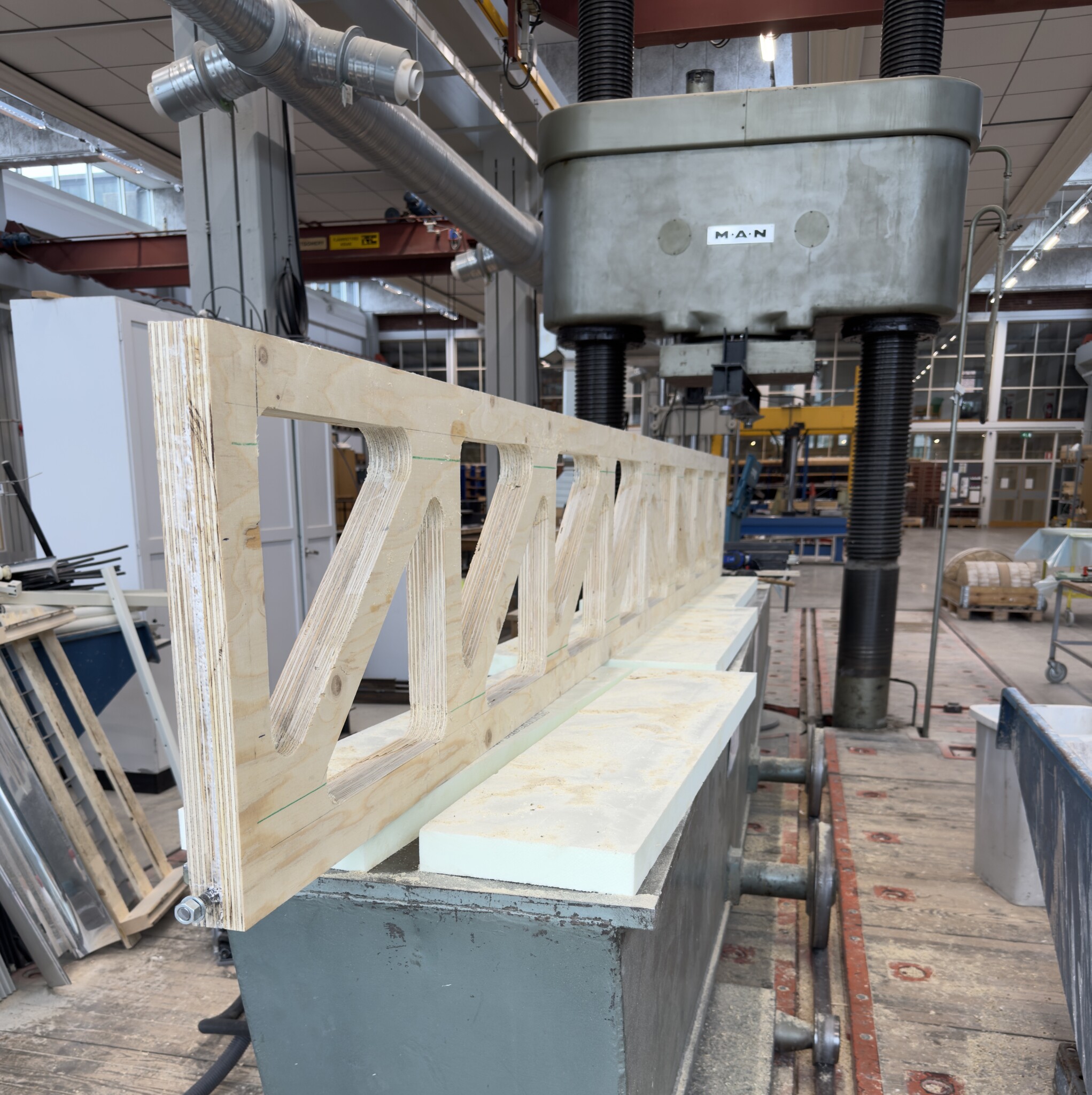

I am now working on a truss beam made of plywood which I prestress with a smooth reinforcing bar at the bottom. This variant will be visible, and therefore the appearance becomes a little more important.

A little Easter DIY. Lightweight consisting of 12 mm k-plywood in the center and then 21 mm k-plywood on either side. The panel is designed to take compression in the struts and at the bottom which takes tension I have a 12 mm steel where I threaded the ends to be able to prestress the beam slightly. Probably a pressure test this spring.Per Lindh said:

Split LVL/kertobalkar I understand that both are more dimensionally stable and durable but it becomes much more expensive than, for example, using 45x70 inside the beam. What do you think about that?
Does it matter if the short studs in the beam are placed inside the long ones or on top for durability? Are there any advantages or disadvantages to how they are placed?
Of course, 45x70 will be cheaper than the corresponding LVL beam. The advantage of LVL is that it is 51 mm and it fits perfectly with gluing 50 mm PIR or XPS. Attaching a picture of the different types.A Anton Olofsson4 said:Hi,

I see. What kind of lvl beam are you splitting? Found any affordable options?Per Lindh said:
I thought that there is a lot of different 45mm insulation if you use studs.
I bought Kertobalk 51x400. When I used C24 timber, I bought 45x95 which I sawed down to 45x71 to make some room for glue. I used PU glue because it glues plastic, wood, metal, etcetera. PU is also enhancing and has a good open time, around 30 min. However, the result depends on good press pressure during curing.A Anton Olofsson4 said:
