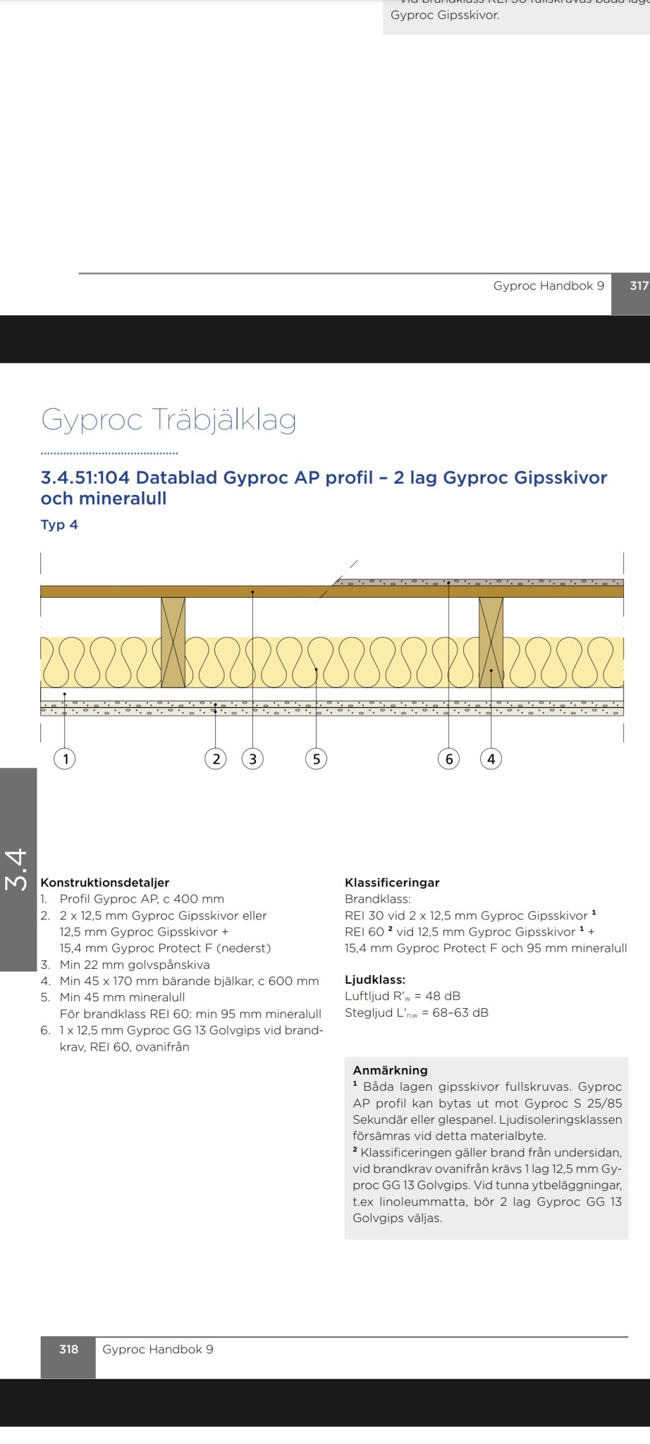

but back to the subject. Shouldn't there be a layer of plasterboard ABOVE the insulation before the floor structure to the neighbor above?
I would guess that the floor structure is built like this example. Quite standard
