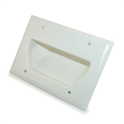

What brand is your cable conduit? I'm building a wall just like you where a heavy TV will be mounted, but I haven't found a good way to route the cables out.

why buy a box when you can build one in plyfa? then you pull 50 mm hose in.!!

why buy a box when you can build one in plyfa? then you pull a 50 mm hose in.!!

I'll buy plates for the input/output of cables, then the wall can be open inside, separated by the studs. It'll be both nice and good.
