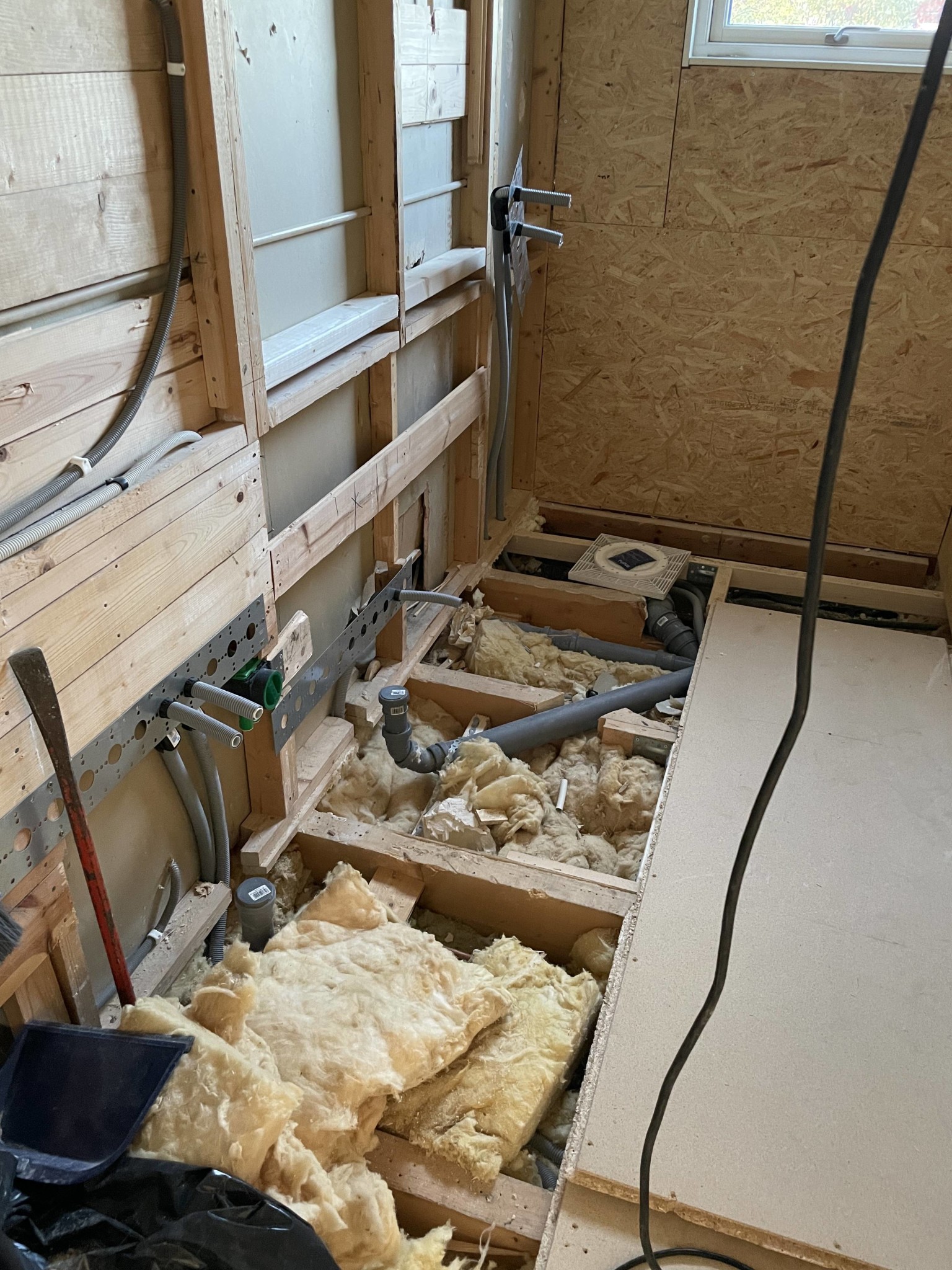

Drain through joist?
think about taking a thick plywood and making a hole in it, through which the pipe is threaded, the board should be at least 120cm long, I would say.. then screw-glue it to the beam, one on each side.Lity said:
you need to create a whole that goes around the pipe.
If they had drilled a hole in the middle of the beam, it would probably have been fine,
the carpenters haven't studied structural engineering and bending resistance, etc.

Screw a hole plate on the top sideH Husärlivet said:Hi!
It's a shame they didn't pull it in the basement. They did it at our place, the only thing I actually asked for, and they bowed and thanked me. But in your case, maybe you can ask them to reinforce the beams on each side by gluing and screwing on new 45x95 studs?? There should be room, one might think!!

Thanks! The room is about 300x130, and to the left over the same flooring is the kitchen (as long as the bathroom, so all the weight is over the same flooring).J Jontha said:As previously mentioned, where the heck is the construction for the well?? It should be reinforced with at least 195 joists.
The holes are really rough. It doesn't seem to be a long distance in the room and they are over the shorter side. You can/should reinforce those joists at the hole by glue-screwing plywood on both sides of the hole. Just saw out the profile for the hole.
Then you're free to reinforce and strengthen the joists.
Thanks!B Boan said:consider that they need to take a thick piece of plywood and make a hole in it, which the pipe is threaded through, the board should be at least 120cm long I would say.. it is then screwed and glued against the joist, one on each side.
you need to get a whole that goes around the pipe.
If they had drilled a hole in the middle of the joist, it would probably have been fine,
the carpenters have not studied structural engineering and bending resistance, etc.,
Here is a picture of the current state in the bathroom. There you can also see how they have framed around the drain in the shower.
Another question. I'm wondering if it's okay that they have cut out for the water pipes as they have in the horizontal beam that runs along the floor on which the wall studs are standing?
The beam by the water pipe to the toilet also looks a bit questionable (but it has probably looked like that even before they started).
When I did my bathroom, I was terrified that the screws for the floor chipboard would go down into the water pipe or drain. Therefore, I had a much larger distance between the top of the beam and the holes for water and drainage.Lity said:
Here is a photo of the current state in the bathroom. There you can also see how they framed for the drain in the shower.
Another question. I'm wondering if it's okay that they have cut for the water pipes as they have done in the horizontal beam that runs along the floor where the wall studs are located?
The beam by the water pipe to the toilet also looks a bit questionable (but it probably looked like that before they started).
Yeah, exactly... There are recommendations for that too. I read 6.5 cm from the top to avoid risking damage to the drains. But it feels like they just winged it and hoped for the best.A alexanderlukas said:
