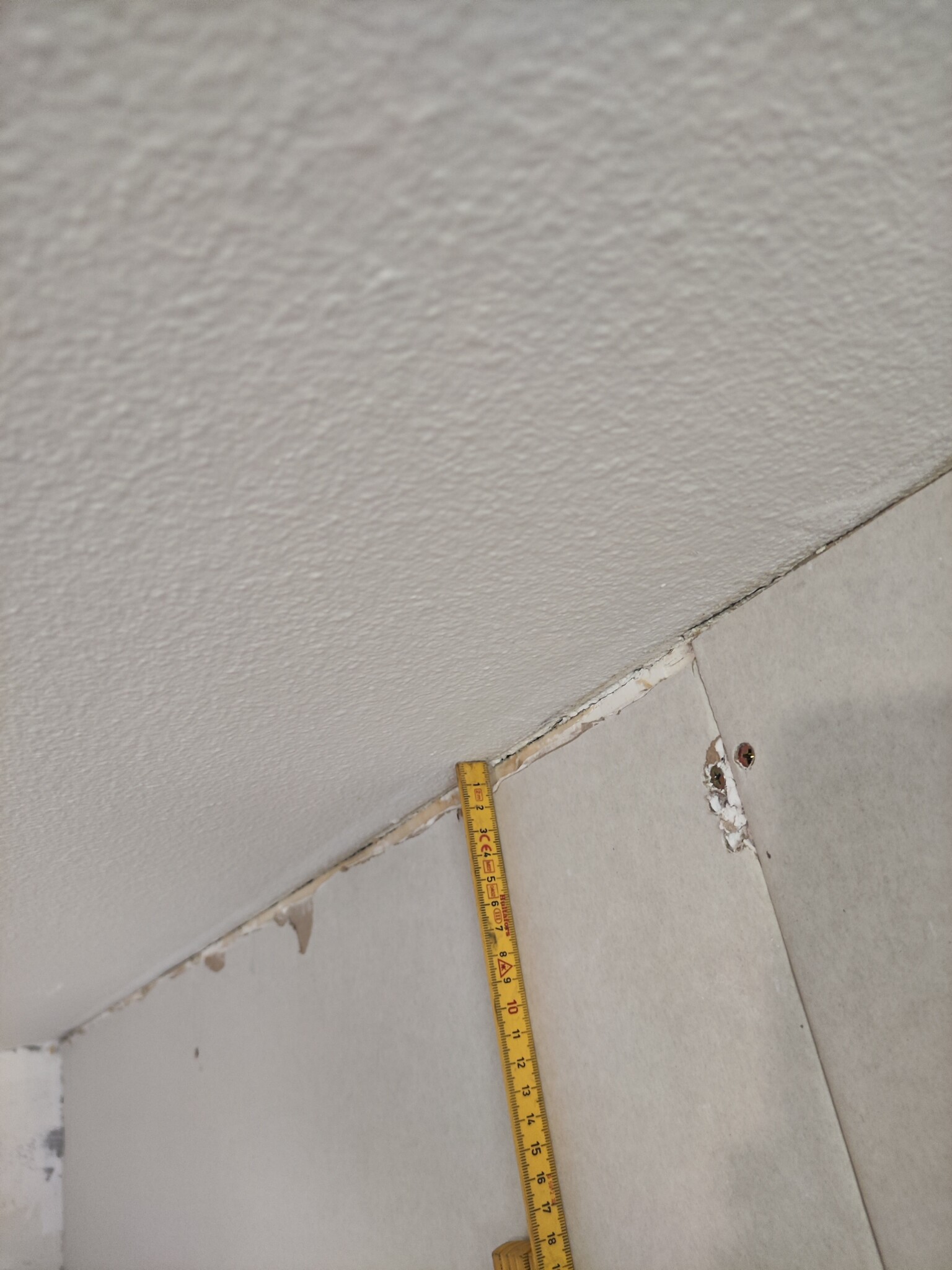

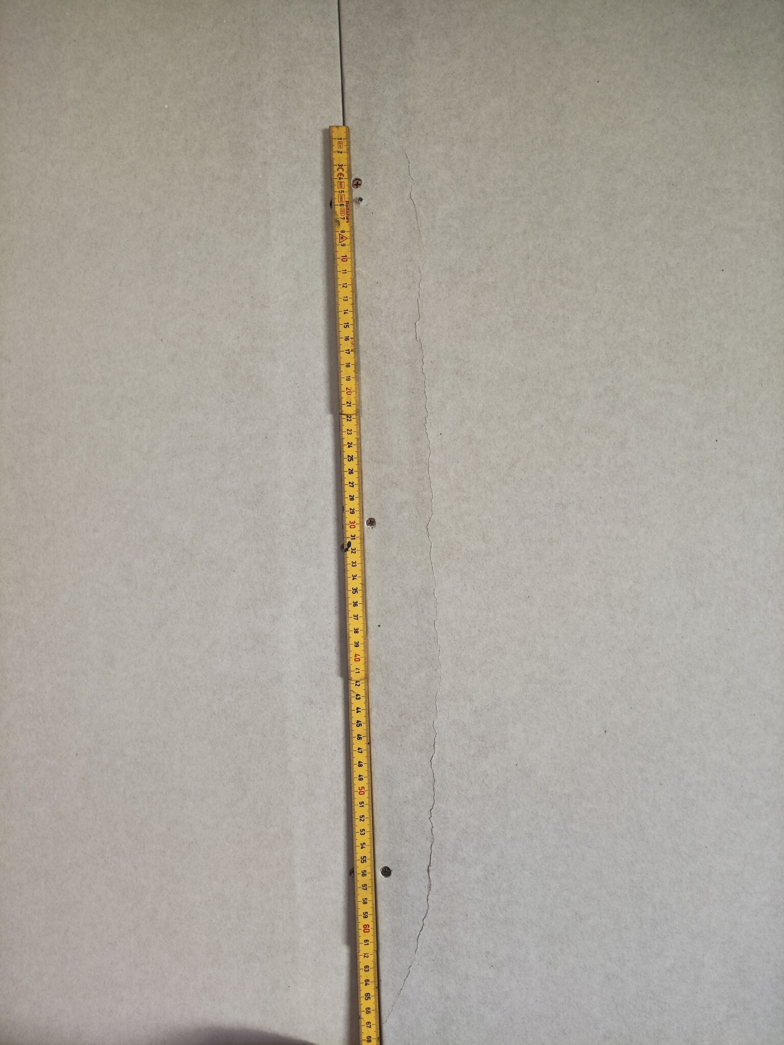

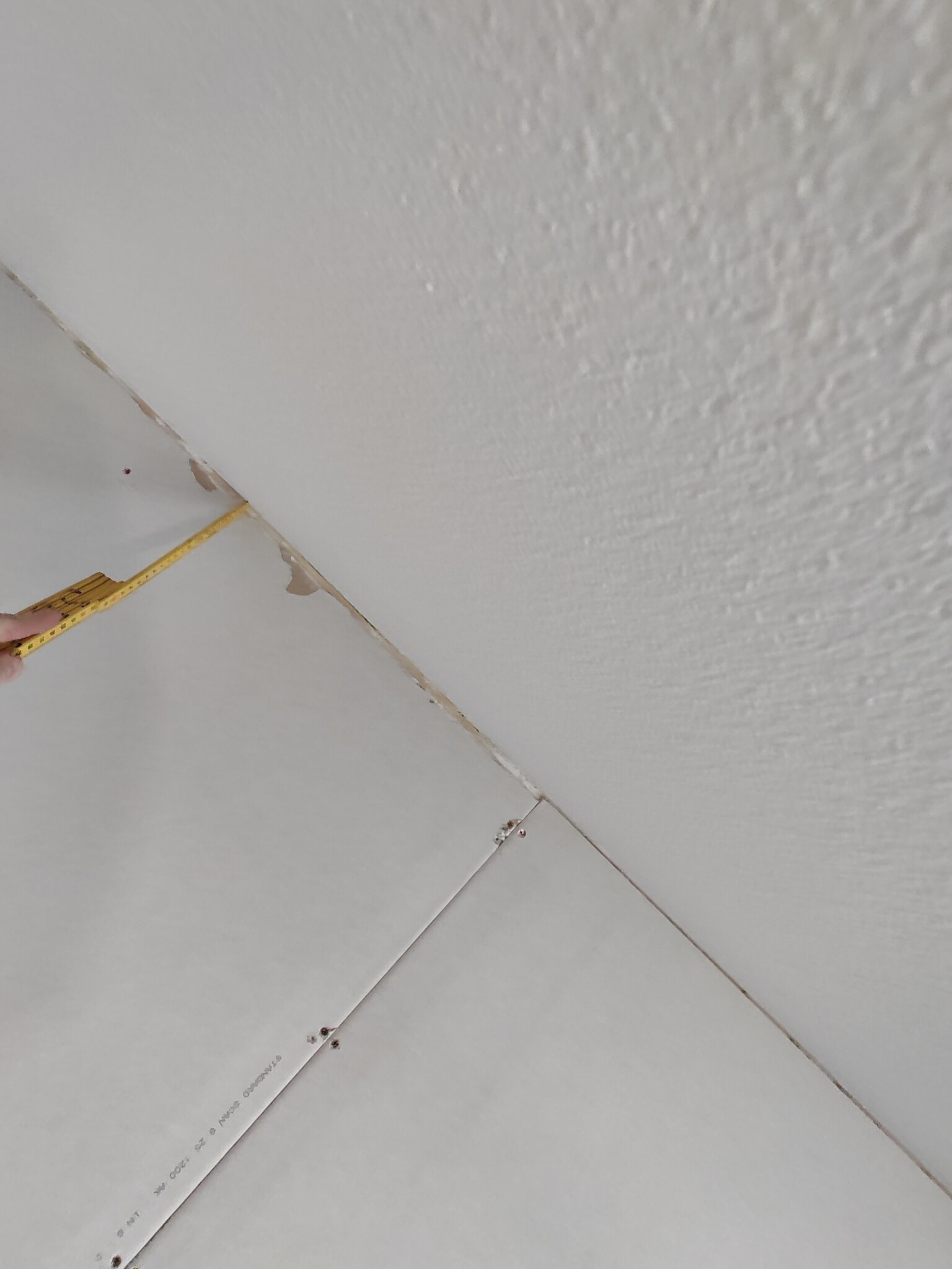

Hi, it's my first time putting up drywall and I used renovation plasterboard 6mm. This will be the first and last time, it's incredibly difficult to work with.

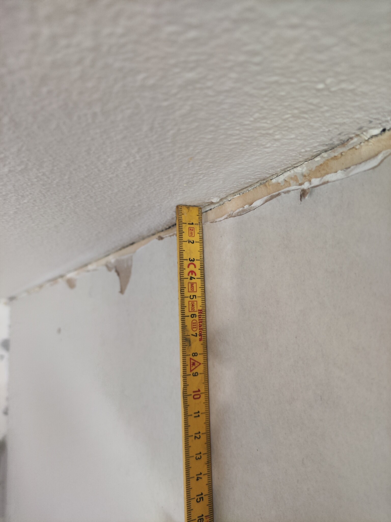

Anyway, I accidentally cut too much on the drywall, it was 2500mm and the exact floor-to-ceiling measure is 2486mm. Can it be left like this and then filled evenly with plaster, or should I just replace it with a new one?

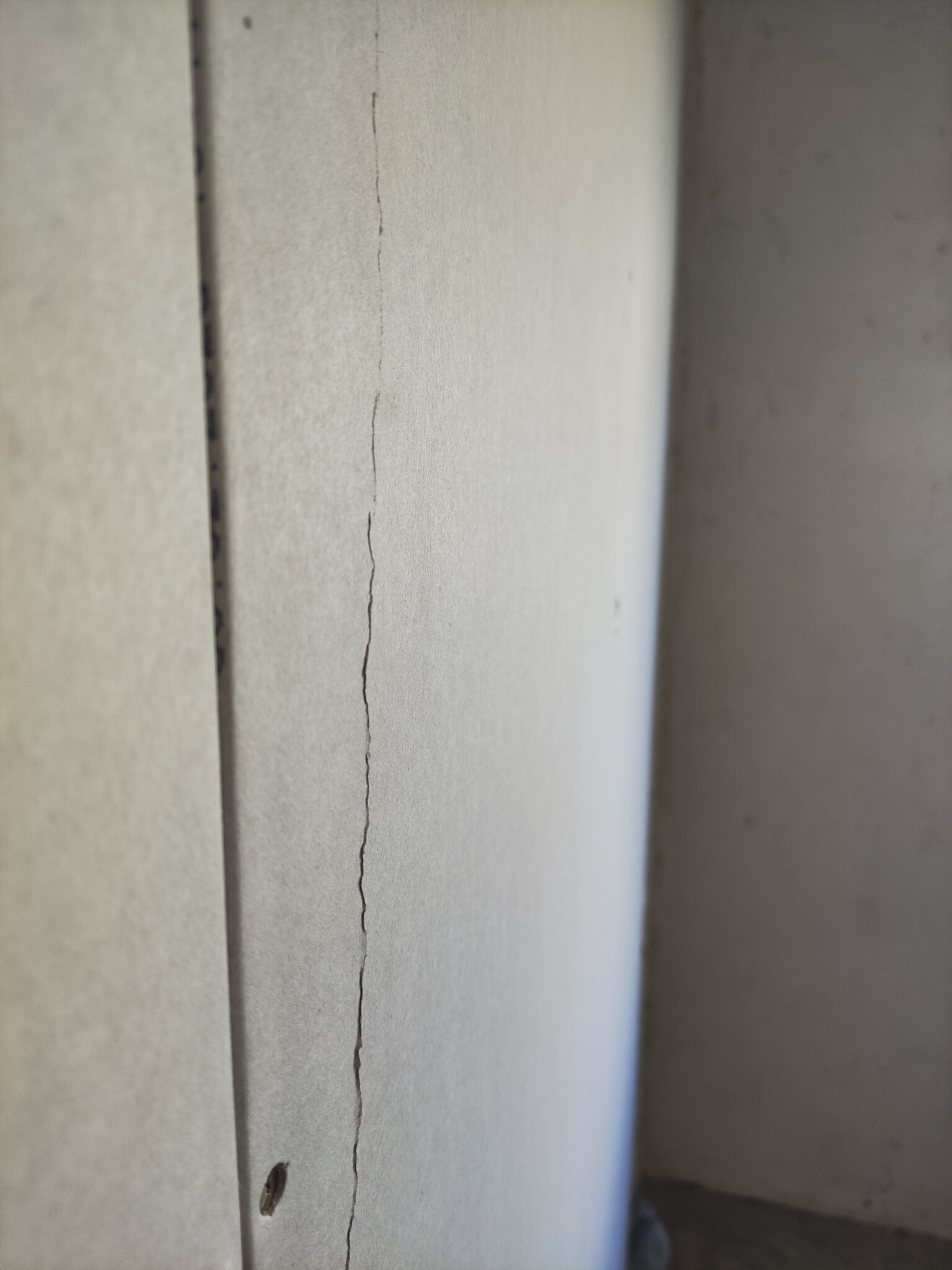

Next question, I got a crack on another sheet, can this somehow be repaired or will it crack again after being plastered, or as said, should it just be replaced?
I can also add that I'm placing the drywall on an existing one that has had 5 layers of wallpaper all the way from the '60s :D

Make sure the drywall is secured on both sides of the crack + spackle, I would say.

Make sure the drywall is attached on both sides of the crack + filler I would say
So put a screw on both sides along the crack??
You're screwing too close to the edge. 6mm doesn't support itself, so it must be solid underneath to avoid problems with screws sticking out or going through the board.

In large gaps, you can fill with plaster. I would screw on both sides of the crack and bevel the edges of the crack and fill with plaster, then lay a paper strip. Then it's just a matter of plastering as usual.

As far as I know, plasterboards should not go all the way up\ndown\in against the floor\ceiling\corners, there should be a certain gap that is then covered with a molding or sealant (e.g., Tec7 if the house moves a lot or painter's caulk if it moves a little).
If the house moves a lot (e.g., wooden frame), the risk is high that the joints between the boards will be visible if they are not handled correctly. Between each plasterboard, there is an involuntary crack\joint that is covered with joint tape, and if done correctly, there will never be a visible crack. In your case, the crack does not run straight and seems to extend both within and outside the recessed area (intended for the tape), which can make it complicated to tape the whole thing.
To be particular, I think the plaster screws are way too close to the edges.
BUT worth noting, I am not a craftsman and have only installed plaster and renovation plaster in a couple of rooms in the house so far.
Edit: Can you link the guide you followed for installing plaster?

Alright, thanks for the answers! This is an apartment, so everything is made of load-bearing walls in such solid concrete. The apartment is on the ground floor, and the wall between the bedrooms is load-bearing, and on the other sides is the entrance to the house with mailboxes, so they just put plasterboard and insulation to dampen, I imagine.
No good answer, but in the pictures you see, you probably have also screwed the screws too far into the board. When I drywalled a room with renovation gypsum and accidentally got the screws in that far, it was clear that the board wasn't fastening properly there. Have you set all the screws to the same depth..?

Yeah, it felt a bit like that on some, no, maybe 20 out of 120 are too far in.
