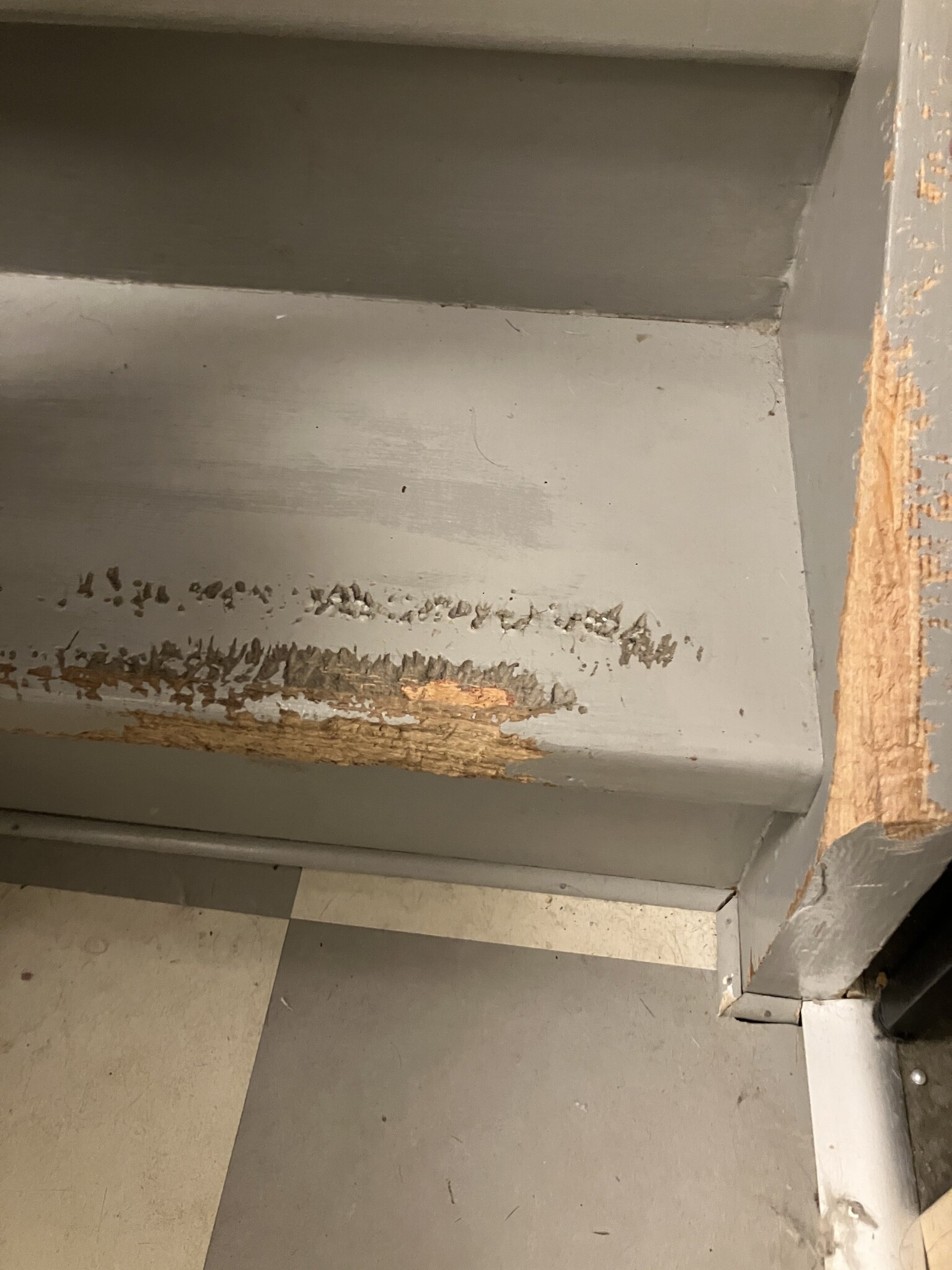

J johanlund77 said:My puppy has scratched up my wooden staircase. I was thinking of repairing it, but what should I use? Regular filler seems weak and chemical

Plastic padding is a great solution for filling wood. Build in several layers and sand with COARSE paper in between. Once you've built it up to the right height, use finer and finer paper.
Plastic padding and kemiskt trä are very similar, but plastic padding is harder and more difficult to get a good finish on. Otherwise, it's like the same product; I've used plastic padding when kemiskt trä hasn't been available in the paint store.J johanlund77 said:
Ok. Maybe I'll go with chemical wood then. The steps seem easier to make look nice than the edge the dog also chewed on. But it's not as sensitive so maybe I can just spackle a bit there.Cheesen said:
Chemical wood, plastic padding, and carpenter's filler are all fillers, just with slightly different durability and hardness.J johanlund77 said:

As for the edge, I actually don't think it will be very noticeable if you just build it up so that the teeth marks don't show since the dog seems to have gnawed "right" gradually outward. Fix the deeper teeth marks and just paint. You will of course know about it, but others probably won't see it unless they're looking for flaws.J johanlund77 said:
Unfortunately, I've never worked with chemical wood, but Plastic Padding and similar 2-component fillers are super easy to work with.J johanlund77 said:
You just have to keep in mind that it also needs to be sanded, so apply a little less with each layer.
Use chemical wood, it should be sufficiently strong. Have worked a bit with https://www.bauhaus.se/traspackel-p...GWdgwXwQnAbm8pQhDZ3W3dgdSUSKyGaxoCnCwQAvD_BwE Works well, dries very fast. Apply in batches as it is heavy and will sink down/sink in.
