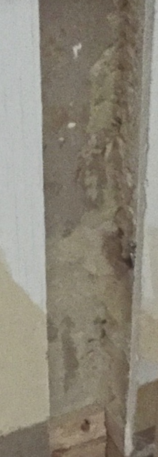

In our energy house from 1981 made by Nordiska Termohus in Jönköping AB, the walls and ceiling are made of something they call Multiblock. There isn't much information about this type of interior wall/ceiling, and they refer in drawings to "See multielements principle details," but I can't find anything like that.
The walls and ceiling have drywall with foam fill (PU?), so it's like a solid block. I can't find studs in them when knocking since everything sounds the same, but there must be some, I assume, or have they been able to skip them because it is a solid wall?
It's a bit tricky when you start running electricity, pipes, etc., as you can't get into the walls without having to mill grooves. Also, attaching heavier things becomes a challenge since you can't use plugs that expand behind the drywall.
Does anyone know more about this type of wall/ceiling?

  • Close-up of a wall cross-section showing internal insulation materials, possibly polyurethane foam, beneath gypsum boards in a 1981 energy-efficient house.
