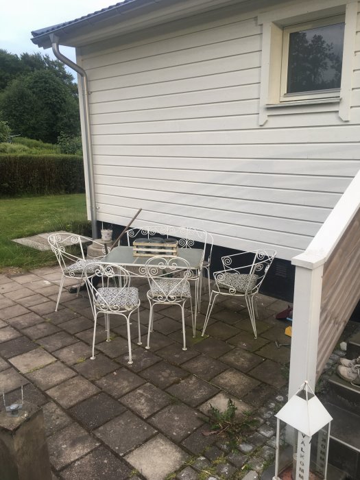

Hello, I'm planning to build a deck at the front. 5x2 m.
I have foundation blocks at home intended for 70x70. Can I build on these, or should I use 90x90?
From a load-bearing perspective, there are no problems.
Do you want help with reasonable pier spacing and dimensions of timber?
Keep in mind that 2 meters is very difficult to furnish.
Going perfectly fine, earlier this year I built a wooden deck on 70x70 posts NTR-A directly on Danish stone slabs.
K
2.5 meters is significantly better. But even 2.2 works well according to our tests :)
2 meters is too cramped :/
The new deck will be 2.8 to easily pass around those who are sitting.
P
We have a 40 sqm terrace at the back :) we'll just have a small café table at the front. Mostly to connect to the entrance steps. If you have bags, you can get in through the door :) okay, so 70x70 posts it will be. 45x170 beam. Those are the measurements I have because the terrace, as mentioned, should be connected to the entrance steps and the basement stairs xD see picture

Aha, then there's no problem. Good luck!
P
Thank you. The following question is whether you need to dig down plinths all the way? It is densely packed gravel for the stone slabs. I don't want to attach to the facade because there is a brick facade behind the wooden facade. Anxious about digging when the foundation wall for the drainage. There is isodrän around the house. Have 500mm plinths :p
K
How high does it need to be above the ground? I have the same question. I have previously always built decks on concrete slabs and think it works well.
P
About 50 cm. If you haven't built with posts, do you know that 70x70 will work?
K
I never wrote that 70x70 will work, it was huggan and ojji. I wrote that 2 meters wide will be good for a cafe table :)
But there shouldn't be any problems with 70x70 even though it will look flimsy.
