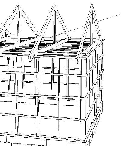

I don't know if there is a rule (I don't think so).
I'm taking a chance anyway on letting the gable overlap the long sides of our garage.
The sketch I've attached of the execution I think I might change a bit. Letting the vertical studs in the gable be longer so they reach up into the gable peak feels like an excellent idea. Then it will be easy to place 45x45s all the way up so that the nail battens and paneling are in the right place ...

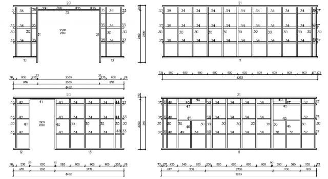

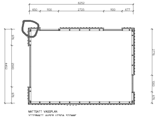

Hello!
I found the page http://www.svenskttra.org/byggbeskrivningar/ which seems to be able to generate drawings.
When looking at a top view drawing, it seems to me like the sides overlap the gables.
When looking at the wall drawings, they seem to have dimensions that overlap.
This puzzled me until I looked at:
http://www.svenskttra.org/byggbeskr...&FileTypeId=103&Doc=broschyr&Cid=1012032&Pid=
Here, they seem to interlock the walls in at least 2 places.
What do you think about this?
Have I interpreted it correctly?
