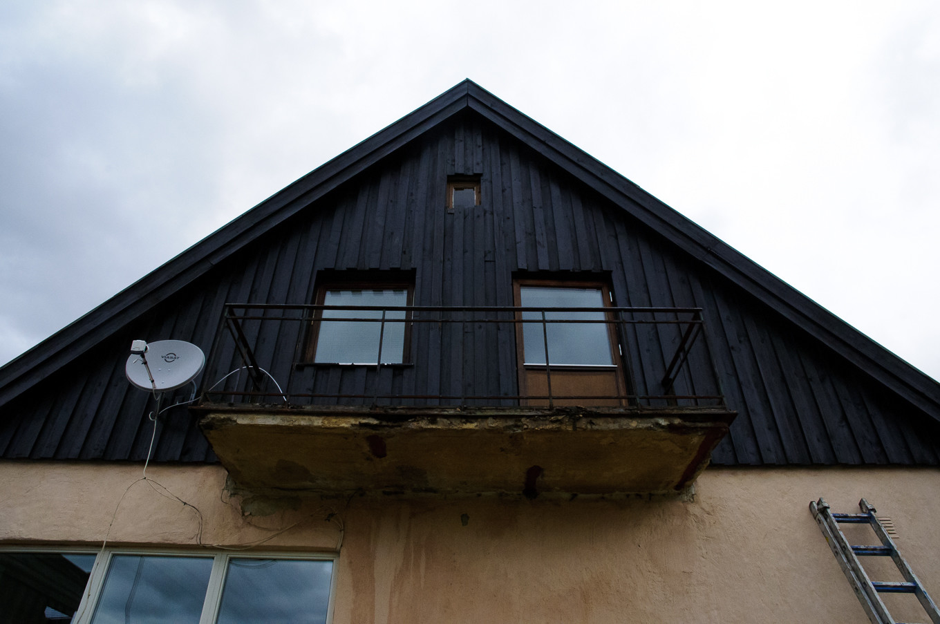

We have removed the dreadful paneling on the balcony of our relatively newly purchased house. The concrete slab was, as expected, corroded. Most neighbors have demolished their balconies and built new ones out of wood on the protruding steel beams.
To maintain the character of the house, we would like to have a concrete balcony. The question is whether we can repair the existing one with the help of special mortar, etc., or if we have to demolish it completely and cast a new one.
I am hereby seeking experiences and advice.

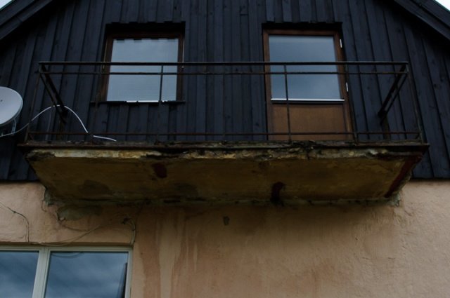

  • Concrete balcony with rusty railing attached to a house; visible underside damage. Users seek advice on repair vs. replacement.
It should be recast.
The concrete is chipped away, supplemented with new reinforcement and recast.
To be on the safe side, the structure emerging from the slab should be inspected to ensure it hasn't lost a significant portion of its load-bearing capacity.

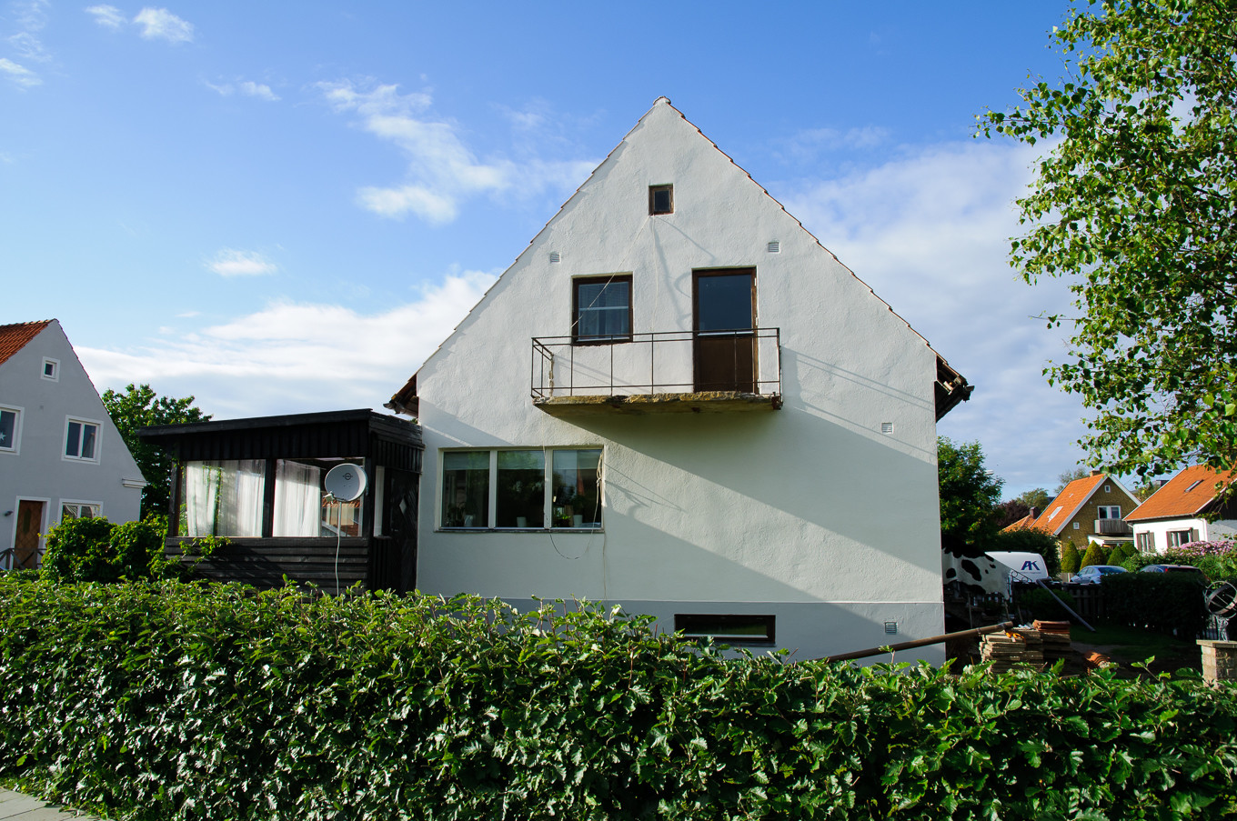

The balcony project has been on hold, but the idea is to tackle it during late spring/summer. I will most likely choose to chisel away the existing slab, even though the middle sections appear to be fresh.
From a weight perspective, it would be nice to make recesses under the balcony, between the I-beams. It's not period-appropriate, but could it be hidden with, for example, recessed wooden slats or something similar to create a slightly more exciting surface?
Another thought that strikes me is, can one place blocks of, for example, cellular plastic or foam glass in the mold and thereby save a couple of hundred kg of concrete? If the slab becomes 12-14 cm it would feel good to save a couple of cm. I would be very grateful for thoughts on this.

Old balcony with railings on a dark wooden house facade, satellite dish, and ladder leaning against the wall. Sky is cloudy. A white house with a small balcony and a wooden extension on the side, surrounded by green hedges.

It should be mentioned that our beams were shown to be in good condition even at the meeting between balcony and wall.
