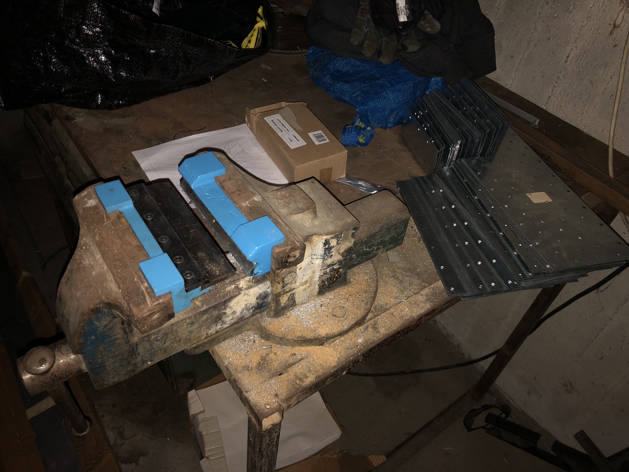

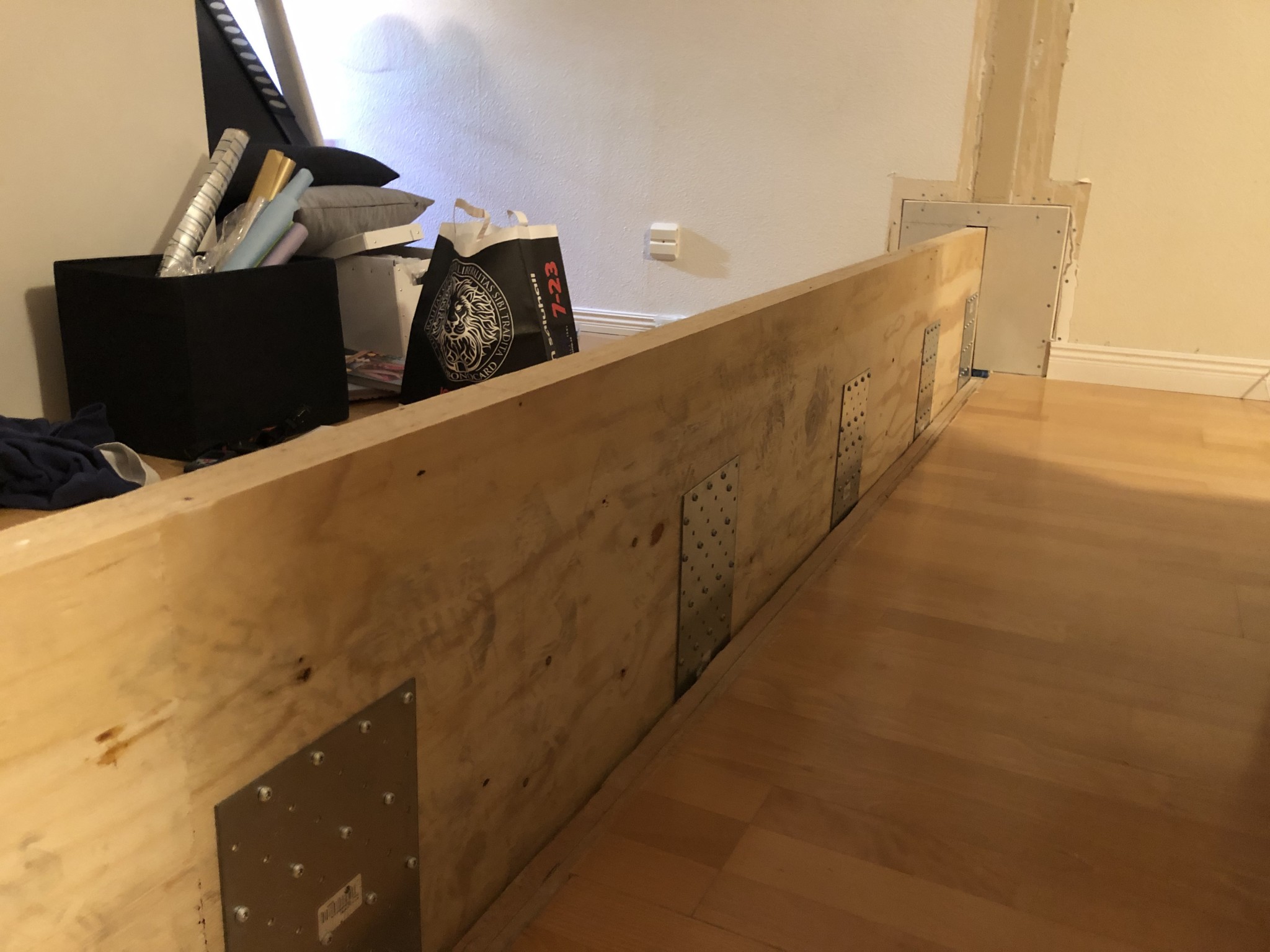

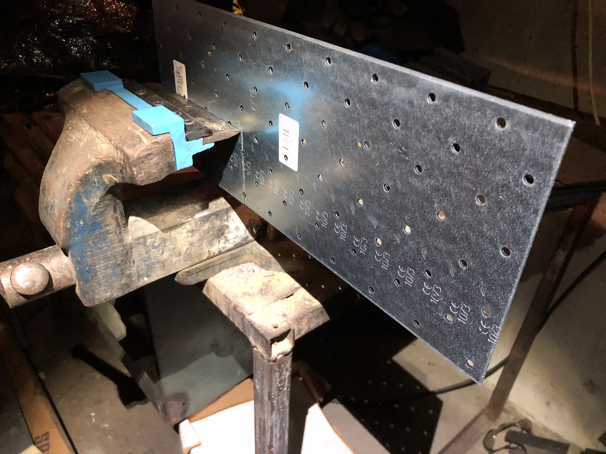

Removed the wall on the floor above temporarily and inserted a 45*415 mm Kerto beam resting on 90*90 columns embedded in the walls below and suspended the intermediate floor from it. Spoke with Moelven and it was a completely okay construction. Rebuilt the wall with 95 studs instead of 70 studs
Demolished the wall on the floor above temporarily and inserted a 45*415 mm glue-laminated beam which rests on 90*90 posts embedded in the walls downstairs, and the beam was suspended from the intermediate floor. Spoke with Moelven and it was an entirely acceptable construction. Rebuilt the wall with 95 studs instead of 70 studs.
[image]
Hi! Did you find any type of metal to fasten the beam to the intermediate floor? Or how did you do it?
I'm considering a similar solution to avoid embedding the beam as I will be building a wall on the upper floor right where the beam will be.
