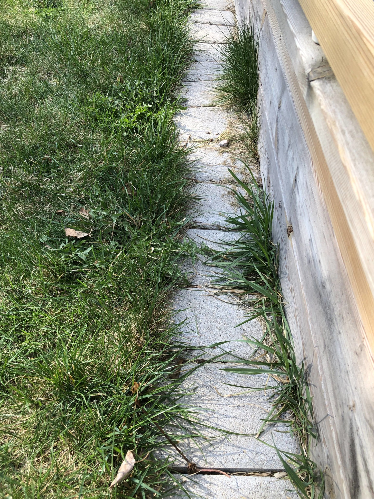

Problem:
Want to create a border between flower bed and lawn. Have tested in one area with
- Landscape fabric
- Stone dust 10cm
- Paving stones
Result: Looks terrible after a couple of years. Grass and weeds everywhere between the stones.

What would become really, really ugly?
The idea is to first cast a channel, somewhat like in the picture below.
Then place paving stones on top of this. With mortar fixed under the stone and carefully in the joint. Only the top will be visible when grass and flower bed are placed against the stone row.
I'm not too fond of the idea of having a visible concrete edge; it probably won't look very nice. And I want a straight line with the same height - but I'm not prepared to spend days on groundwork.
The question is, will it work to mortar the paving stones? I can live with a crack or two over the years.
I am also attaching a picture of the current stone, but the new solution is intended to be placed directly between the lawn and a flower bed (not a planter box).
Concrete is concrete, I think. Going through the trouble of making a mold and then pouring concrete on top seems unnecessary. Instead, dig out, lay a base layer, compact it, and then set concrete pavers in the same dimension as large cobblestones in the damp concrete. Or even better, real large cobblestones, which are stylish and never lose their appearance or value, unlike paving stones, which quickly become dull. Or make your mold out of a simpler material than treated wood, cast and press in shells, broken fine china, and pebbles as decoration, at least that would be a bit original in our time. Think mosaic.
If you're going to have paving stones, choose one that looks nice for at least the first few years and not a cheap, gray, and dull one.
