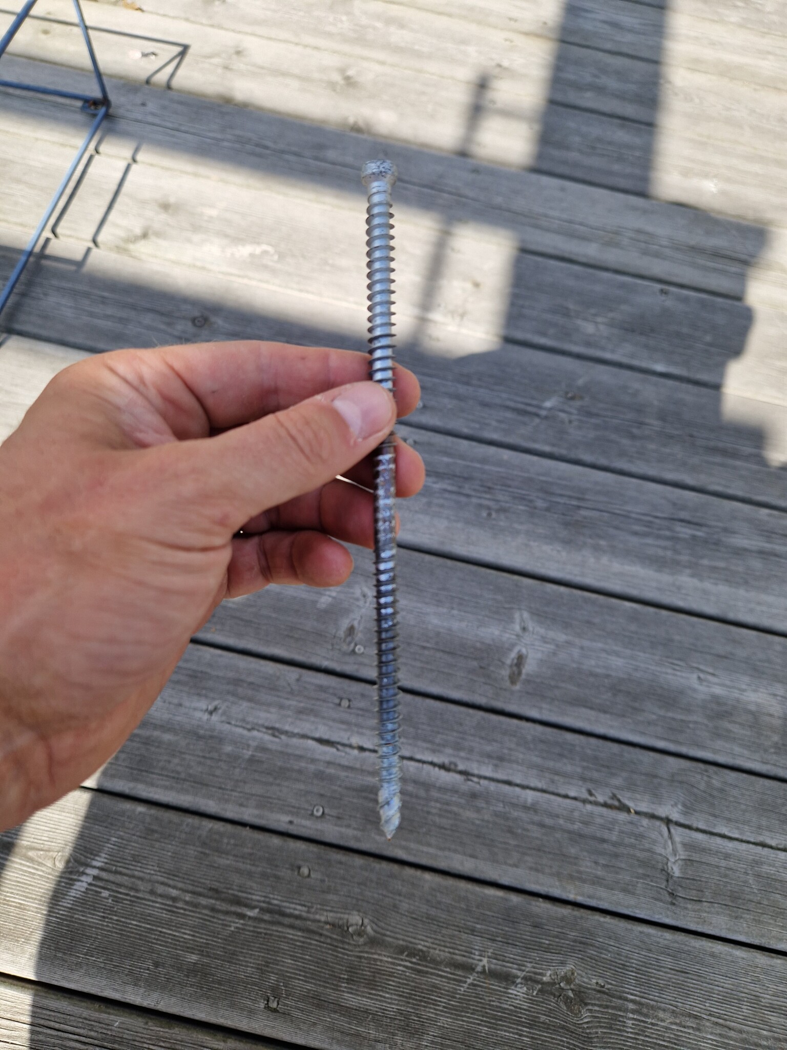

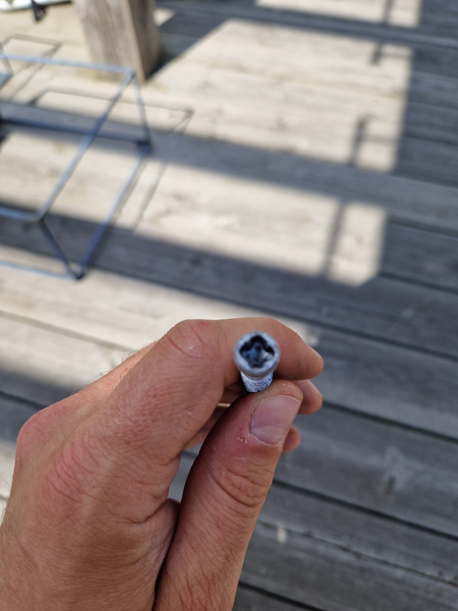

Johan nöjd #1 Member · 6 posts 29 Jul 2025 at 2:56 PM Johan nöjd Member 6 posts 29 Jul 2025 at 2:56 PM #1 Anyone know how to remove these? I have an entire pergola built with them and can't find a good way to get them out. They look a bit like a four-leaf clover. The ones that were a bit looser I've managed to get out with a regular Phillips bit.

H Henrik 75 #2 Member · 243 posts 29 Jul 2025 at 3:04 PM Henrik 75 Member 243 posts 29 Jul 2025 at 3:04 PM #2 https://wiha.com/se/sv/kunskap/skruvprofiler/#aussen4k I think you'll find it here. I have such ones at home but I don't remember what it says on them.

Matti_75 #3 Construction veteran · Örebro · 5 221 posts 29 Jul 2025 at 7:56 PM Matti_75 Construction veteran Örebro 5,221 posts 29 Jul 2025 at 7:56 PM #3 It is a Pondusskruv from Ejot & Avdel and they have their own bits. Check with someone who sells such screws if you can buy such a bit.

S Stefan1972 #4 Member · Västernorrland · 12 073 posts 30 Jul 2025 at 9:50 AM Stefan1972 Member Västernorrland 12,073 posts 30 Jul 2025 at 9:50 AM #4 otherwise it looks like a "regular" square bit should work. It does depend on the dimension though if it will be tight enough.

T Tjrex #5 Stick-builder · 423 posts 30 Jul 2025 at 3:14 PM Tjrex Stick-builder 423 posts 30 Jul 2025 at 3:14 PM #5 The correct bits are called KA3. Newer pondusar have regular torx though.
