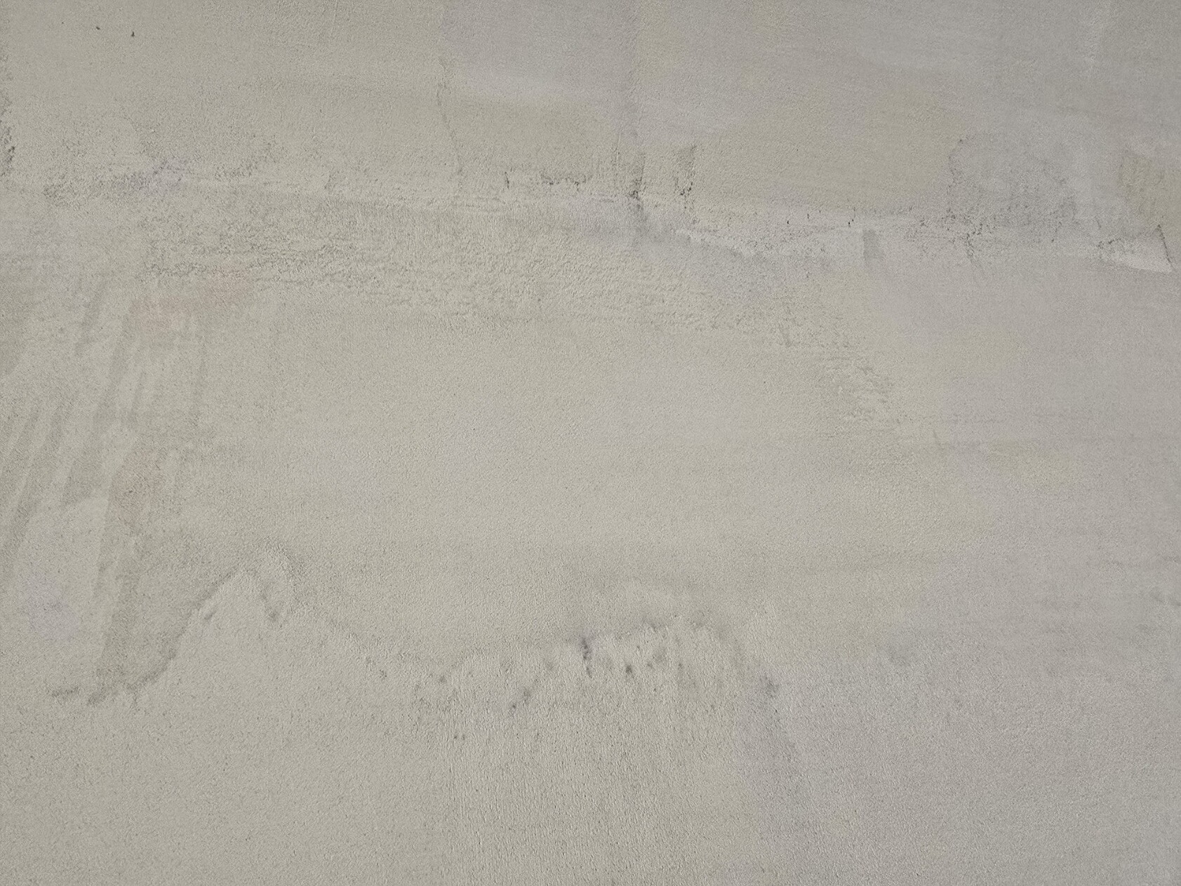

Here is a picture of an overworked surface with many irregularities:
Close-up image of a microcement wall with visible uneven textures and patches, showcasing the challenges of achieving a smooth finish.
On smaller surfaces, like under the bench in the steam sauna where it's about 45 cm high it goes quite well, but when you get to a larger wall it's impossible to get a completely smooth surface, there will be "stripes" and "mottling" on the surface.
Here was probably also one of my problems that I wanted as homogeneous and smooth a surface as possible and didn't want "irregularities."
If you want it completely smooth and even, microcement is not the right choice of product!
There will be a certain degree of mottling and irregularities in the surface, that's just the way it is... The daughters are thrilled and want more irregularities since they have the vision of a bit of Moroccan bathhouse (and not one of those fancy ones in mosaic tiles, but a rustic and dilapidated one).

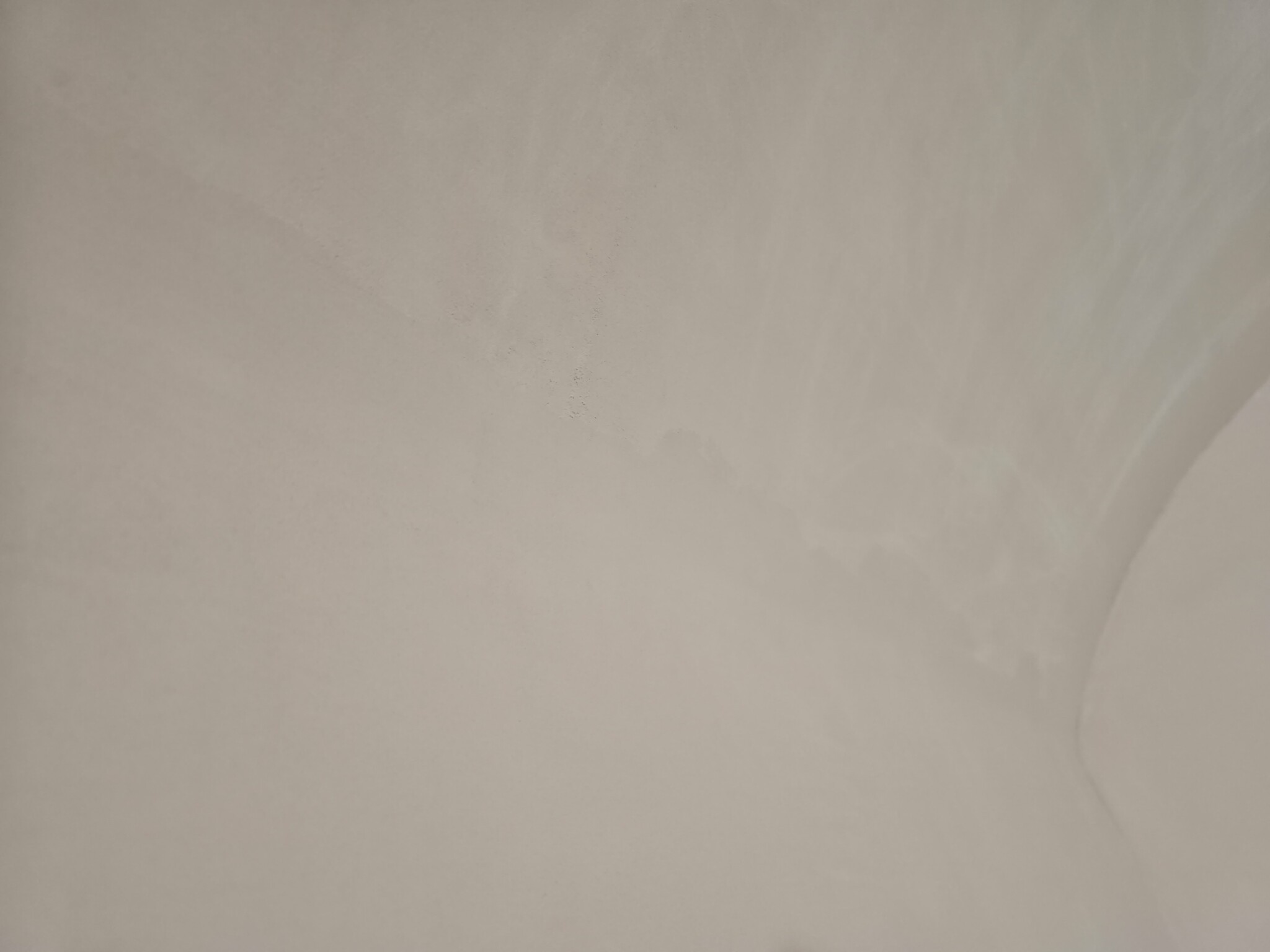

Here is what I now find acceptable:
Uneven microcement wall texture showing application challenges with visible streaks and blotches in a bathroom renovation project.
However, I cannot recommend Konkral's diamond grinding discs, they don't work very well, honestly, and are very expensive.!
After the first layer, I think it works best with an orbital sander (125mm) and 80 grit paper of good quality where you have to be fairly light-handed but can go on for quite a while and get it "even" and smooth.
After the second layer, I have now only used hand sanding with 120 and 180 grit paper. First the biggest ridges and irregularities with 120, and then lightly over the whole wall with 180.
Now, of course, the final result will not reveal itself until I apply the sealer, so you'll have to wait for those pictures...

Here's a picture of an overworked surface with a lot of unevenness:
[image]
On smaller surfaces, like under the bench in the steam room where it's about 45 cm high, it goes fairly well, but when it comes to a larger wall, it's impossible to get a completely smooth surface; there will be "streaks" and "blotches" in the surface. This was probably also one of my problems, wanting a completely homogeneous and smooth surface and not wanting "unevenness".
If you want it completely smooth and even, microcement is not the right choice!
There will be some blotchiness and unevenness in the surface, that's just the way it is... My daughters are thrilled and want more unevenness as they have the vision of a slightly Moroccan bathhouse (and not something fancy in mosaic tiles, but a rustic and somewhat dilapidated one).
[image]
Regardless, I can't recommend Konkrals diamond sanding discs; they work rather poorly, to be honest, and are very expensive.!
After the first layer, I think it works best with a random orbital sander (125mm) and 80 grit paper of good quality where you have to be quite gentle but can work for quite a while to get it "even" and smooth. After the second layer, I've only used hand sanding with 120 and 180 grit paper. First, the biggest ridges and unevenness with 120, and then lightly over the whole wall with 180.
Now, the final result won't be revealed until I apply the sealer, so you'll have to wait for those pictures...
