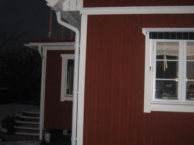

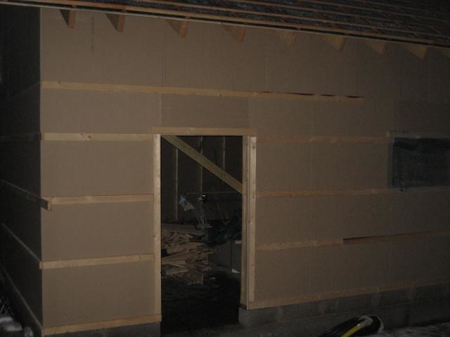

I'm nailing on batten (28x70mm) for the garage build, but I've come across some questions...
The garage should have the same style as the house, meaning with white 22x120 for parts of the ground floor and the upper floor, and also a 22x120 sitting directly under the eaves, which should be crafted 'straight' and have lights mounted in it.
But how do I best place the batten to attach the panel so the appearance matches the house?
The boundary between the ground floor and upper floor is right at the upper batten on the garage picture, so there aren't huge distances to panel directly.

isn't it just the "täcklocken" that are cut off? because the panel is intact underneath as it looks like in the picture, so then just run cc60 on all battens,
then you nail the white board into the panel.

It doesn't look like you have the same trusses on the house as on the garage. On the house, you have eave boxes which automatically give you the height of the "lockstöten" (which I call the horizontal 120).
On the garage, the trusses slope downwards, so you need to brace them up so you can nail eave boxes there too. That's what then determines the placement of the "lockstöten."

You see correctly, the cover battens are cut and go up against the horizontal white, and continue above it on the upper floor.
The question is when/if you need to splice the paneling, on the gables for example, if a nailing batten under the white is enough?
And if I just go with cc60 until I hit the eaves, I'm wondering if it's enough to have, say, a nailing batten in the middle at 40cm, to attach the cover battens, that is, above the top batten on the right of the picture and the one that will be just below the eaves?
If I remember correctly from the TV couch, the length of the cover battens above the white is about 22cm, should I place a batten right underneath them, or would it be okay to nail them at the edge of the paneling?
Maybe it's good to start with this, and then nail a nailing batten up to it, then nail the lock joint outside the panel.
One of the reasons for my pondering is that I read somewhere that panel and cover batten mustn't be nailed so or so close to the end due to the risk of cracks..?
