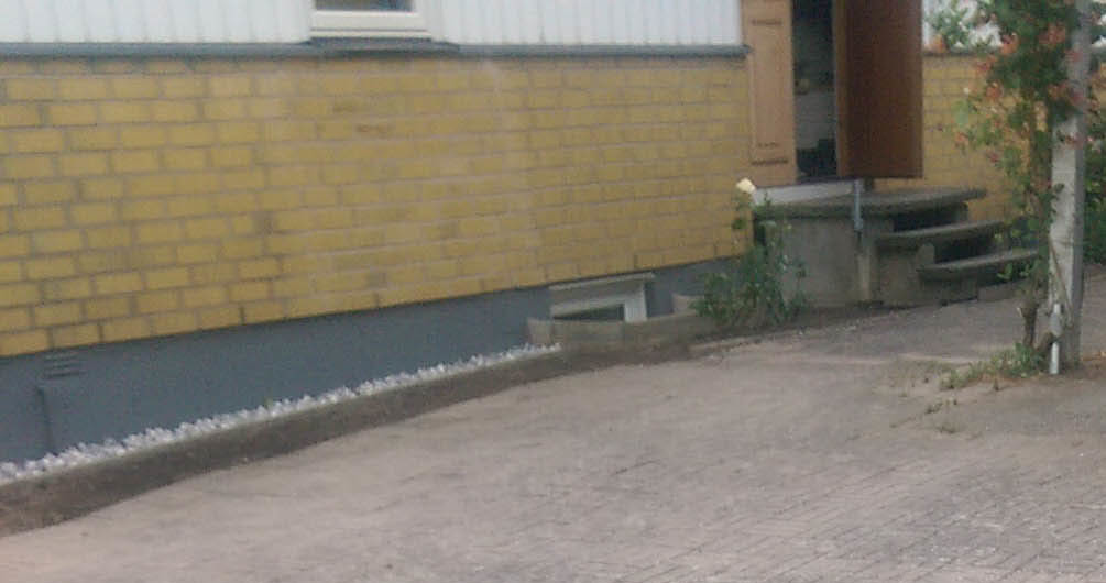

Need to install a new underflashing between the outer panel and a brick underneath. I was thinking of buying a single piece of underflashing, but at the hardware stores, they have lengths of a maximum of 2m. Is it possible to buy longer than that or do you have to splice?
Exterior view of a yellow brick wall with a white panel facade above and a door leading to concrete steps. Small plants and a paved path are visible.
Since you probably can't buy (and transport home) lengths that cover the entire wall,
2 meters is probably okay? One or two joints don't really bother.
You can go to a sheet metal workshop, and they will bend an underbleck in longer lengths (depending on how large their machines are). But it's not free; I had one made that was about 2.6 m and it cost over 500 kr!
B b8q said:
But it's not free, I had one made that was about 2.6 m and it cost just over 500 SEK!
It's a penalty fee because it's in Stockholm. In the countryside, you can get one in copper for 100 bucks to the coffee fund.
