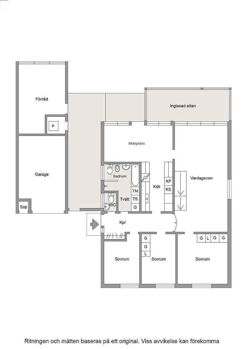

Hello! I want to demolish a wall between the living room and the kitchen. The total measurement is 8 meters.
The house is a 1.5-story house. Gable roof with tiles.
My idea is to build supports/posts at each end.
I can also insert construction drawings. Snow load zone 2.
The length of the beam will be 8 meters, which I know is very long, and will require a substantial beam. I really want to know if it's even possible to do it without having a pillar in the middle of the beam, and if so, what dimensions of the beam I need.
I hope someone can help me get an idea 😊
  • Floor plan of a 1.5-storey house showing the layout of rooms including kitchen, living room, dining area, and enclosed veranda, with specific measurements.

Is the wall between the living room and kitchen load-bearing?
BirgitS
Have you considered moving the stairs?
Because now there is a high risk that the stairs are hanging on that wall.
Hire a structural engineer who can discuss different options with you on site.
Hello and thank you!
Yes, it is load-bearing!

Have you thought about moving the staircase?
Because now there's a big risk that the staircase is attached to that wall.
Yes, that staircase will be removed and replaced with a spiral staircase in a different location.
