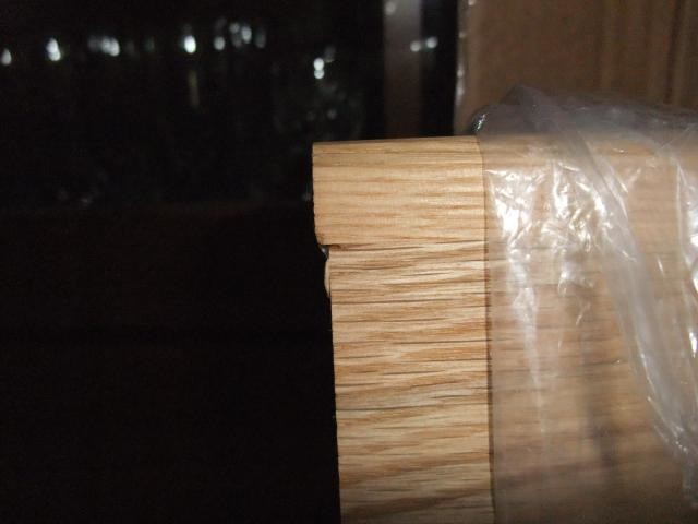

Hmm... saw that the nose was about 1-1.5 mm shorter than the tread surface at one step. What do you think is best, to try to sand down the excess along the entire edge or place the compass a bit in so that you have to saw off the step at both ends?
I personally think it would be best to saw at both ends but I'm unsure. How would you have done it?
I don't quite understand what you mean. Are you talking about the existing step in the staircase? A picture would have been perfect.scar69 said:Hmm... saw that on one step the nose was about 1-1.5 mm shorter than the tread. What do you think is best, to try to sand down the excess along the entire edge or place the compass a bit in so that you cut off the step at both ends?
I myself think it would be best to cut at both ends but am unsure. How would you have done it?![]()
No, I mean the stepkit step. The stair nose on a step is about 1mm longer than the actual surface you step on. They apparently were a bit careless in manufacturing
Attached is an image of the actual problem.
My question was whether you had placed the compass so that you had to saw the step at both ends due to the manufacturing error, or if you had tried to sand down the problem so that the edge was straight and nice from the start?
Then I'm following along. I would definitely have placed the compass to ensure cutting on both ends, that yields the best results. Additionally, you will soon notice that many steps are not exactly 90° against the stringer, which means cutting on both ends will be necessary anyway.
By the way, it looked sloppy from the Step-kit, I haven't noticed that before. Check to make sure the step looks nice otherwise, without blemishes etc.
Mmm... probably need to cut at both ends, might as well do it sooner or later. But it would have been nice to avoid it on certain steps.
The step in question is to be claimed as the stair nose was full of dents. It was also full of splinters and should have been stopped at quality control.

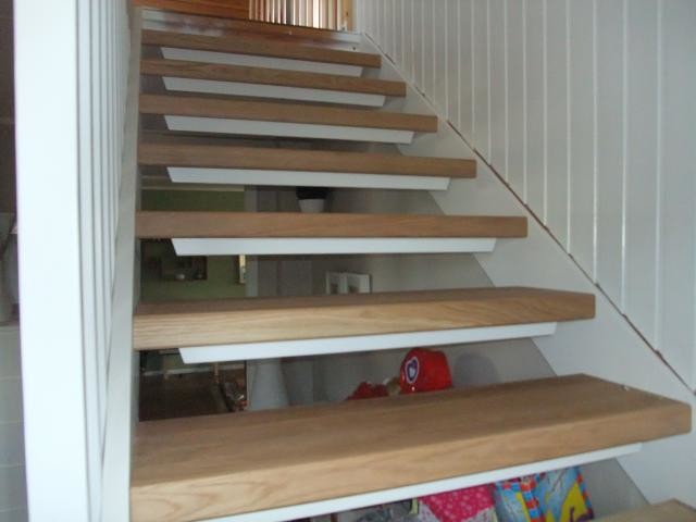

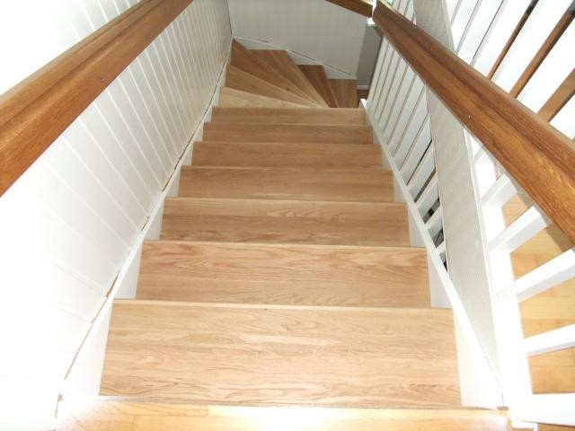

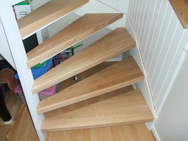

Here are some pictures. As mentioned, one more step will be installed shortly. Also, the skirting will start being installed tonight.
Finally, a small white trim will be put up on the stringer to fit tightly against the paneling
Originally, it was a pine staircase with carpeted steps. The staircase was spray-painted in Nov/Dec and the steps were put in place now
