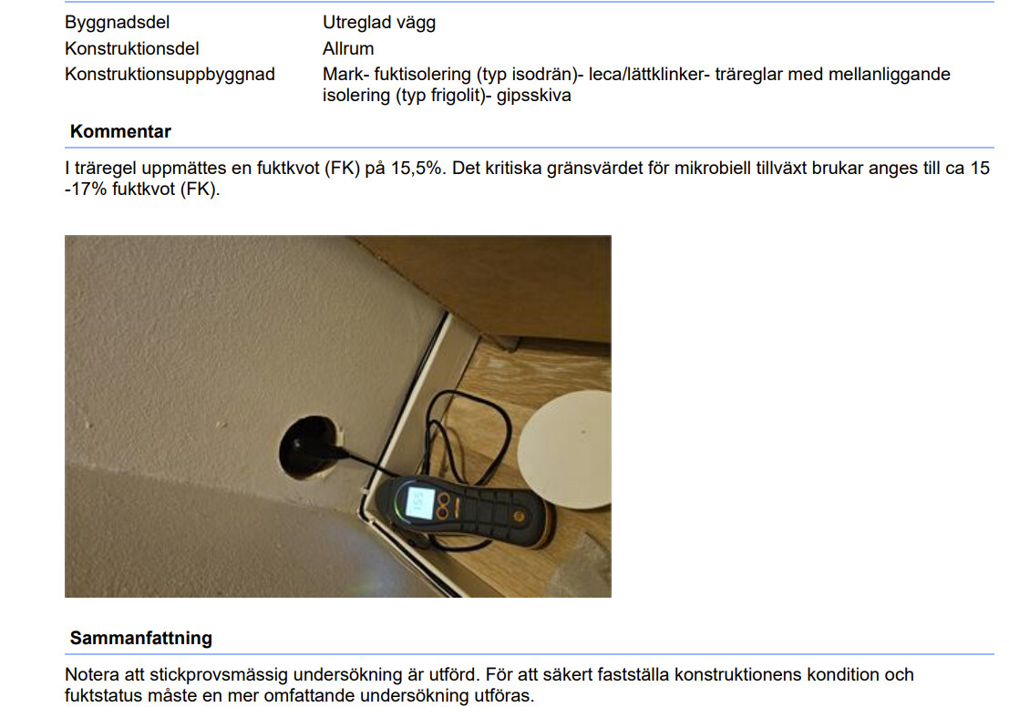

See image below. How critical is a moisture content of 15.5% in basement walls? The spaces are used as bedrooms. Is the risk value on the borderline? Does it need to be addressed immediately? Since the house was built in 2006 and is 18 years old, is there a construction defect in the house? Usually, such moisture problems appear in older house constructions. Approximately how much can it cost to fix in a 100 sqm area?
  • A moisture meter showing 15.5% is inserted into a test hole in a wall next to a wooden floor, assessing dampness in a construction project.

That is a sample that shows a value just above the threshold set for "increased risk."
Are there other indications of moisture?
Otherwise, I wouldn't be worried about it as such.
Addressing moisture can range from a couple of weekends' work + materials for rebuilding the basement and ensuring it is framed with inorganic material, as well as potentially checking drainage on the outside. It's a bit strange that the basement is used as living space in a house from 2006, which is usually advised against. On the other hand, the drainage should be okay if done correctly.
But such a measurement is, as mentioned, just a tiny piece of the puzzle: If you want to be more certain, you should have someone inspect specifically regarding moisture problems.
If it's only that measurement indicating some moisture problem, I wouldn't worry, but keep an eye (as always) after the house is purchased.

Thanks for the answer. No other indications. The house is quite fresh otherwise (built in 2006). The basement has a ceiling height of 2.6m. But how much can it cost to replace walls with inorganic material? Can it be used as living space afterward?

As mentioned, an elevated moisture level is not dangerous in itself, BUT it can cause mold growth in the construction if it is made with organic materials (like wood or gypsum with paper)
There are various systems, you have to look around a bit here on the forum, for example, nivell, or platon mat (if the floor is a problem). Walls are usually framed with metal studs instead of wood, and possibly with a platon mat or other ventilation space against the wall. The exact cost needs to be quoted unless you do it yourself. Material costs shouldn't be too many tens of thousands, depending on the size and other factors, of course.

It is unlikely that anything will happen below 18%, and if it is below 16%, it is pretty safe..

replace external walls with inorganic material so that microbial growth is avoided. there are deficiencies in the inspection report regarding wall design. see image above.

You do as you wish, but at 15.5%, no microbial growth or rot occurs on wood...

I would never fix a wall just because a spot measurement showed 15.5%!
It's a matter of dealing with an unusual odor, visible moisture, experiencing symptoms like a runny nose, or similar.
That wall can stay at 15.5% or higher for decades without problems...or there are already problems: The inspector is just pointing out that it is at a level that "can" mean microbial growth - it doesn’t necessarily mean that something like that is happening.
