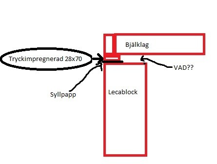

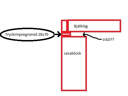

Fill space between lecabase and joists with what?
I am in the process of converting my crawl space into a basement and I am now considering one last thing (probably not the last...)
The joists and sill plate rest on a piece of pressure-treated wood that sits on the edge of the concrete block wall. But what is the best way to fill the space inside this? Just a strip of insulation or should I use spray foam?
See the attached image that might better show what I mean.
Do not know why they put a pressure-treated board between the syllpapp and the joist layer, I guess they wanted to provide extra protection against moisture migration from the lecablocks...
I would be careful about inserting anything that destroys the moisture migration protection between leca and the joist layer.
/ATW
/ATW
But a little mineral wool or EPS foam should be possible to insert there, right? Both are diffusion-open and absorb water capillarily to a very marginal extent. Moreover, there should never be free water there that can be absorbed capillarily, and if so, then you probably have a problem that needs urgent fixing.

Nothing is broken or wrong, so you don't need to do anything.
But if you do want something there:
EPS-cellplast.
Syllpapp and an extra board.
What does the trossbotten look like, because there will probably be gaps when you add support for it?

Nothing is needed there, right?
I have a similar construction.
Leca, sill paper, sill, joist. The cavity is filled with insulation. Feels dry and good, but it might differ from other environments.
Never used plastic because it's a basement part.. Right or wrong, I don't know.
You mean the inside of the basement walls then?D09 said:
It might have been a correct decision. Outside the wall is below ground, where it is usually assumed to be 100% RH, as there is an "unlimited" supply of water.
So plastic on the inside would mean it could be 100% RH right behind the plastic as well. Then it might be better for the moisture to be able to migrate into the basement instead and be ventilated out.

I'm not 100% sure, but if it were my basement, I would skip the plastic.
And many have testified to how bad it gets with basement walls painted with a "dense" acrylic paint, instead of a diffusion-open silicate paint. The paint flakes off.
And it's usually advised to only apply a waterproof layer in the shower corner itself and not on other walls or the floor when decorating a basement bathroom.

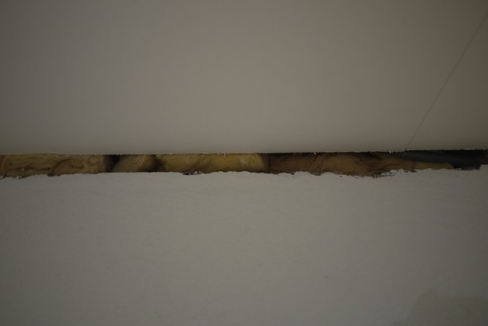

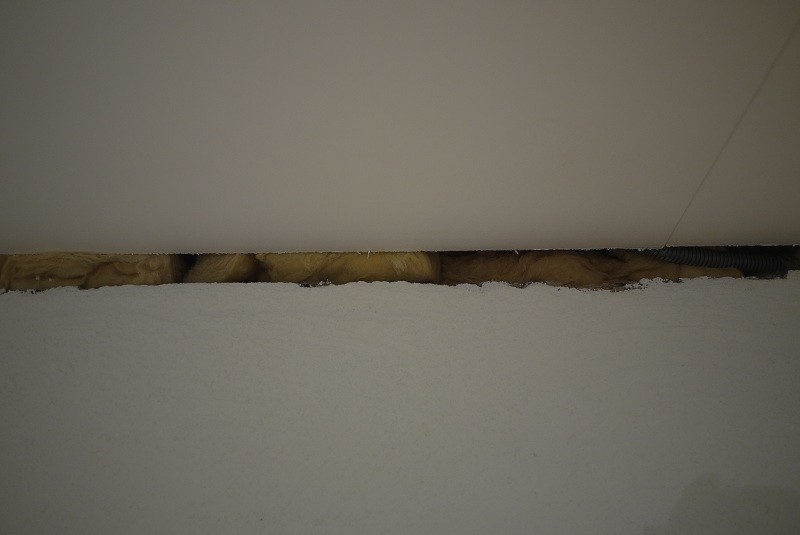

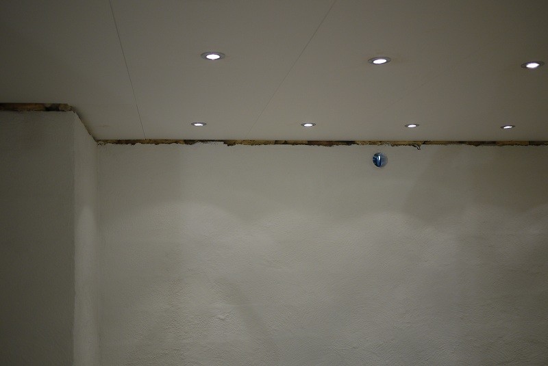

No, nothing is wrong at all. BUT as mentioned, I will furnish the basement and it's a bit drafty there.Workingclasshero said:
Here's how it looks today. I've put in some fiberglass insulation there now to prevent drafts, but I thought I'd check here if there are any opinions on that before I nail a ceiling molding in place. It's easy to switch to mineral wool. Cellplast will be difficult to make "tight," I guess?
A bit closer.
