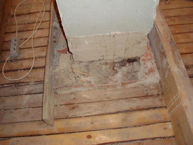

Borrowing the thread and asking:
Why has it been done like this (see image)?
It looks like half of the brick is embedded and the other half sticks out.
Can we use an angle grinder on the bricks that are sticking out
so that the entire chimney is even all the way
or is there a risk that it will collapse?
  • Half of a brick is embedded in a chimney with the other half protruding, set against a wooden floor. A power strip is visible on the left.
I am not an expert in the field, but isn't it a bracket to keep the wooden beams away from the chimney wall? You should probably not remove it without discussing with the chimney sweep first.
Our chimney sweep approved the wooden studs against the chimney (and sawdust against the chimney in the attic) after we installed the hose, but it is probably up to each chimney sweep to decide.
Regarding the image above, that projection is called a "utkragning," something that was done in the past. This was done to be able to lay wooden beams flush, but this method is no longer recommended (stopped being used in the 60s) as these ledges can crack and break the chimney at the floors. I would probably aim to remove them and have a ventilated space instead (much, much better). Just make sure to plaster and restore the chimney after the intervention. Good luck!
