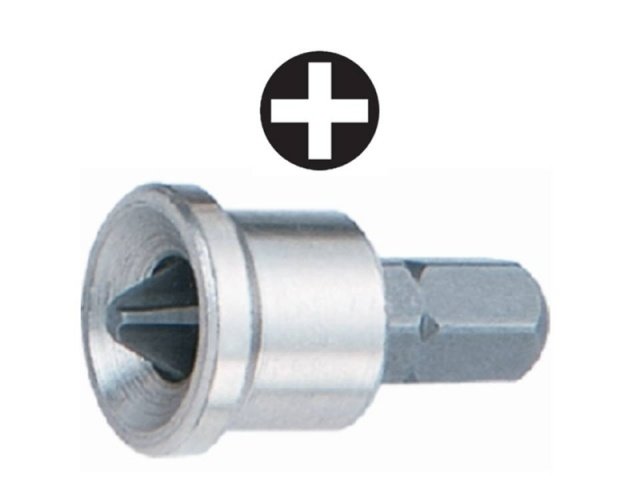

You should use metal studs and brackets adapted for gypsum ceilings. The principle is based on having some movement allowance between the roof trusses and the ceiling/gypsum boards. Then you can screw gypsum boards into the metal studs, and don't forget that the short sides of the boards should also be screwed in. If you're using a screwdriver, use PH2 bits with a stop, so that screw heads do not go through the cardboard. Fill with fiber-reinforced filler of good quality, e.g., Knauf Uniflott. Use fiberglass mesh. Skip acrylic and other mess on a tube. At the ceiling-wall transition, use wider fiberglass mesh than 5 cm. Also there, fiber-reinforced filler. Finish filling with e.g., Knauf Uniglatt. Then paint. Don't forget the primer before filling, and sand with K180 in between.
