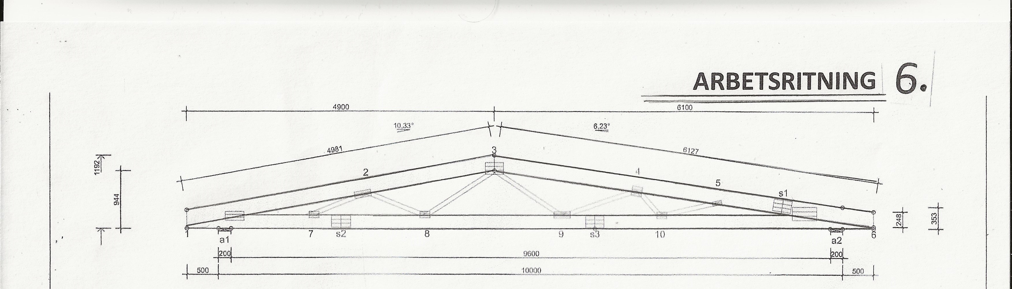

Hello, I am in the process of making an extension. I am sitting here contemplating how to solve my problem. I have received a truss design proposal.
The extension will be built on the gable side of the house, and there we have 2 windows on the upper floor with 3670mm from the metal flashing to the floor (concrete).
The size will be 6.5x10m. I can't get a proper slope on the roof, does anyone know if this slope is okay? Is it even okay with a metal roof on this?
I would like at least 14-16 degrees. Is it even possible to achieve with such a low height?

Metal roofs work well with the slope. The maximum slope is usually listed on the sellers' websites. So you know that what you buy can handle the slope. But double-lock seam metal roofs can handle lower slopes than yours.
Then I usually look at the wood guide:
https://www.traguiden.se/konstrukti...el---tabeller/tak/w-takstol-taklutning-14-14/
Hope this can be of some help!

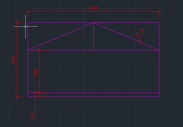

Hmm, don't know if I misunderstood something now since I got such a different number...BUT
If you initially thought that the trusses would be placed as in your existing house (same direction); but to avoid it becoming too high so that the windows on the upper floor are not covered, could it not be like this with the slope:
  • Technical drawing of roof truss design with dimensions: width 6500, height 3670, slope angle 23 degrees, showing possible height restriction solutions.
I don't think the slope will be much of a problem on the drawing, but the only thing that strikes me is that the underlay looks flimsy. In my mind, it should be quite sturdy if you consider that the snow might stay on the roof. Now it feels more like it's assumed that everything always slides off immediately and the roof truss supports itself and the roof only. Maybe even borderline. But I'm not a designer, I should say, and you can't see all the measurements fully on the drawing either.
