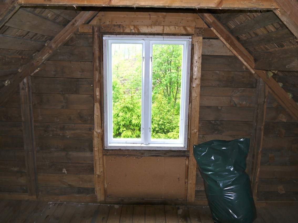

B Brks #1 Member · Halland · 22 posts 10 Jun 2012 at 12:15 PM Brks Member Halland 22 posts 10 Jun 2012 at 12:15 PM #1 Hello. Can I cut the studs that the window in the picture is mounted in without any problem? I want to install a wider window. The studs the current window is mounted in are 95x95, nailed to the joist.
Z zsimpey #2 Homeowner · saxnäs · 470 posts 10 Jun 2012 at 12:24 PM zsimpey Homeowner saxnäs 470 posts 10 Jun 2012 at 12:24 PM #2 Those are probably spike nails for the timber/panel on the outside. First, put up new studs and fasten the "outside" before cutting anything away. Sent from my GT-P7510 using Byggahus
