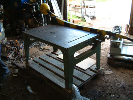

Something like this might give nice cuts... d^_^b

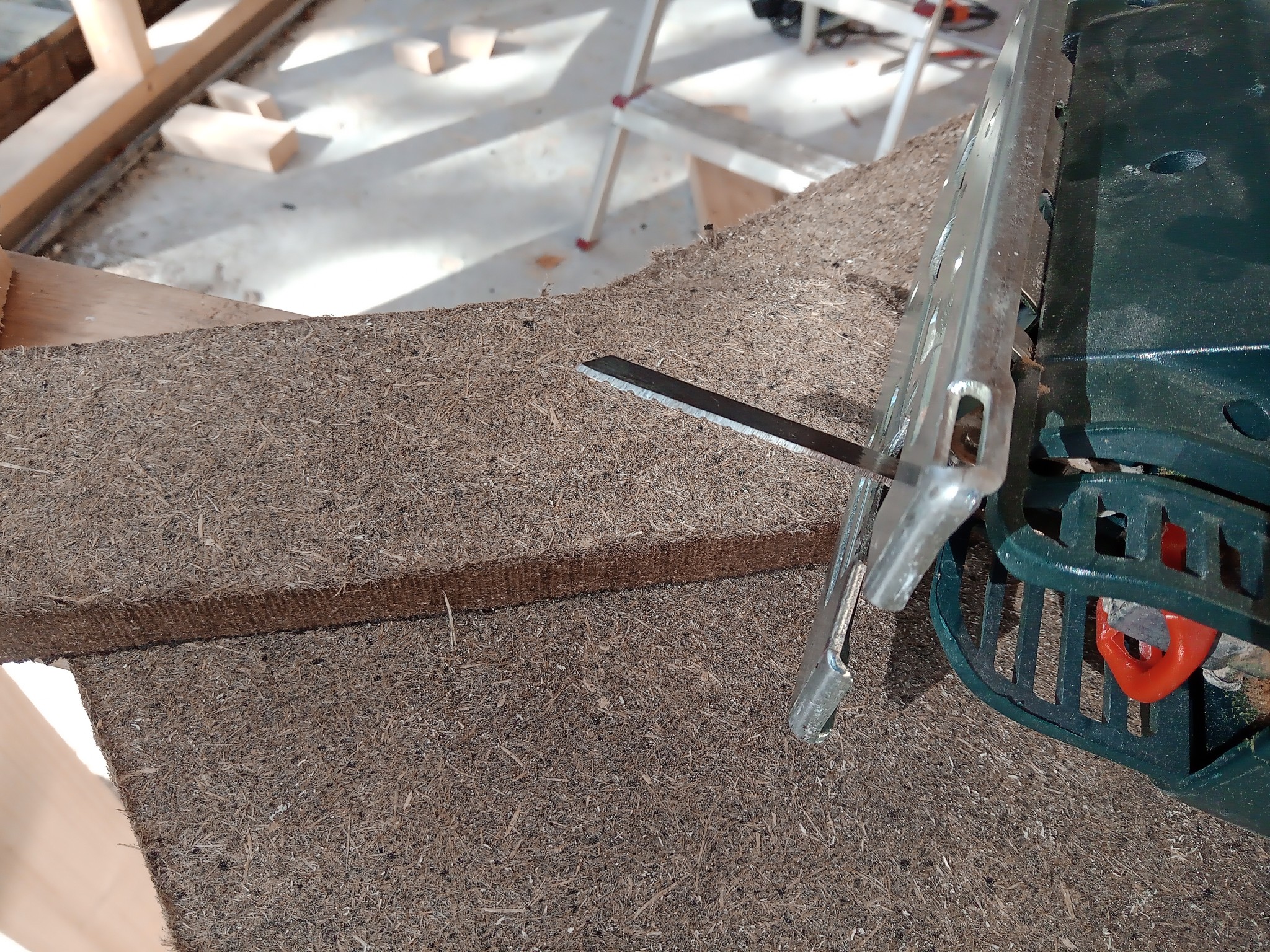

This is an old thread, but I wanted to thank you for the tip on using a jigsaw! The board was purchased at Byggmax, I took a regular blade and sanded off almost all the teeth. The result was very good! The cut surface is what you see. I ran it without support behind.
A jigsaw cutting through a board with a smooth edge, illustrating a successful result using a modified blade. Background shows a workshop environment.
