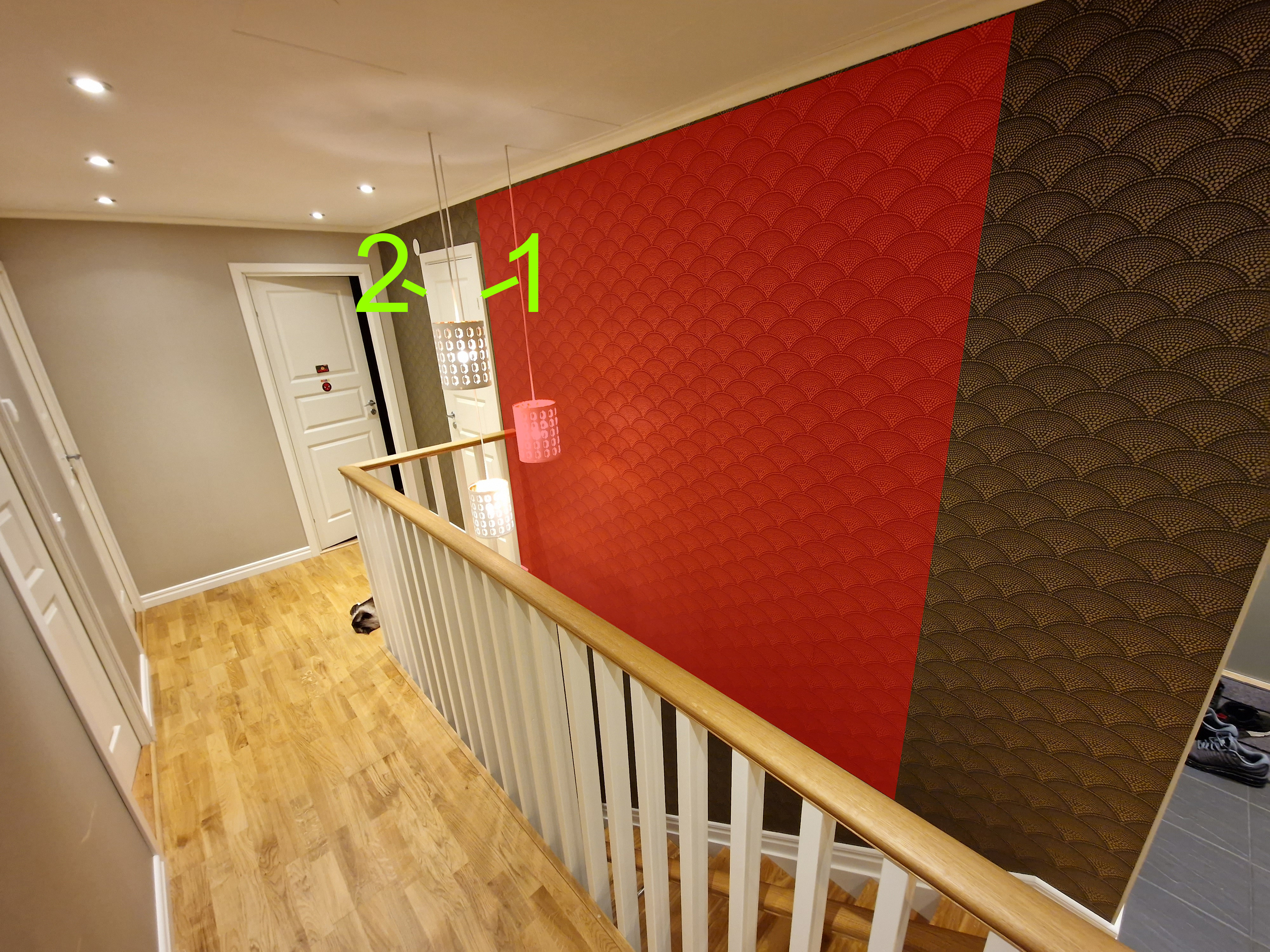

For the past 7 years, we have been renovating our 70s home, and now we've noticed that a major wall has warped (red marking):
The wall is made of wood/chipboard/plaster and extends down to the basement where it transitions to hollow bricks. If you place a straightedge vertically on the wall on the entrance level, you can see that it bends inward towards the bathroom by about 1-2 cm in the middle. The defect decreases as you get closer to the beginning of the stairs. On the opposite side (bathroom), the wall is tiled, and there are mixers, a shower door, and a towel warmer. Here too, you can see that the wall bends 1-2 cm in the same direction. However, there are no visible defects; the tiles and grout are intact, and the shower doors have built-in adjustment.
The first thought is that the wall was curved when the bathroom was built (before we moved in), BUT all doors were replaced a few years ago, and you can see that the door frame (green 1 in the picture) is also curved, while frame 2 green is straight!?

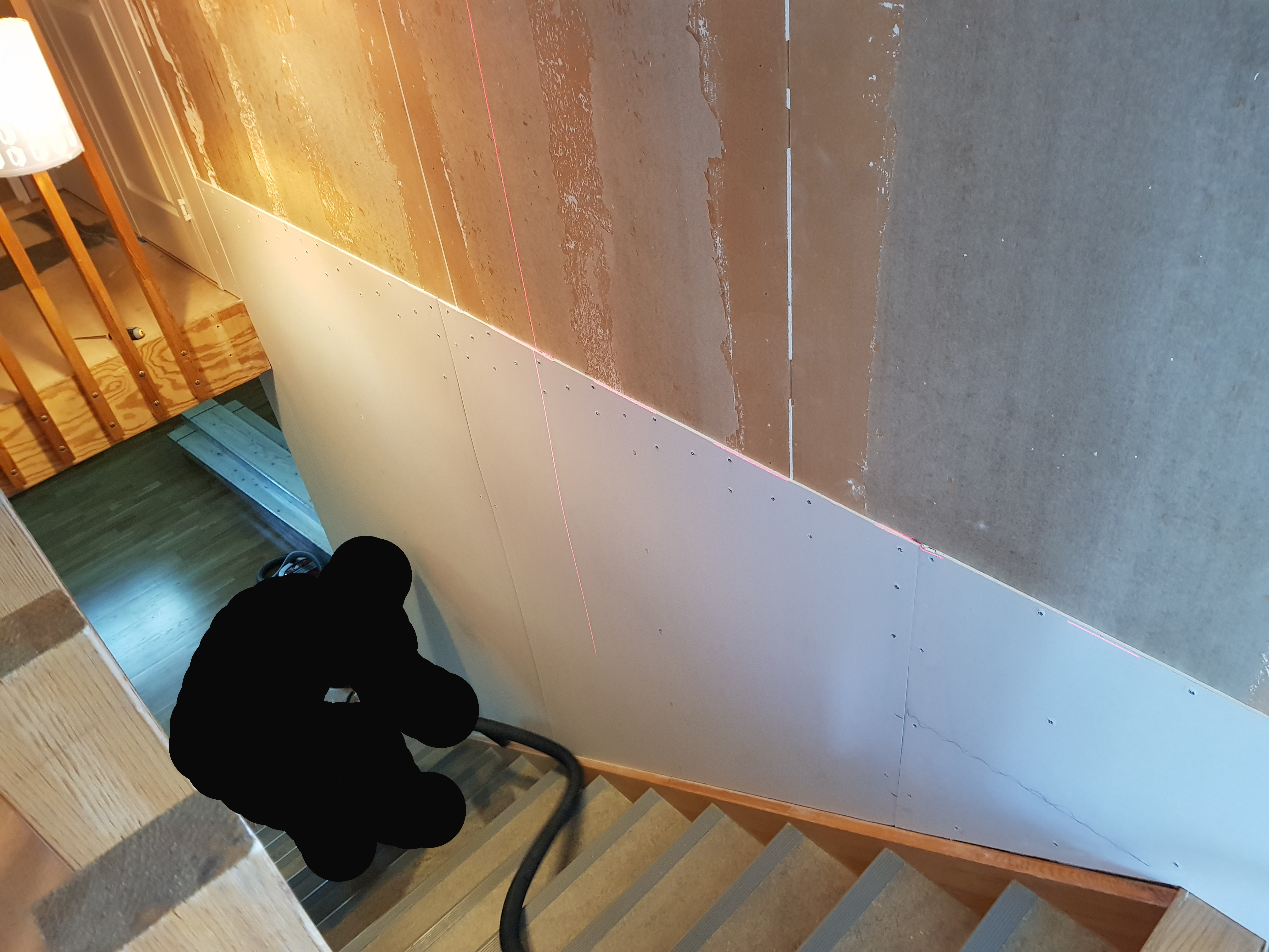

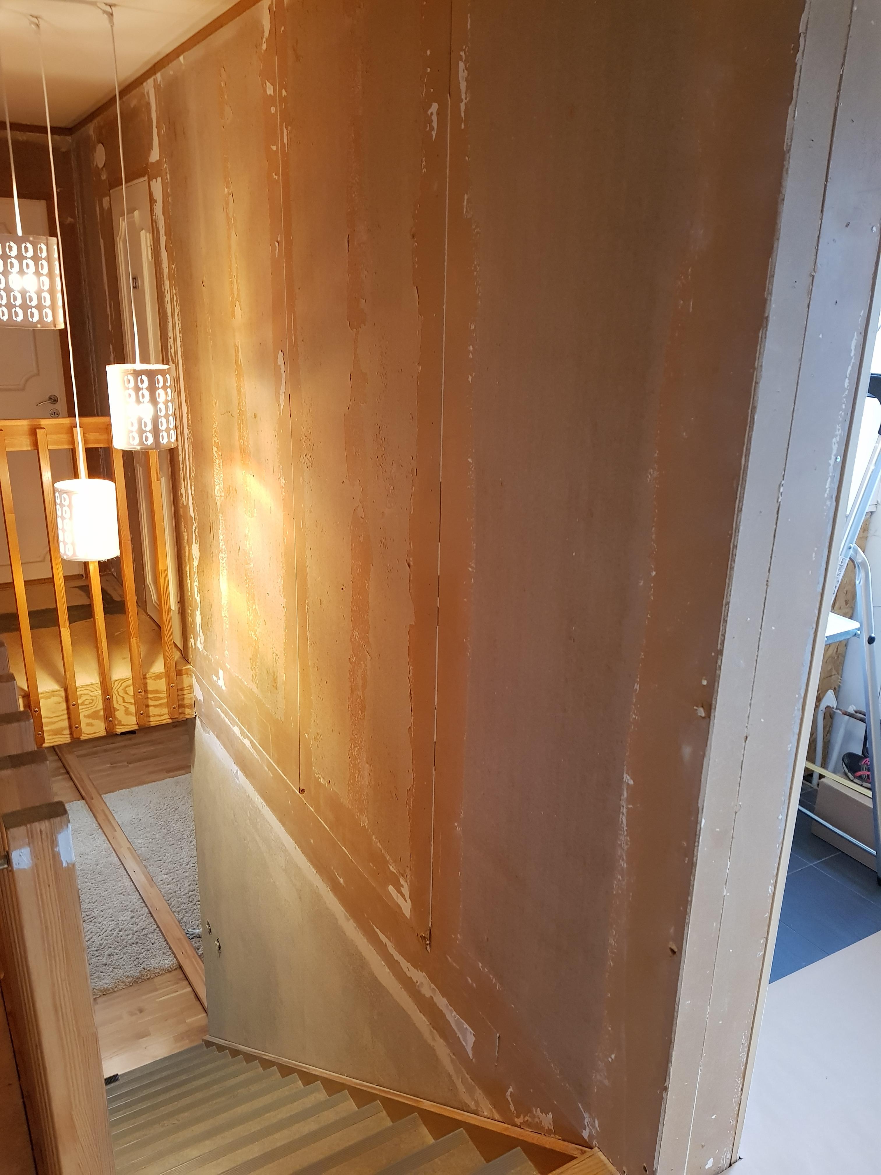

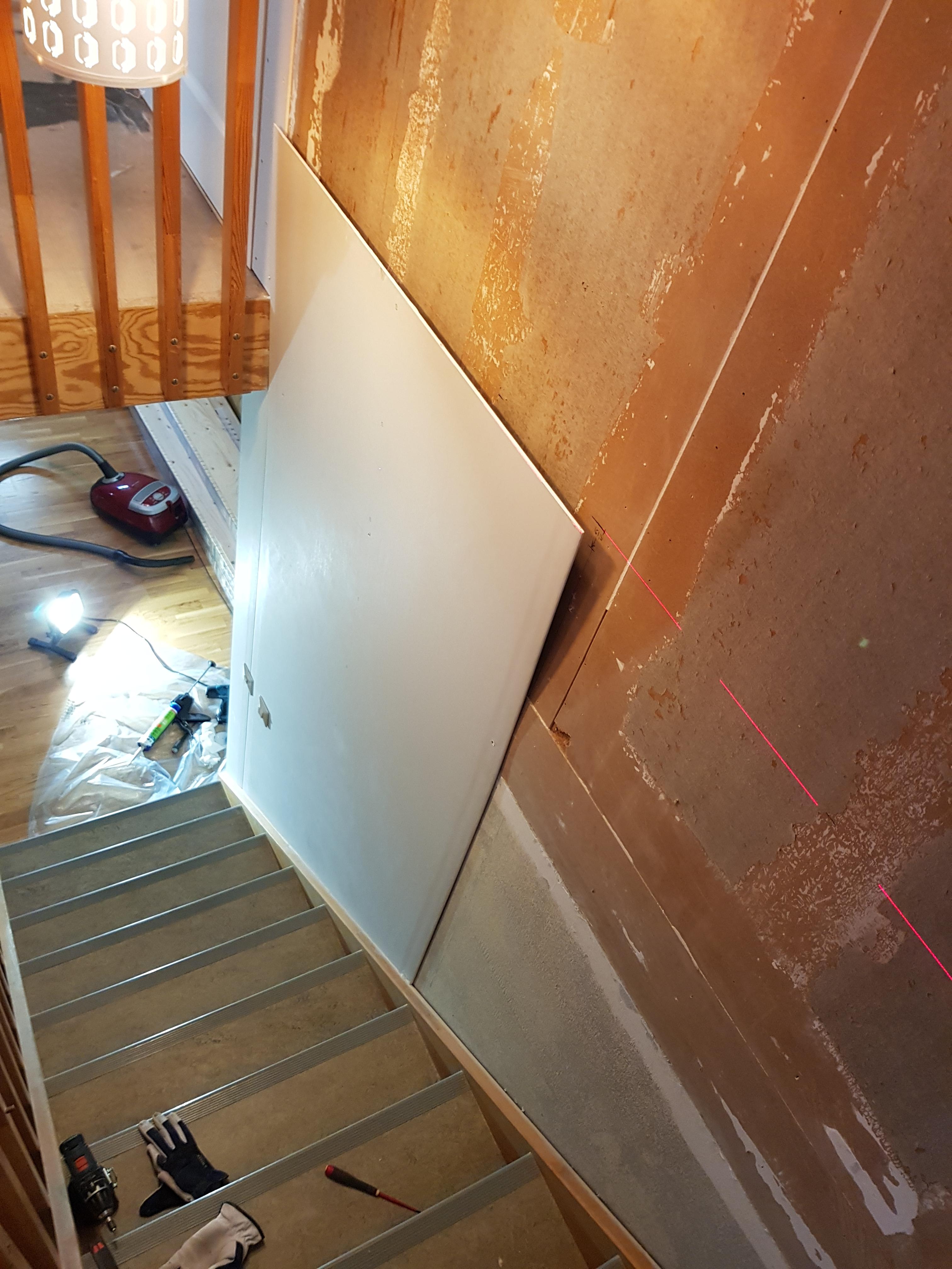

The hall was renovated a few years ago, and the transition from the basement (hollow brick) to the entrance level (wood) was not even. To fix this, we installed reinforced renovation plasterboard that we bent:
This was done by first attaching the plasterboards to the hollow brick, then gluing and screwing them profusely into the wooden wall. Even though the result was good, there is a small cavity behind the plasterboard where it curves over to the entrance level wall. However, I find it hard to see that this would cause the defect we're seeing now.
