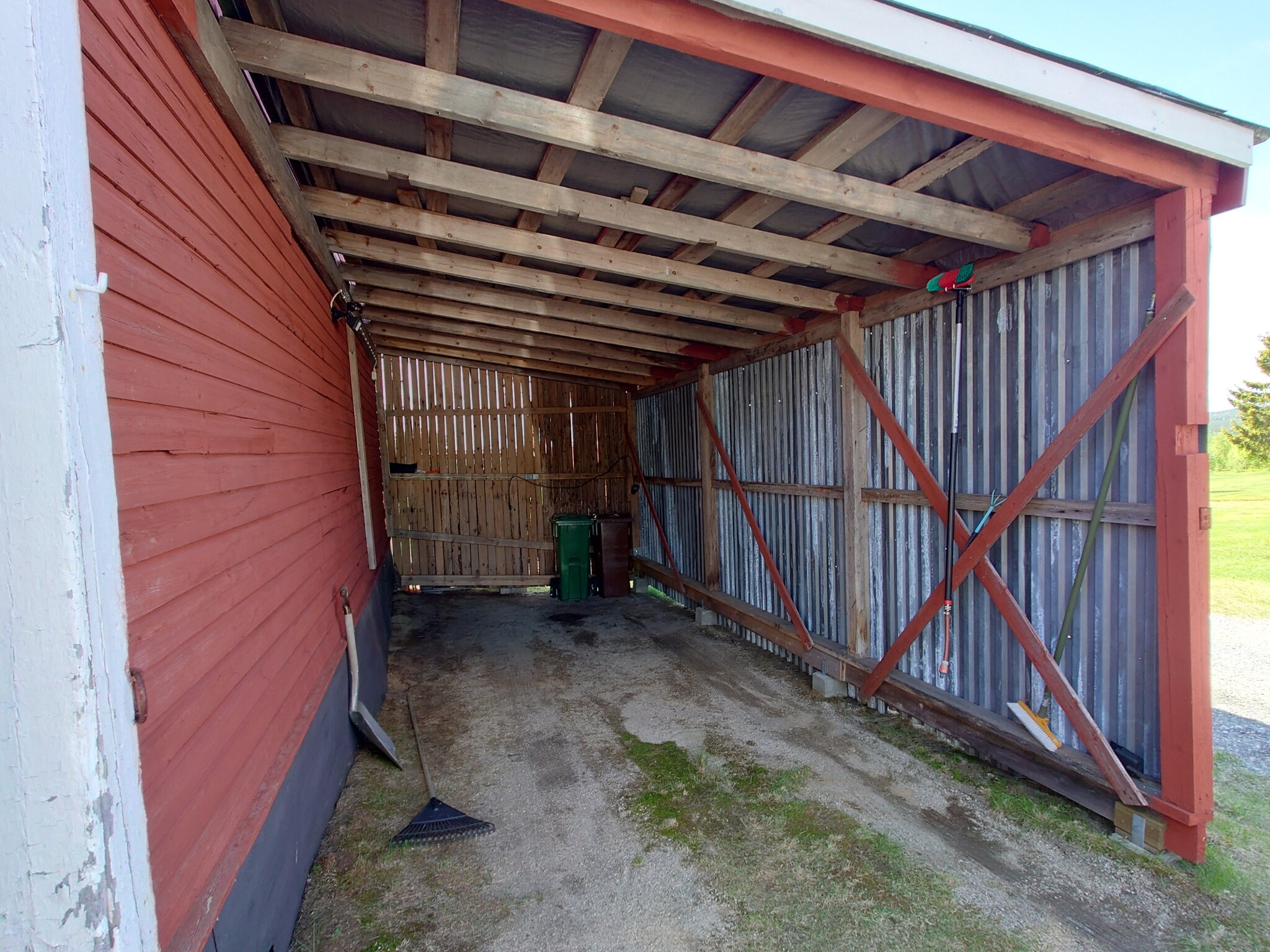

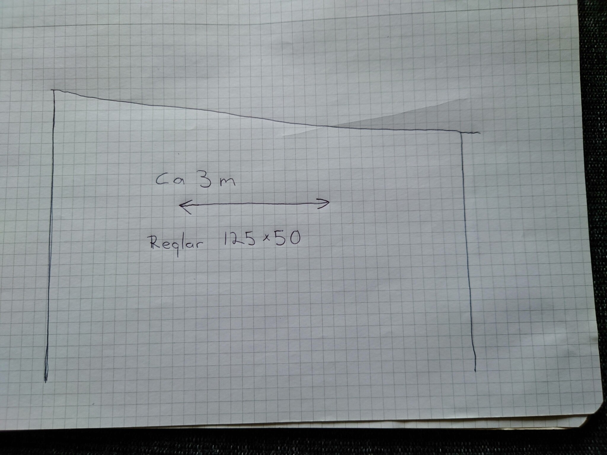

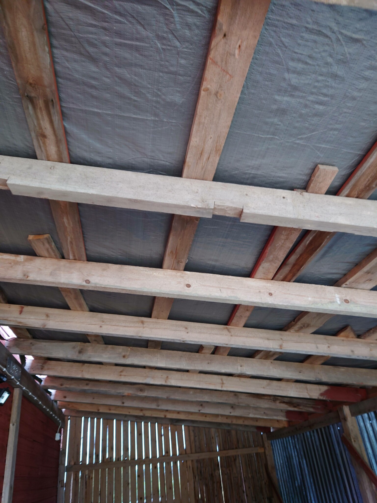

I am going to tear down this carport and make a wider one, but I know that it won't work in a dimension program as I planned, so I thought I'd ask here if anyone can give advice. The one in the picture is about 3m wide and has roof beams of 125x50 and cc600mm, and they have held up despite a lot of snow on the roof. I usually shovel when it's over 70cm, and it's probably not supposed to hold according to dimension programs, but it's worked fine.
Now I'm considering making it about 5m wide and using 195x45 and cc600, but they are quite heavy, so will they warp just from their own weight, or will it work? I understand that I might have to shovel already at 50cm of snow then. Wooden carport ceiling with beams and rafters, viewed from below, discussing reconstruction plans to widen and reinforce the structure. Drawing of a sloped roof carport plan with dimensions marked as approximately 3m wide, using beams sized 125x50 on grid paper.

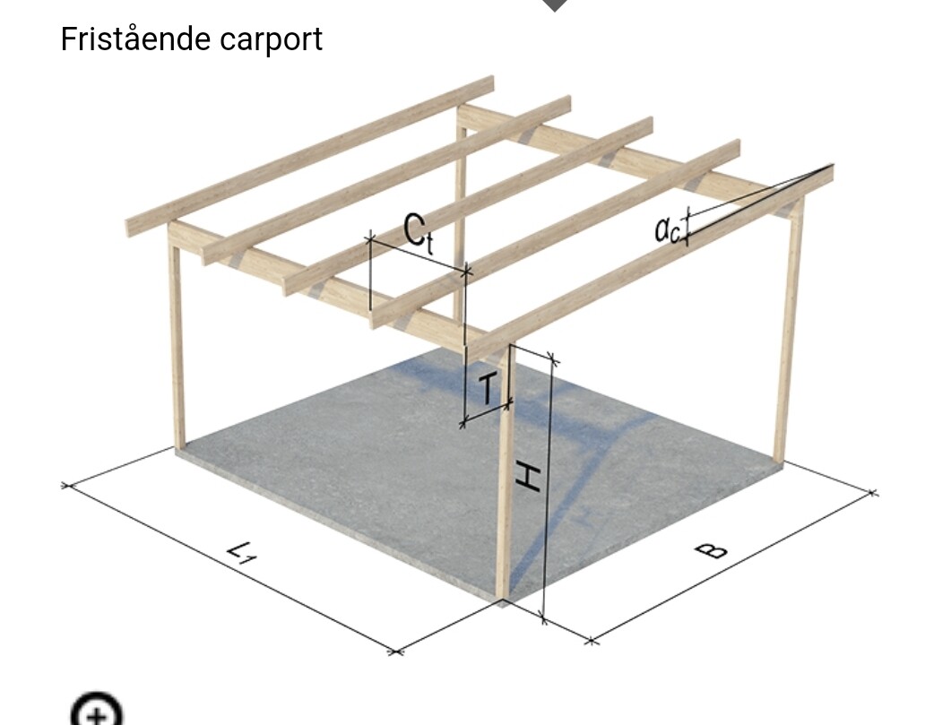

Diagram of a freestanding carport with labeled dimensions L1, B, and height. Wooden beams and posts are depicted on a concrete base.
Is the measurement B 3 or 5 meters? I think your drawing shows one thing and the text another.
I have undershot these recommendations that Svenskt Trä recommends on some sheds (due to a combination of stinginess and ignorance). Despite that, they've held up well for 15 years, with only 1 snow shoveling. But that's anecdotal evidence. And we've had mild winters and are barely in snow zone 2. So generally, it's good to follow the recommendations, if you get some rot in the beams, having some margin is good too.

All the studs visible here are 125x50 except for the roofing nailers which vary slightly in width but are about 35mm thick, and the posts are about 100x100mm. In all calculation programs this wouldn't hold in any snow zone, but it has held in Västerbotten and occasionally up to 80-90 cm of snow, otherwise I usually shovel at about 60 cm. It is currently about 3m wide but I plan to make it 4.5-5 m now with stronger studs, but according to dimensioning programs it doesn't even work in Skåne, but I think it should work if you keep track of the snow depth on the roof. How much pressure can a 5m long 195x45 hold in the middle, if anyone knows? Wooden carport structure with visible beams and red siding. Ground is partially covered with dirt and grass, tools like a rake and snow shovel leaning on the side.

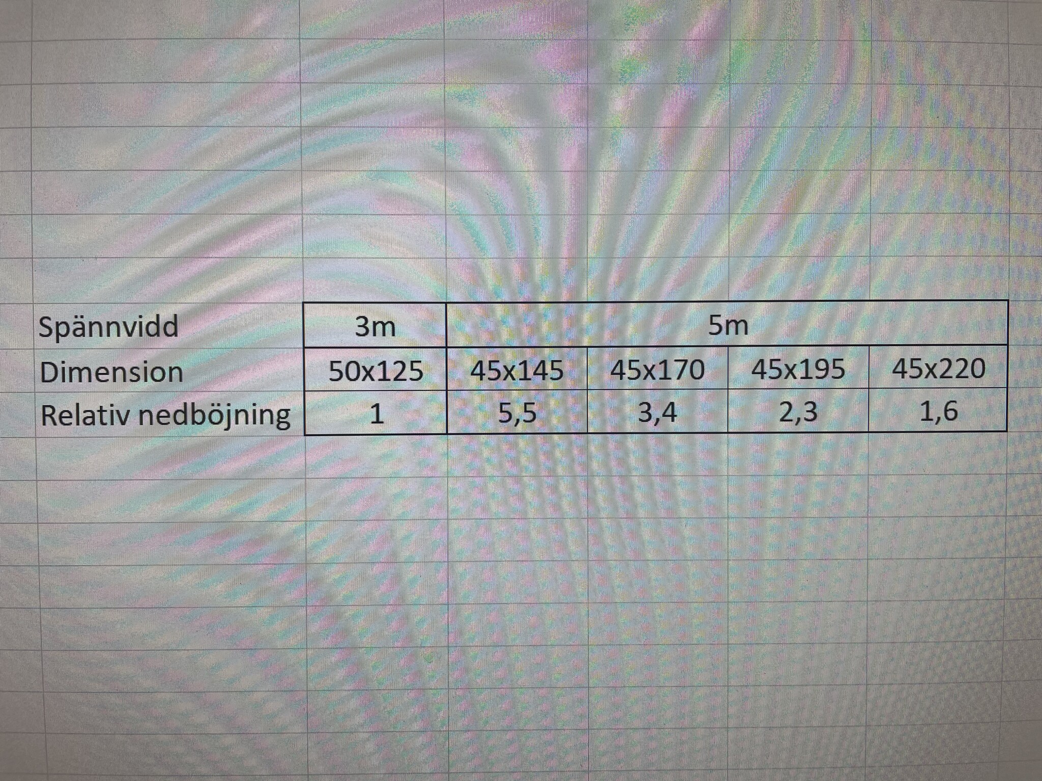

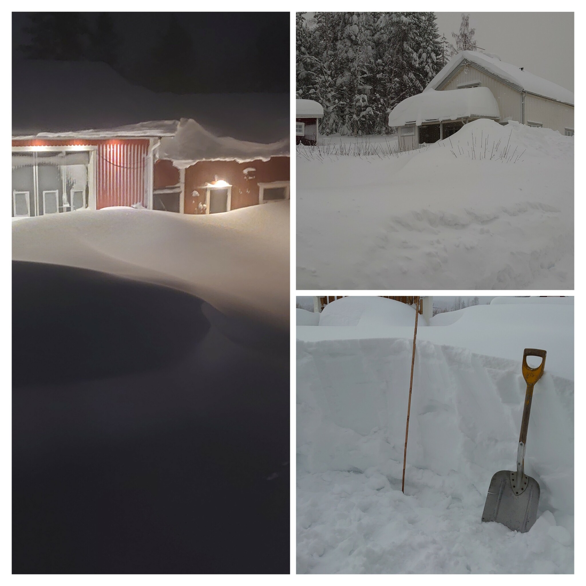

I have a pretty good understanding of what holds up without always building according to building codes, and the question is which dimension hangs down more due to its own weight if anyone knows that? Collage of three snowy scenes: illuminated building with snow-covered roof at night, snow-laden house during day, and close-up of snow with a shovel.
  • Like
hoffret
It is difficult to really understand what is actually being requested. The table shows the deflection for different dimensions in relation to your joists and span that you have today.
  • Table showing relative deflection for beam dimensions (50x125, 45x145, etc.) across spans of 3m and 5m; values range from 1 to 5.5.
