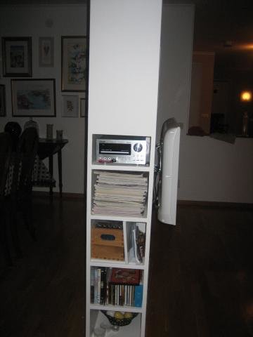

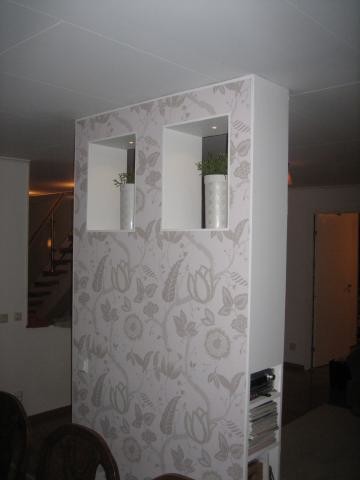

We (I) built a divider in 18 mm MDF. The wall, which is only one board wide - 122 cm, was made about 30 cm thick. We have shelves on the short side, as well as a couple of continuous shelves with LED spots - it turned out great. If you want, I can try to get a couple of pictures ...

Here are some pictures ... sorry it took a little time!

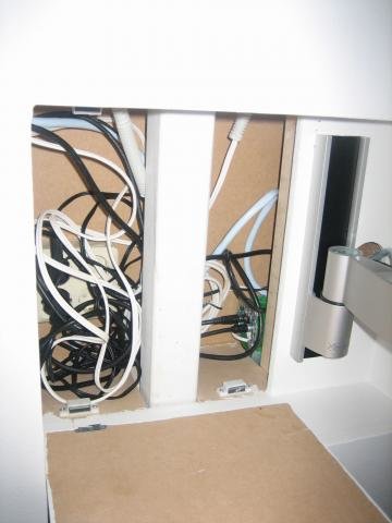

The pictures show the wall from the front and back as well as the shelves on the end. I have installed electricity and antenna outlets in the wall. All cables are inside behind the door in the picture where the TV and stereo are connected. Built-in speakers and LED lights in the shelves. We are super happy.

  • Decorative wall with floral wallpaper, featuring two shelves with plants and a hidden compartment for cables. Integrates LED lights and in-wall speakers.
  • Cables and wires organized inside a wall compartment with an open panel, showing electrical and antenna connections for TV and stereo systems.
Hi Mikael! Thank you so much for the photos. This is exactly what we are looking for. The wall shelf you made is very nice!
