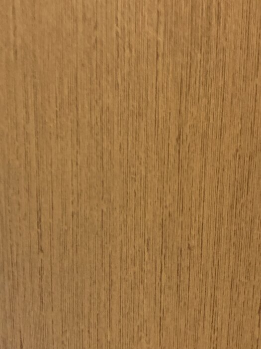

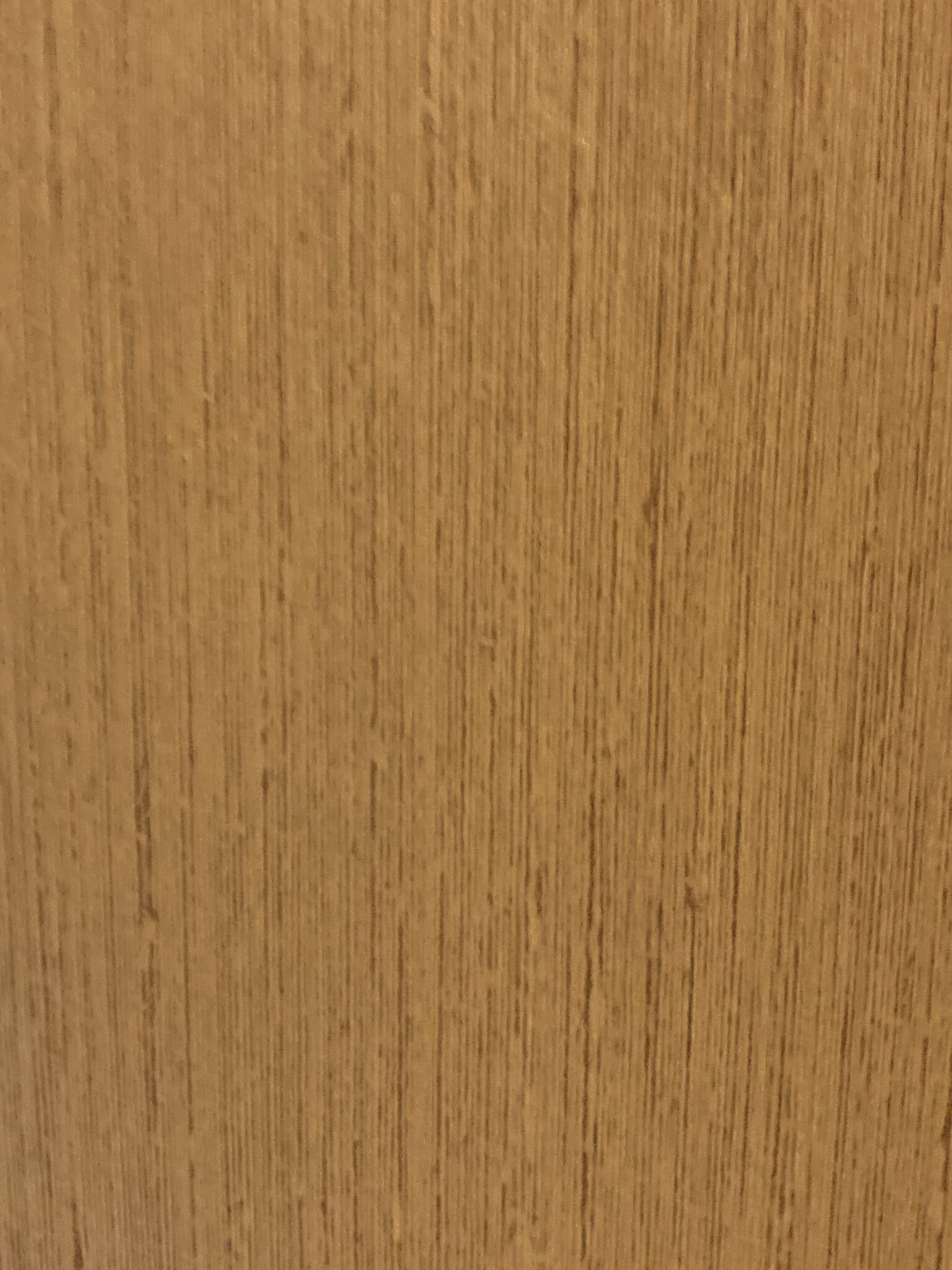

Anyone know what type of wallpapers might contain asbestos?
I have an older yellow wallpaper with some texture.
Tried soaking it, but it didn't seem to absorb the liquid so I think it might be some kind of old vinyl wallpaper.
Was it common for this type of wallpaper to contain asbestos in the past?
Thanks in advance!

Based on the image, I think it looks like painted thread/textile wallpaper.
I don't know where you found that it would be common to have asbestos in wallpapers. As I recall, vinyl wallpapers became popular around 1980 (in bathrooms/kitchens) and by then people were well aware of the dangers of asbestos, and it was banned in most things.
But as always, to be sure, you should send in a sample for analysis.

I simply read that online. There's quite a bit of information about asbestos related to wallpaper.
Do you mean that in the picture it looks like someone has painted over the wallpaper? I really don't think so, and that it's just wallpaper. I tried moistening the wallpaper, but it didn't absorb the water. Which to me indicates that it has a layer of something on top (plastic/vinyl?).
But are there other types of wallpaper that also have this surface that doesn't absorb water? Or does that simply indicate vinyl wallpaper?
To me, it looks like some sort of textile/yarn/thread wallpaper that someone has painted on. But that's my interpretation of the image, and it doesn't necessarily need to be correct. You see it in real life and from different angles.
The Swedish Work Environment Authority does not have wallpaper on its list of what craftsmen should beware of here: https://www.av.se/halsa-och-sakerhe...ter-och-verksamheter/asbest/har-finns-asbest/
Typical examples of pages I find when I search: https://duckduckgo.com/?t=ffab&q=asbest+i+tapet
Vinyl wallpapers probably came to Sweden after it was known that asbestos was dangerous, so it's unlikely that a textured wallpaper contains asbestos.

https://www.byggahus.se/forum/threads/asbets-i-tapet.542036/post-6106366Very rare. The production of asbestos was banned in stages up until 1977 and was used to a very limited extent until 1982 when it was completely banned as a building material. It was mainly used for fire protection and pipe insulation but also in roof and trossbottenskivor. As long as you haven't had a fireplace in the kitchen before, I would say the risk is minimal.

Sure, it could be an old vinyl wallpaper, had something similar in the wet rooms of my parents' home from the mid-70s. But absolutely without any asbestos. The total ban only came in -82, but it was phased out long before that and, as mentioned, is extremely rare in Swedish wallpapers.

Vinyl wallpapers came to Sweden after it was known that asbestos was dangerous, so it's unlikely that a textured wallpaper contains asbestos.
In the early 70s, when it was discovered that asbestos was hazardous and needed to be phased out, thorough checks were made on which products it was used in. It was first banned in applications where there were already other alternatives, and the longest time was taken for brake pads in vehicles because a reliable alternative without asbestos was not known. Paper wallpapers have been around for over 150 years, so there is no reason to have asbestos in them. Vinyl wallpapers are plastic, and I can't see what would be gained by including asbestos in them.S Slottsfrun said:
Asbestos was never free, and it was only chosen when its properties were crucial.
Yes, they were very similar and no samples were ever submitted, as it was my parents who put them up and my mother was quite paranoid about most of the things purchased.S Slottsfrun said:
When they built the house in 1973, asbestos was a very well-known concept in society and not something attentive consumers bought unknowingly.
As I said, a total ban on asbestos in all products was introduced in 1982, but that doesn't mean everything contained asbestos before that…
You've been given a number of good links to reliable sources, the Swedish Work Environment Authority probably carries the most weight in this context.S Slottsfrun said:
They are extremely cautious in their advice to professionals and have very good statistics as the basis for their recommendations, which *do not* include wallpapers as something to worry about.
But, if you really are concerned, send in a piece to https://asbestprov.se/ and you'll get a definite answer.
