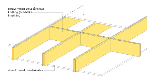

Deflection in a floor is not fun. When I built the joists, I made sure to overdimension (set at cc30 with 195 joists instead of cc60 with 220), install nogging pieces, and use glued double plasterboard. Span of 4 meters. A substantial overdimensioning, but when I compare it with a concrete joist, the concrete is much more stable. The wooden floor flexes a bit if you jump hard. However, much less than many other wooden joists I've seen.
If I were to do it again, I would consider incorporating some glulam beams among the studs just to stiffen it up further.

I agree with Autodidak1 about not using too narrow pieces for the noggings, as you won’t get the desired function. They should be as high (or almost) as the beams to provide the best result.
If you really don't want to buy some supplementary wood when your wide scraps are gone, then put two narrower ones on top of each other in height. More work and more screws, but maybe that's more important than the hundred bucks it saves?

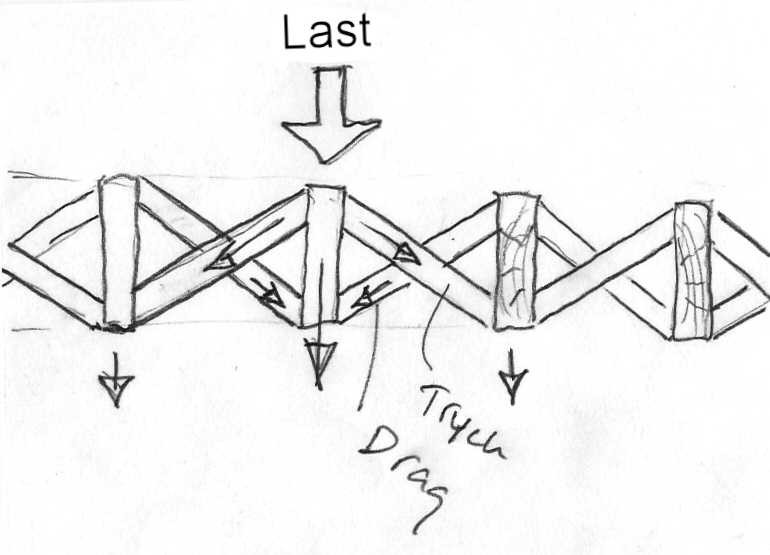

Sure, it makes a difference! In principle, one can imagine laying beams in both directions! However, that principle doesn't hold because we don't have full beams, only short "shortlings." Attached is a small sketch showing how the forces are distributed if you "crossbrace." The forces will spread similarly even if you have whole pieces instead of diagonals. - The advantage of diagonals instead of shortlings is likely that a skilled carpenter can pre-tension them. Sketch of crossed battens showing force distribution; labeled "Load" with arrows indicating pressure and drag forces.

Cross battens are for cooperation AND to prevent the floor joist from twisting during deflection. I offset the cross batten by 45 mm on every other one so I can screw it through the joist into the cross batten. It becomes rigid and good.
Additionally, in the picture above, the flooring chipboard (tongue) should be mounted across the floor joists. :rolleyes:

justus; Which glulam beam? The illustrations from the wood research are apparently calculated by a designer. And, for a standard floor structure with a clear span, 45x220 other timber is used for 3.6 m cc 60 cm, 3.9 m for T20, and 4.2 m for T30. Additionally, 2 rows of noggings are recommended. Noggings are not an emergency solution but distribute the loads over the floor structure. If the floor chipboard is glued and screwed, a good panel-effect structure is obtained. All according to the old Building Research.
senior consultant: You have misunderstood me. I was commenting on the image that tobbew first published in this thread, not on the Träforskningen image. I have had great confidence in Träforskningen for a long time. I often use their Träguide for quick calculations. I also share your opinion about the value of noggings in general. However, in this case, no noggings are necessary as the floor joists are fully sufficient as they are. In the Träguide, there are no tables with c/c 300 between the joists, but one can extrapolate the information available for c/c 600 and see that the current construction (45x220 c/c 300 4 m long) results in lower design bending moments than comparable 45x220 c/c 600 3.5 m. This assumes that the timber used is of the construction class C24. Additionally, it is essential that the glulam bearer beam is correctly dimensioned.
