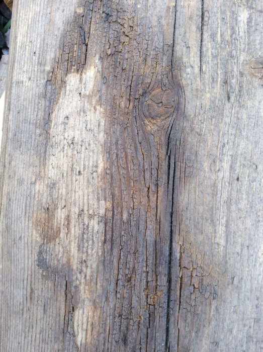

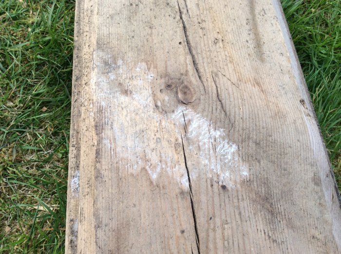

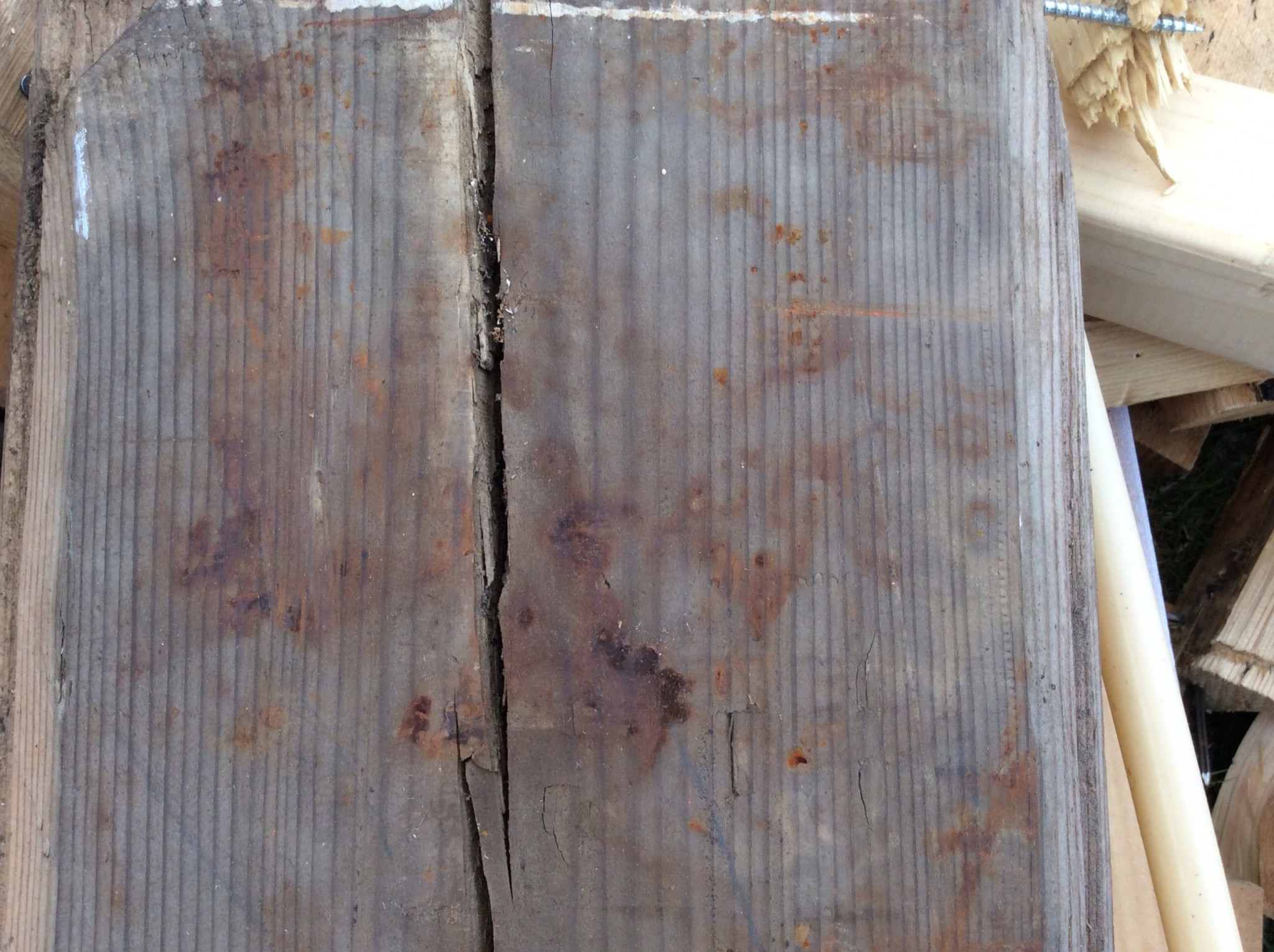

After careful consideration, I decided to sand my old wooden floor instead of installing a new one. However, in some places, the floor needed to be "patched up" a bit where a plank was missing, such as in doorways. My craftsmen, who seem to be great, said they would put in wood where needed, in preparation for the floor sanding later on. I have now seen that they have patched in some places and also discovered a plank they left on the floor in the house. I quickly concluded that it is old wood and the craftsmen had also suggested that I use older wood to maintain the feeling even on the pieces they would repair with.
The plank they left lying on my kitchen floor looks like the following from the pictures below. What do you think when you see these? Personally, I felt a certain unease and immediately started thinking about house fungus, etc.
What do you think this infestation is? And, if it is previous house fungus infestation on this wood, could it have spread spores to my indoor environment? And worst of all, how would you have acted concerning the pieces they have already put in? What if they look the same? Or do you think it's completely fine?
How would you act if you were me? I'm feeling a bit panicked...
Even the third picture suggests fungal attack. I would definitely NOT want to have those planks in my house!

Image 1 shows some rust spots, nothing to worry about.
Image 2 shows a bit of rot from old moisture, I'll cut that part off or turn it around so I don't have to see it if it's superficial.
Image 3 shows some mold, I'll kill it with bleach or Mögelfri or Boracol before I mount the plank.

When it comes to dry rot, there are many myths and misconceptions. The hysteria is significant and encouraged by several actors with commercial interests, primarily perhaps Anticimex. A worried person is always easier to profit from.
I wouldn't be the least bit worried and would have done exactly like Mathias.
The "attacks" and damages you show I would say are quite normal on slightly older flooring timber. Rather small damages. The type of mold/fungus shown in picture 3 easily develops if moisture gets into a stack of timber where there is no air between each plank. I strongly doubt it's true dry rot. Wash or saw away the damages/attacks and be happy.
As mentioned, there are many myths and exaggerations about dry rot. The spores are already everywhere in the air, so you haven't introduced anything that wasn't already in the air. What determines if the fungus starts to grow is if there's a damp environment where it can thrive. If it's dry, it can neither grow nor gain a foothold.
