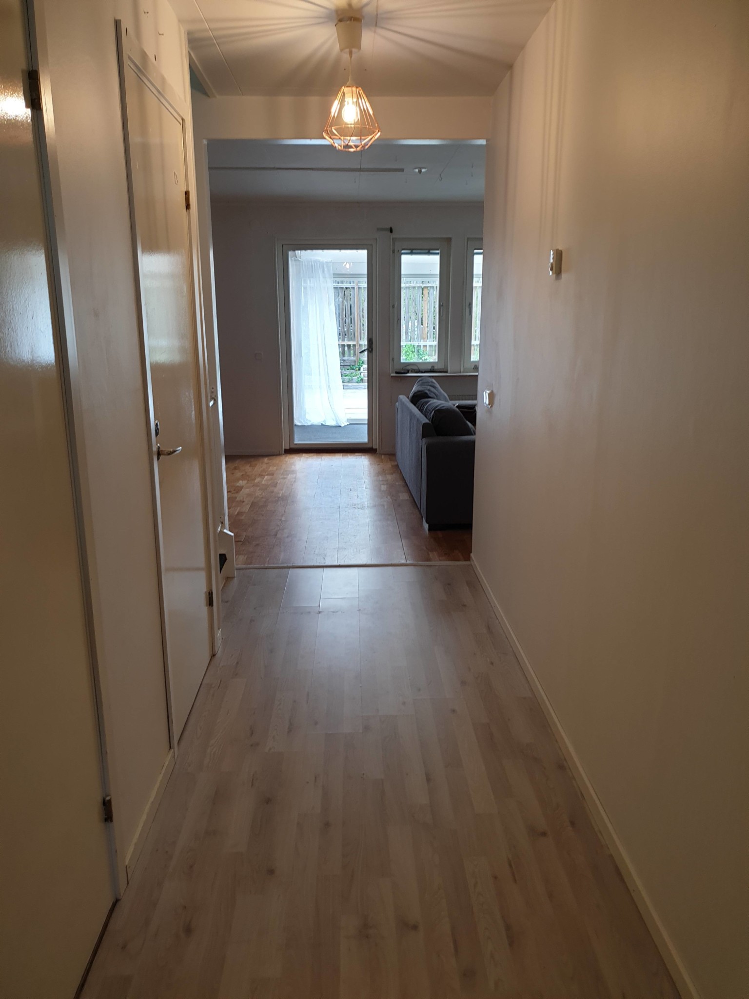

Hi, in the hallway where I have moved in, you can see stripes on the inner wall, like a hardened area. It seems like the wall is wavy/bulging out a bit, what could it be due to? I am not aware of any water damage, not sure if I posted in the right forum. Behind the wall are the kitchen and laundry room.
  • A hallway with wooden flooring and white walls, showing a wavy pattern on the wall surface, possibly indicating a structural issue.
Joints between the panels that are plastered on accord.

Is there something that needs to be done about it? Sorry, but I'm completely useless at this, it's the first time I own something myself.
Just close one eye as you walk past.
abdulhakim abdulhakim said:
Is it something that needs to be addressed? Sorry but I'm completely bad at this, first time owning my own
Is it new construction? If so, you can report it to the contractor and let them investigate. Even if they want to do something, they will probably wait until the two-year inspection, that's what they have done where I've lived.
But HOW wavy is the wall, place a straightedge/long ruler there.
With grazing light, very small undulations are visible.
Protte
If you place a slightly stronger lamp closer to the camera, it will disappear. It's only an aesthetic issue.
If you put up a patterned wallpaper, paintings, or something, it will disappear as well.

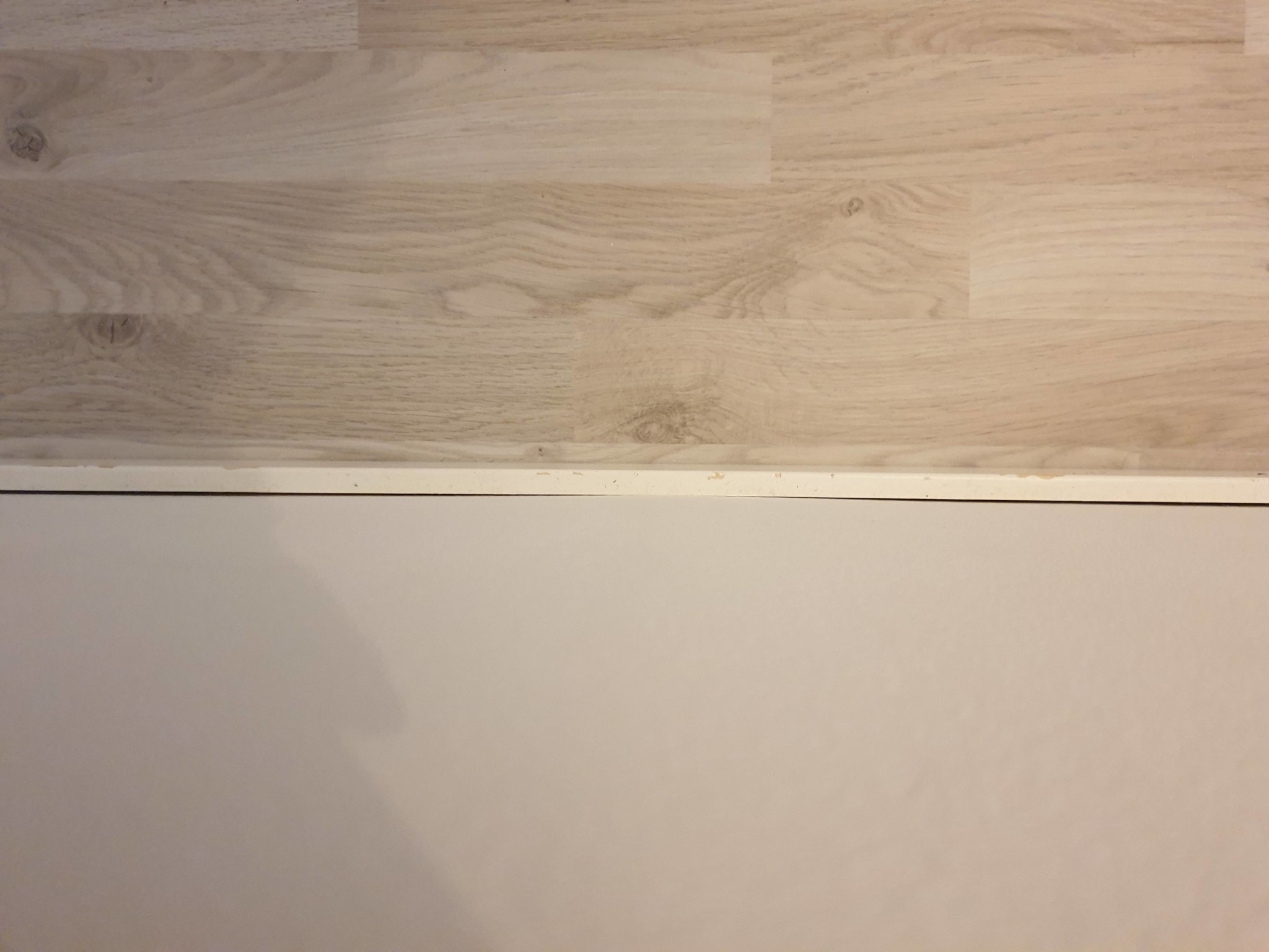

Here you can see via the skirting on the floor that it bulges out a little.
  • Baseboard along the floor shows a slight protrusion.
Okarlsson Okarlsson said:
Is it new production? If so, you can report it to the contractor and let them investigate. Even if they want to do something, they will probably wait until the two-year inspection, as they have done where I have lived
Unfortunately not, it's built in the 90s on townhouses that are condominiums.
Anna_H Anna_H said:
If you place a slightly stronger lamp closer to the camera, it will disappear. It's only an aesthetic flaw.
If you put up a patterned wallpaper, paintings, or something, it will also disappear.
It's true that it disappears, but check out the latest picture. I was a little more worried that it bulges out a bit. That being said, I know pretty much nothing, so it's nice to have joined this forum hahaha
That's how it is for me in some places too. It depends on poorly stored gipsskivor, at least in my case. Here, gipsskivor have been stored in unheated spaces with insufficient support, causing them to warp slightly. The advantage is that it's easier to find where the studs in the wall are. :):rolleyes::(
