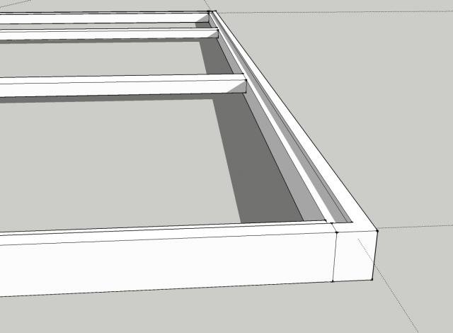

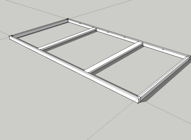

Avoid MDF. Expensive, poor, heavy material that is useless for most purposes except for soundproofing in partitions. If you want furniture quality, you'll need to upgrade to HDF boards which cost more and weigh even more.
With such a large board (2440x1220), you can't avoid sagging even if it is 16 or 19 mm thick (which weighs like lead) if you want it freestanding.
I suggest you take a thinner quality plywood and reinforce it with a rabbeted batten along the edges and two across the middle from long side to long side. This way, you get a lighter construction that is easy to work with and at the same time cheaper.
Here's how I would do it: planed pine batten in dimension 45x34 for a frame that you mill a rabbet groove into along one edge with a handheld router, 7* mm deep (on the 45 side) and 20 mm wide (on the 34 side), along all four sides around the 'table'. You can plug the corners, half-lap them, or dovetail them. Two 28x70 spruce on the flat under the board (not visible when the 'table' is folded down) that you fit with 8 mm dowels into the aforementioned 44x34 (two dowels at each end, total of 8 pieces).
With the rabbet inwards, you can then place a 7 mm plywood board with one or two good sides (depending on whether you can tolerate seeing a slightly knotty side with the board folded up and can afford it). Glued and screwed to the 45x34 in the rabbet.
This way, you get a torsion-resistant table that doesn't sag and doesn't weigh too much. Maybe a bit more work than just clamping up an MDF board, but you couldn't have had that unedged for long either, and then it would have been even more expensive and heavier.
There may be problems finding 7 mm plywood in the format 2440x1220. They tend to be 2000x1000 in standard size. Check with the lumberyard. Finns make larger boards in birch.
*The depth should match the thickness of the plywood.

I probably relied a bit more on the drawing than the builder did, but if one is free to speculate, there are many good variations. The builder's is absolutely good...

The construction I showed in the drawing should also have legs if that wasn't clear.

Exactly so. If you can't find 45x38 dimensions, you can take the one closest in width. It's the height (45) needed to make the plywood sheet stiff. If you then want a nice backside, I suggest using a 3 mm plywood with a good side there. It won't have any other function than to cover the cross ribs when the table is folded up.MrWalker35 said:

Would there be any difference if you assemble a frame with 45x45 and have 2 pcs of 45x45 in the middle (instead of 28x70) to then screw a 7mm plywood directly on top. That is, "avoid" the step of milling.
Would it significantly affect the construction? Screw and glue all joints?

Every millimeter lower in height results in a more unstable construction. With a recessed plywood sheet, the edges are protected by the frame. They aren’t if you nail the plywood directly on top. But you can 'save' some of the edge and avoid milling if you finish with a beveled corner strip of planed pine around the edge.MrWalker35 said:

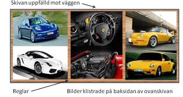

I wasn't planning to get involved in the basic construction itself but more on how it looks when the board is folded up.
It's a bit dull and perhaps not very nice to have a large board folded up against the wall, and you might want to cover the frame with another board on the underside that you'll see when the table is folded up.
An idea:
Instead, skip the board on the underside, build the "frame" in oak or another type of wood that matches your other furnishings, and voila, you have a nice photo frame with space for stylish photos that you can have a photo shop fix in the right size. You mentioned a car track, so why not like this:
An idea:

The idea with the picture underneath is not so crazy, but it fails because a central batten is needed for the plywood if it is to be thin=light. Then you need two fields or why not 3, 4, or 6 for appearance's sake? (Unless you finish with a 3 mm plywood and get a completely smooth underside. Then there will be no fields at all.)
