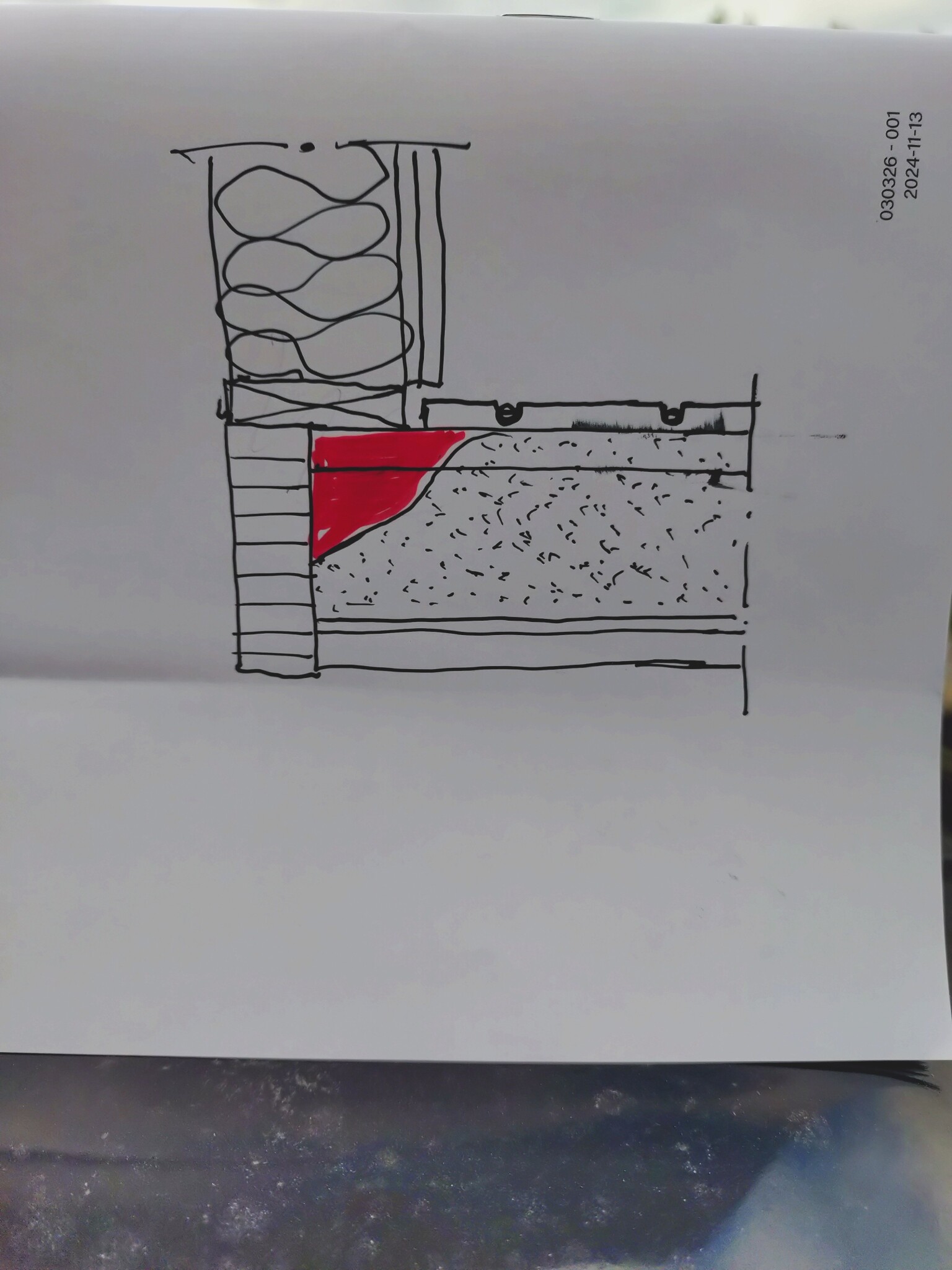

A little late discovery, but after the underfloor heating coils were laid, I found through the gaps that exist that there are missing filled compartments in the joists where insulation has been sprayed in.
A hand-drawn diagram showing floor insulation with missing sections highlighted in red, illustrating an issue with underfloor heating installation.

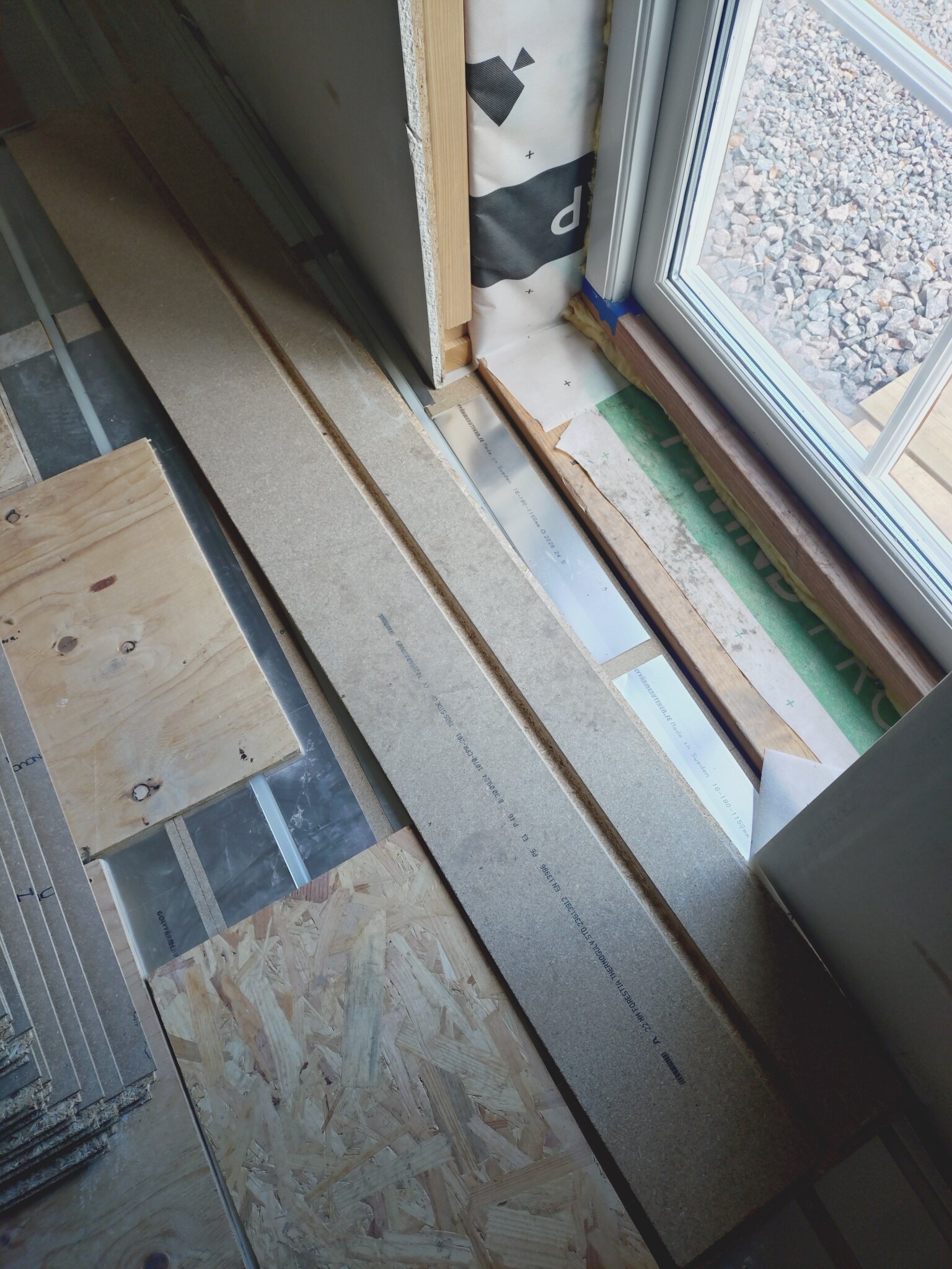

View of a floor and window area showing uninsulated gaps between floorboards, with visible boards and construction materials nearby.
How can we fix this?
The unfortunate thing about this is that the company/person who did this had an accident and is not able to communicate. So my carpenter doesn't know if we can continue from above or if it should be fixed from below.
Got a tip from an acquaintance who works as a carpenter to lift off/up the outer loop of the underfloor heating pipes, drill holes, and fill. The cut-out holes are plugged. The disadvantage of this is that we perforate the plastic that lies between the grooved underfloor heating sheets and the plywood.

If it is not addressed, you will likely get substantial thermal bridges there, right?
What kind of insulation is it, is it Hunton?
If it's possible to drill holes from above, that sounds like the easiest solution. Can't the holes made in the plastic be sealed with tape?

Got a tip from a friend who works as a carpenter to lift off/up the outer loop of the underfloor heating coils, drill holes, and fill in. The cut-out holes are sealed again.
The disadvantage of this is that we perforate the plastic that lies between the grooved underfloor heating boards and the plywood.
I would probably go with that suggestion.
You can tape the holes.
Still air does not transport either warm or cold air.
How large are the spaces really, where there is no insulation?
Not cubic meters, right?
H Hybro said:
Stationary air transports neither warm nor cold air
The uninsulated spaces aren't 100% airtight, right? So it doesn't become completely stationary, does it?
Guarantees are often just nonsense. Fill the void and move forward in life.

Well. It probably won't be significant but rather minor. TS should consider doing nothing.
