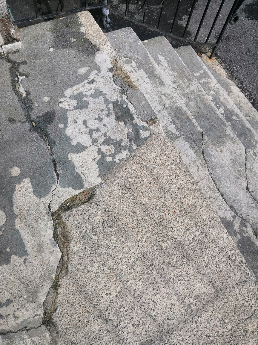

I want to do a quick facelift of an old staircase using tiles. The tiles I'm considering are frost-resistant.
At first, I thought about removing all the plaster before tiling, but since the staircase has been repaired with concrete, it would be a bit too much to chip away to get a good level to lay on. Instead, I'll chip away any loose plaster and repair with concrete filler.
There "shouldn't" be any problem with having the tiles stay in place for a few years, right?

Check if the tiles become slippery in the winter, if they tolerate salt, or if they are not scratched by sand/gravel during winter slipperiness.
An alternative is to install electric heating cables. They only need to be on when there is a risk of slipperiness.

Choose a properly textured klinkets, as reasonably smooth tiles become slippery as snot!
We have had tiles for 5 years now without anything coming loose. It also doesn't feel so slippery in the winter thanks to the grooves cut into the stepping stones.
