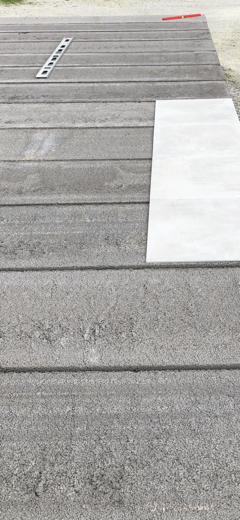

Then it's time for a new project. 100 square meters of outdoor decking to be covered with 60x60 tiles. The base is a construction of reinforced lightweight concrete in beam form (similar surface structure as lekablock). Attached is a picture.
Do you have experiences/tips on adhesive to use outdoors? It's quite a large area, so I'd appreciate suggestions that aren't the absolute most expensive
Another aspect is that the base absorbs a lot of moisture, are there adhesives that can be adapted for that type of material?

Since it might not be a completely common construction, I would call one of the larger suppliers and talk to their technical support.

Thanks for the response. I think I've managed to find good stuff from Schönox!

I will use Schönox TTS8 adhesive
Regarding the construction, I have done a lot of research on different methods to prevent what you describe, which is a common problem (almost unavoidable) with outdoor tiles in Sweden.
I will not use any waterproofing layer since the construction allows water to pass through; if you pour a bucket of water, it runs right through. To avoid frost damage, the tiles will be double-bonded. I also plan to use epoxy grout to try to prevent water from penetrating the joints. After a couple of years, this grout will probably also allow water through, but I hope the lightweight concrete substrate will absorb the moisture instead of causing water accumulation between the adhesive/tile and the substrate. Additionally, the entire patio has a slope of 1cm/meter.
I have considered some type of waterproofing, but I don't believe in it outdoors since the normal surface tension of water between the waterproofing and adhesive should be enough to break a tile loose in frost? My own theory, but I would love to hear what others think?

Okay, thanks for the info. I've talked to Schönox, and they say the adhesive works fine for the purpose. Can you see anything negative about not having a waterproofing layer and using a substrate that allows any moisture to pass through?
I think you lay tiles 60 x 60, 20 mm thick, and they rest on pedestals. Difficult with adhesive -5 night, +4 day.nino said:

Hi, laying tiles on feet is good, can be lifted for maintenance.T Thomas_Blekinge said:Tell me. I have tiles on a concrete patio for 10 years, but they are starting to come loose now, and moisture is seeping through. The company initially applied a waterproof layer (some kind of duka, blue) and then tiles with adhesive and grout. At the edge, water has seeped underneath, eventually causing the tiles to come loose. I seem to remember it was a Schönox product. The company combed the adhesive across the slight slope. I think water has also seeped in through the grout (which is never waterproof) and has collected under the tiles. I'm wondering if it would be better not to comb the adhesive at all to prevent voids. It should be noted that it is south-facing with extremely high temperatures in the summer.

I have learned that you should also apply adhesive on the tile itself when laying outdoors and on garage tiles. It is not sufficient to only have adhesive on the floor surface.T Thomas_Blekinge said:Tell me. I have tiles on a concrete patio for 10 years but they are starting to come loose now, and moisture is seeping through. The company first laid a waterproof layer (some kind of blue membrane) and then tiles with adhesive and grout. At the edge, water has penetrated underneath, eventually causing the tiles to come loose. I remember it was a Schönox product. The company combed the adhesive across the slight slope. I think water has also come in through the joints (which are never watertight) and has accumulated under the tiles. I wonder if it's better not to comb the adhesive at all to prevent voids. It should be noted that it is south-facing with extremely high temperatures in the summer. There is now a risk that I have to redo everything. Feel free to share your thoughts.
