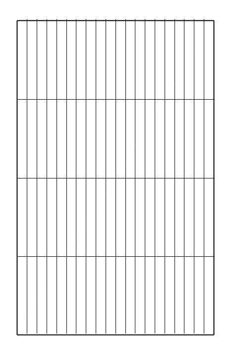

In the image below, the three horizontal lines are steel beams, and the many vertical lines are wooden beams. UPM planks are laid parallel to the steel beams and screwed into the wooden beams.
Diagram showing horizontal steel beams and vertical wooden joists intersecting, illustrating the placement of UPM planks parallel to the beams.
J justusandersson said:
In the image below, the three horizontal lines are steel beams, and the many vertical lines are wooden joists. UPM planks are laid parallel to the steel beams and screwed into the wooden joists.
[image]
The roof consists of tongue and groove planks - but they do not find support in the few steel beams and cannot lie on the wooden joists because then I will have screws through the roof and that cannot happen. The wooden joists you drew run across the slope and block the water. Also, having so few HEB beams seems amazing but that issue falls away due to the aforementioned.
Unfortunately, there is something I don't get. You don't have a sectional drawing?
Unfortunately, there's something I don't understand. You don't have a section drawing?
Thank you! It's great that you're challenging because nothing is set in stone. I sat down at the kitchen table with a scale and graph paper and made a sort of drawing which is attached. Overnight I thought that maybe you have a much thinner roof (than mine which is about 350 mm thick from UPM to the ceiling) and have recessed the beams into the HEB so that they provide support for both UPM and the ceiling? It's an interesting solution but probably places too much demand on the three HEB attachments where the load would be 10 times greater (I have 30 HEBs) than what is currently calculated (670 kg). Unfortunately, I haven't been able to brainstorm different counterproposals, but we have a construction meeting tomorrow...
Yes, now I understand better how you think. However, I believe that the construction contains some question marks. For example, how you will be able to attach the wooden studs without going through the waterproofing layer. The wooden studs are probably unnecessarily high, as they do not have any load-bearing function. Wouldn't it be better to build a loosely placed grid of wood with smaller dimensions? Also, I think that all the HEB beams together will make for a rather expensive construction. 31 HEB 120 together weigh just under 5000 kg, and at 20 SEK per kg, it amounts to approximately 100,000 SEK. If you instead use a strong glulam beam in combination with regular construction lumber, the corresponding cost should be under 20,000 SEK. If you can tolerate a middle pillar under the main beam, it will be even cheaper. But maybe there are other aspects that I am not aware of?

Hello again the project has now shifted back to Kerto beams... as you said with the price... I was also uninformed there.
