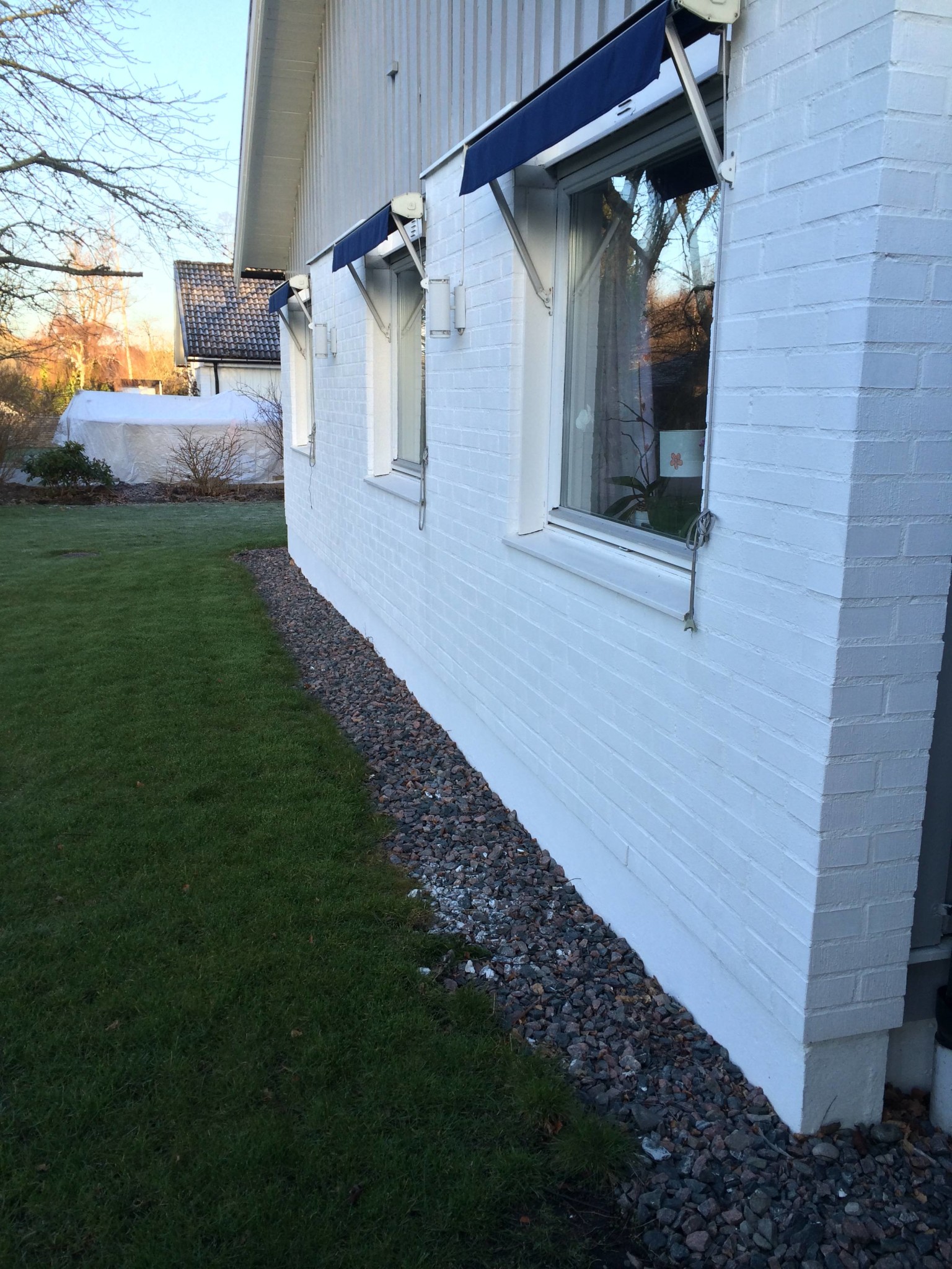

Worked fine. Went down under the metal sheet and screwed in cable holders. Then I chose to go down with the cable around the lamp so it entered from the bottom. The cable and holders are also white, so they're not visible at all.Z Zagerholm said:
That's probably what I'll do too then! Which attachment method did you use for the cable, screw clamps? Drill and plug in the joint?L Lewdis said:
Then I wonder how easy it is to get the lamp to sit neatly against the wall, the brick isn't exactly flat...
I used screw clamps so tightly that the cable was against the wall, I think I used plugs too. Don't remember if I went into the joint, I think I did but it was a while ago and unfortunately, I don't live in the house anymore so I can't check.Z Zagerholm said:
My wall was quite even so I had no problems getting the lamp to sit straight against the wall.
I found an old picture where you can see how the cable lies against the wall and goes around the lamp and underneath. Hope that can help you.Z Zagerholm said:

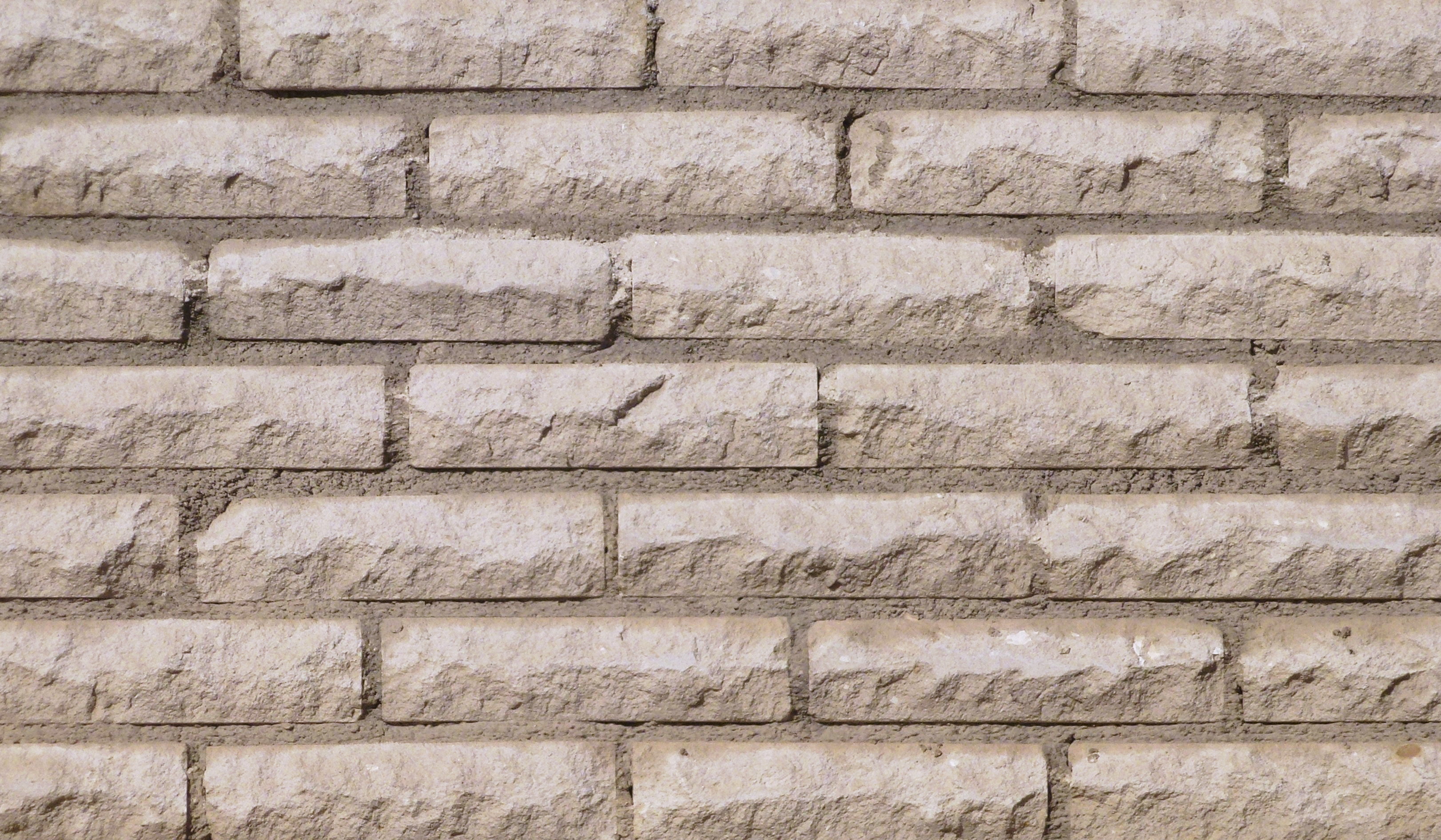

Nice! Thanks for the answers @Lewdis! Unfortunately, I have rounded Mexitegel like in the picture below, so it's not exactly smooth and even but bulges out in the middle. I'm considering chiseling it away so it becomes flat right where the lamp is supposed to be, or if there's a risk that the brick might crack then.. Thanks for the help anyway, I'll check further if anyone else has the same type of brick I have and has installed lamps!
Mexitegel/mexisten is a manufactured product that I guess is quite sensitive to impact and easily cracks when chiseled. I would think it's better to sand away material to get a flat surface if needed to install the lamp. I would try a grinding cup or just a stone disc for the angle grinder, depending a bit on the shape of the lamp bracket. In the end, you can probably adjust with a chisel/gouge that you scrape with.
