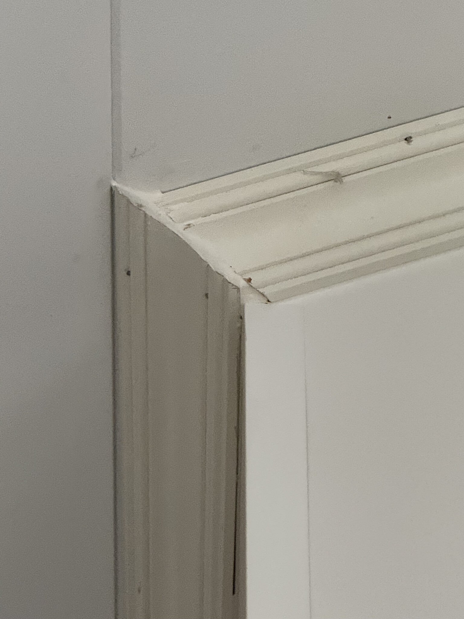

Unsure how to tackle this corner as it currently looks really ugly 🙈
I need to consider not only the 90-degree angle but also the slanted ceiling.
Any tips on how I should approach this?
A corner with uneven angles and a slanted ceiling, showing a challenge in trimming or molding installation.
Corner of a room with uneven molding, facing difficulty due to a sloped ceiling and a 90-degree angle.

Like a typical outer corner. Looks like the trim on the left is too long, the other one too short.

It’s impossible to miter these angles since you have a sloped ceiling; either use a corner block or use another type of molding that can butt against each other.

Sure, you can miter them together. The question is, as mentioned, how I should think about the angles etc.

Believe me, it won't work as the angle between the wall and ceiling is different on the two sides, so if you've mounted the molding as it should be against the wall (as you do if you have a flat "horizontal" ceiling), they will meet and build equally since the ceiling slopes...

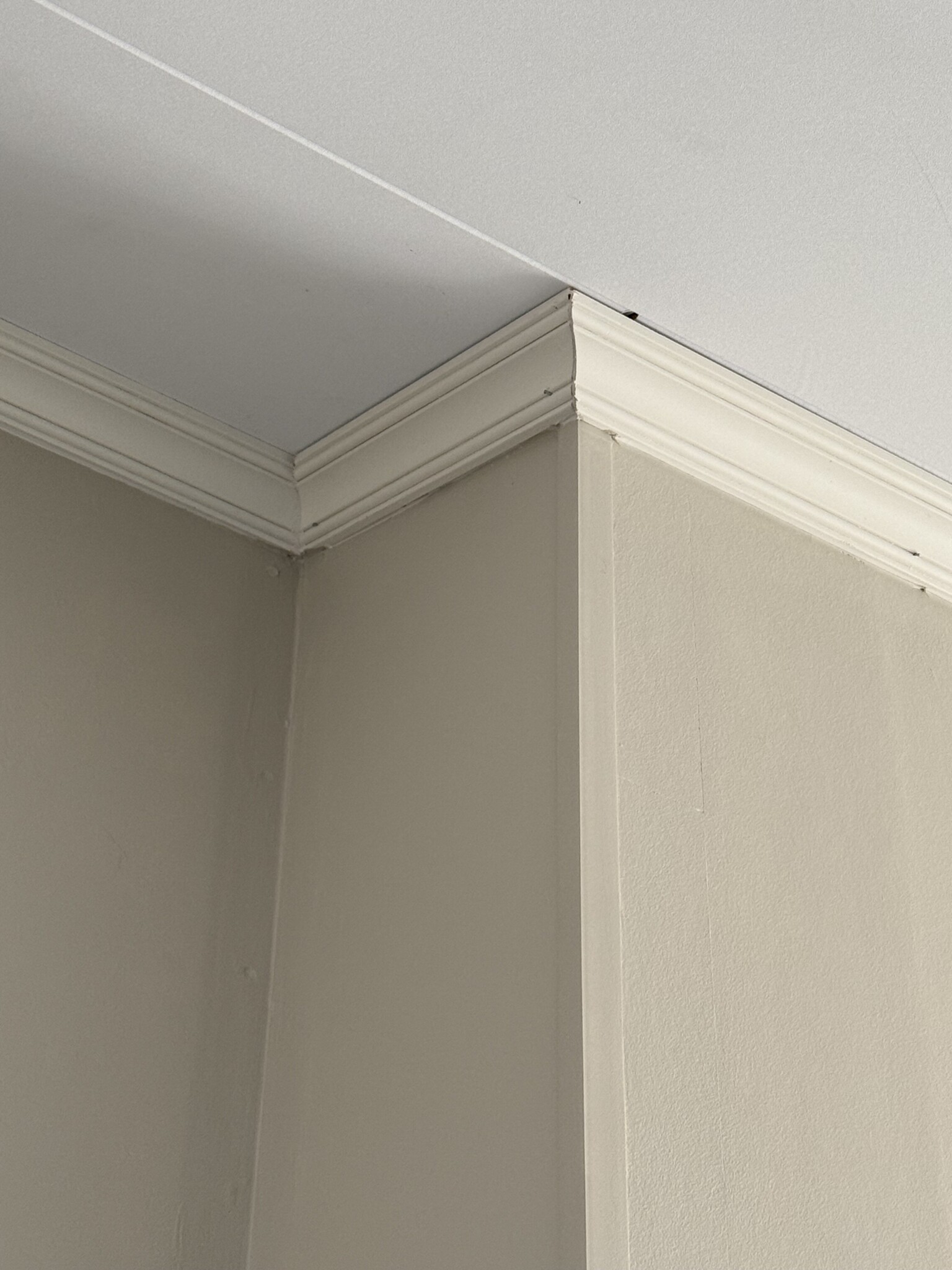

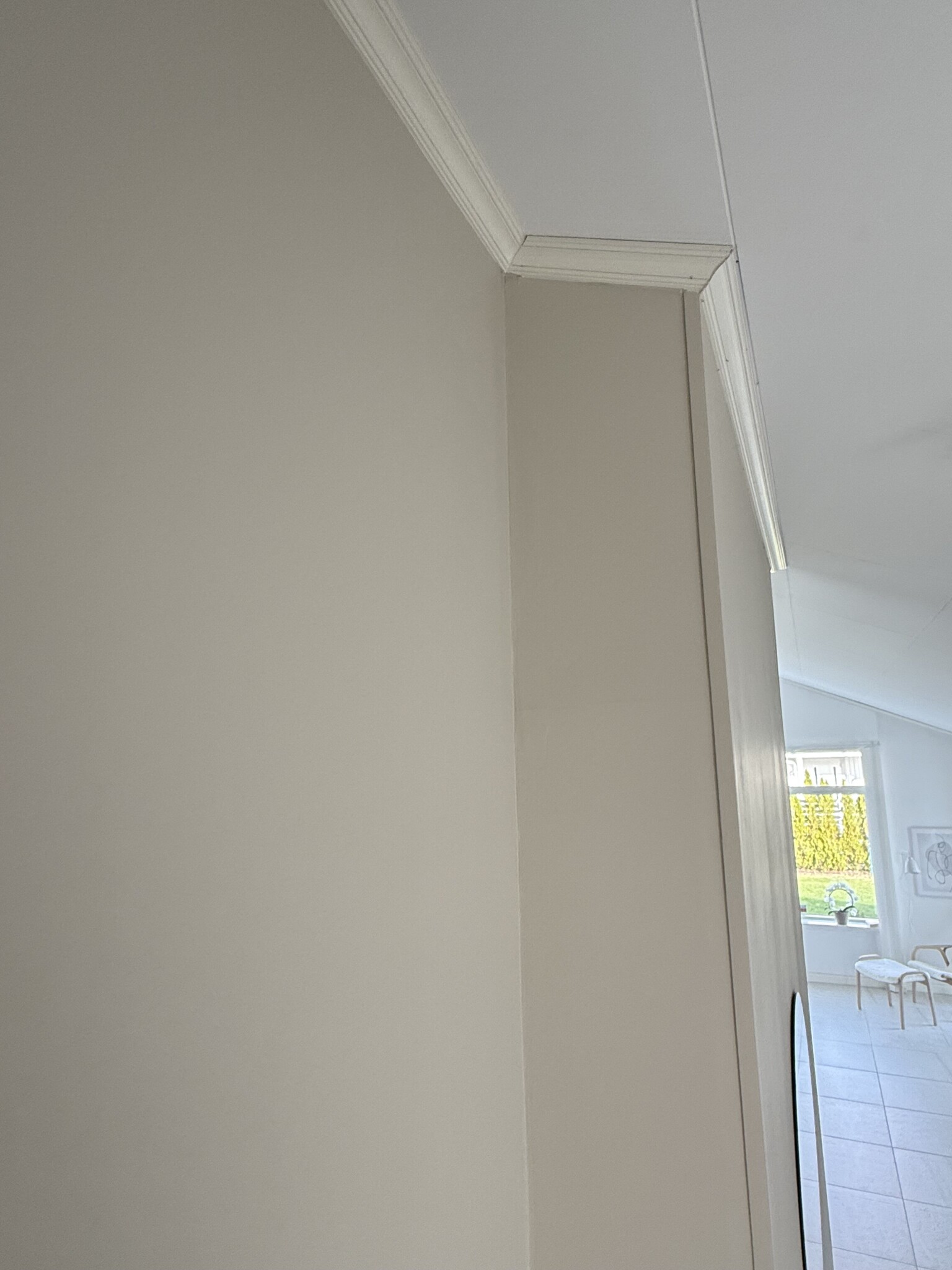

Okay. But when I look at the other side, it seems they have succeeded with the same task, sloped ceiling and wall.
Ceiling and wall corner with sloped ceiling and fitted crown molding.

Yes, but here you have no slanted ceiling; the angle between the wall and ceiling is 90 degrees, so it's simple😉

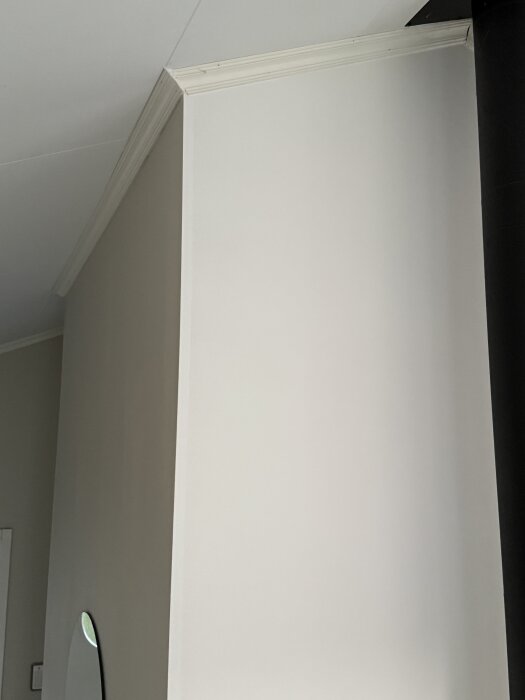

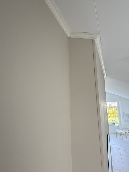

No, it's a sloped ceiling just like on the other side. Exactly the same angles. Sloped ceiling with equal angles, showing a transition from a room to a windowed area with light-colored walls and visible ceiling molding.

Then you've turned the molding so that it's not placed at 90 degrees against the wall, meaning the molding doesn't build to the same measurement but is angled!
P
The easiest way is probably to experiment with a couple of scrap pieces and see if it's possible to achieve. It will be a compound cut, 45° outer corner and simultaneously tilt the saw at half the roof pitch angle.
