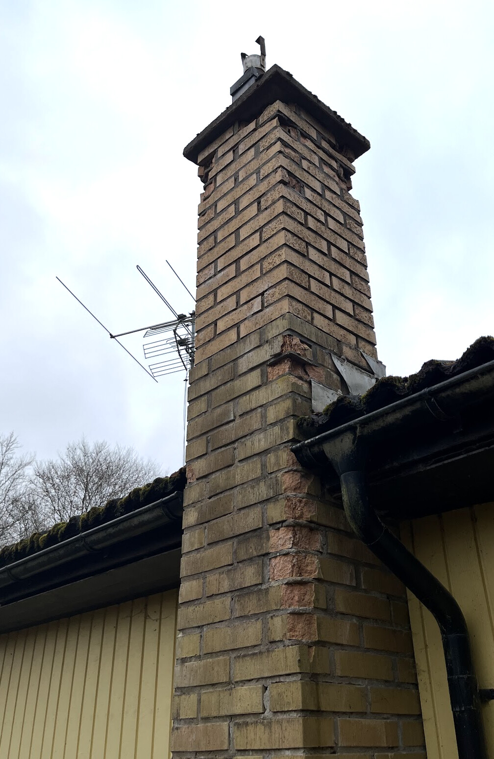

It's soon time to renovate this chimney. As you can see, several bricks have cracked and it looks like the upper part has already been replaced at an earlier occasion.
My plan is to refurbish it as follows:
1. Prime with rödbruk
2. Mesh (metal or plastic mesh)
3. Refurbish so everything becomes top-nice!
What do you think, is this a solution for the next hundred years or is it something I'll need to redo in 5 years?

The chimney looks like the start of decay in an unused house that hasn't been heated for many years; in short, water has been absorbed into the stones, and the cold has then caused the bricks to crack due to frost damage, and this has happened many times.
It also seems that water from the gutter has splashed onto the stones, causing frost damage there.
The reason I mention this is that even if you re-plaster the chimney, you will soon get frost damage again unless you solve the underlying problem - that the chimney is not kept warm so that it dries out quickly again after rain, and also ensure that water from the gutters doesn't splash onto the chimney stack.
What does it look like inside? Does it have a liner from the stove/fireplace, which one would almost assume when seeing the top of the chimney, which in that case worsens the possibilities of keeping the chimney naturally heated with ventilation air from the house compared to it being a brick flue.
I also can't help but wonder what the thinking was when building a chimney stack essentially outside the house. There's a lot of stored heat in the base of the chimney stack from the combustion gases that is lost in this way, whereas a centrally placed chimney stack would have provided noticeable warmth from the stack for at least 8-12 hours after burning.

I also guess there's a pipe in the chimney just like you suspect, and it's certainly a strange choice to have only one side of the chimney stack indoors, as much heat is lost.
In any case, what do you think about my renovation plan? If I make sure to use it continuously so it stays warm, does it have a chance to last a long time, or is it a job that will need to be "redone" in a couple of years?

If you want to plaster the chimney, you'll still need to chisel out and replace the damaged bricks before plastering..

Yes, it might be best to replace them, I was hoping to avoid that, but it might not last very long otherwise.
I suspect they have already had to replace the upper part of the chimney once, hence the different bricks.
