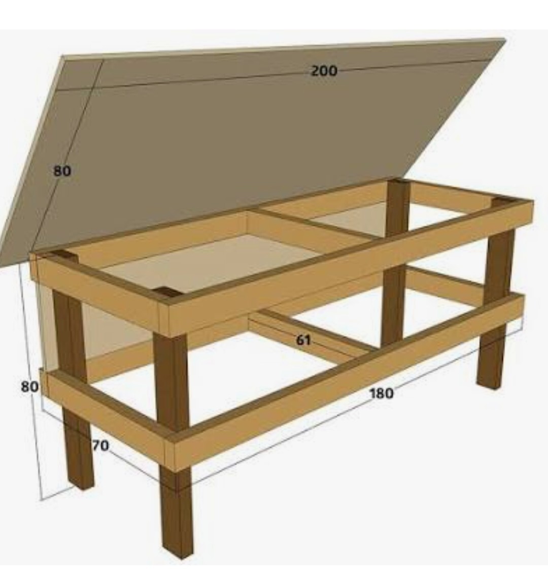

I'm planning to build a similar workbench for the garage like this one but smaller, with a length of 115cm instead of 180cm.
And a depth of 60cm instead of 70cm.
Is there no need for a support leg in the middle?
It will be made of 45x70 beams and then 12mm plywood on top.
(picture from the internet)
It will likely be used as a table and shelf for storage and not as a workbench in the long run, I would guess.
Thanks in advance

It will work out great. I'm working on a similar base for a router table which does bear more load than just storage.
On the back, I screw a plywood sheet to the legs to increase rigidity. A diagonal brace there would do the same job.
Consider if you should have wheels underneath. And a small vertical board along the back edge of the sheet prevents small items from falling into the depth there.
