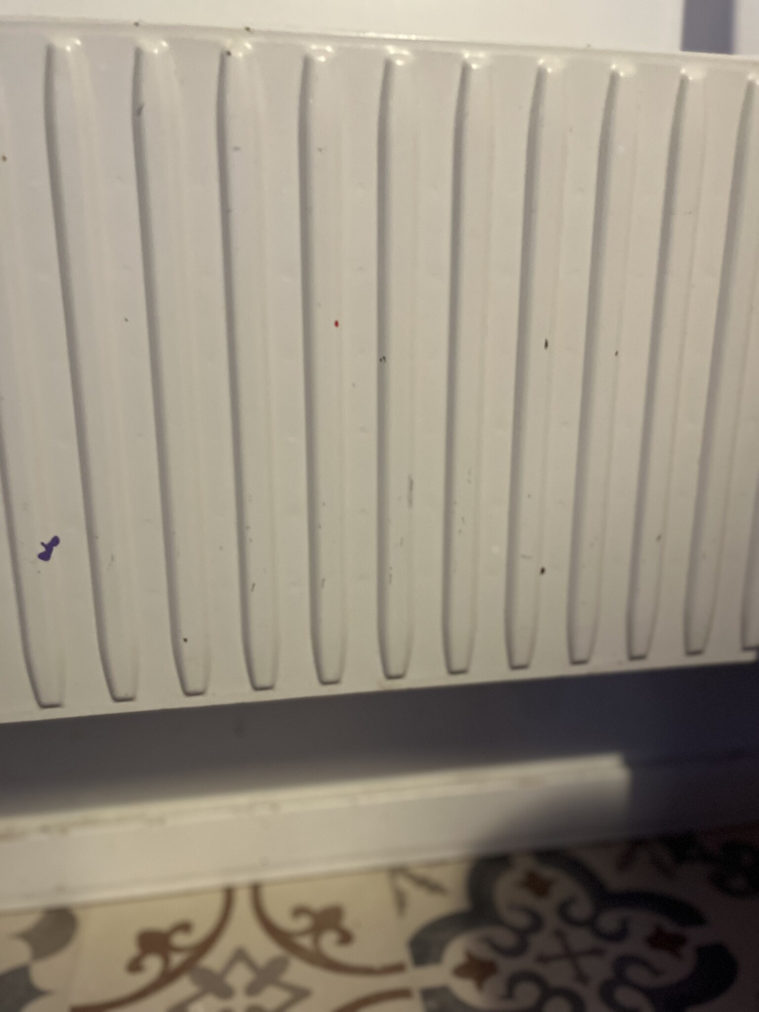

Pipes and radiators
– White painted pipes with chipped paint.
– White radiator with peeling paint.
My questions:

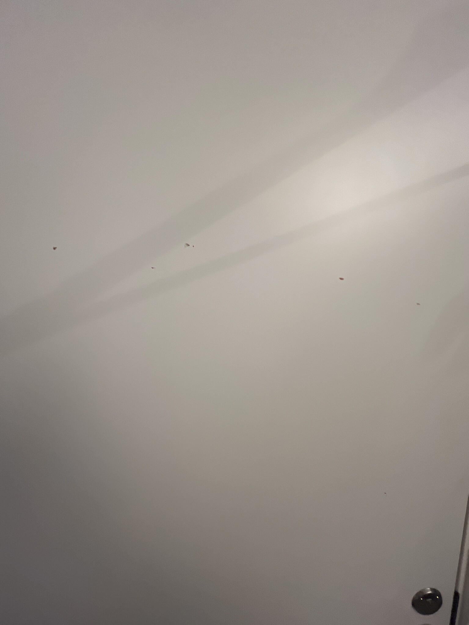

Interior doors
– Small unsightly marks and paint scrapes.
– A bathroom door seems to have been affected by moisture and is the most doubtful – unsure if it can be saved or should be replaced.

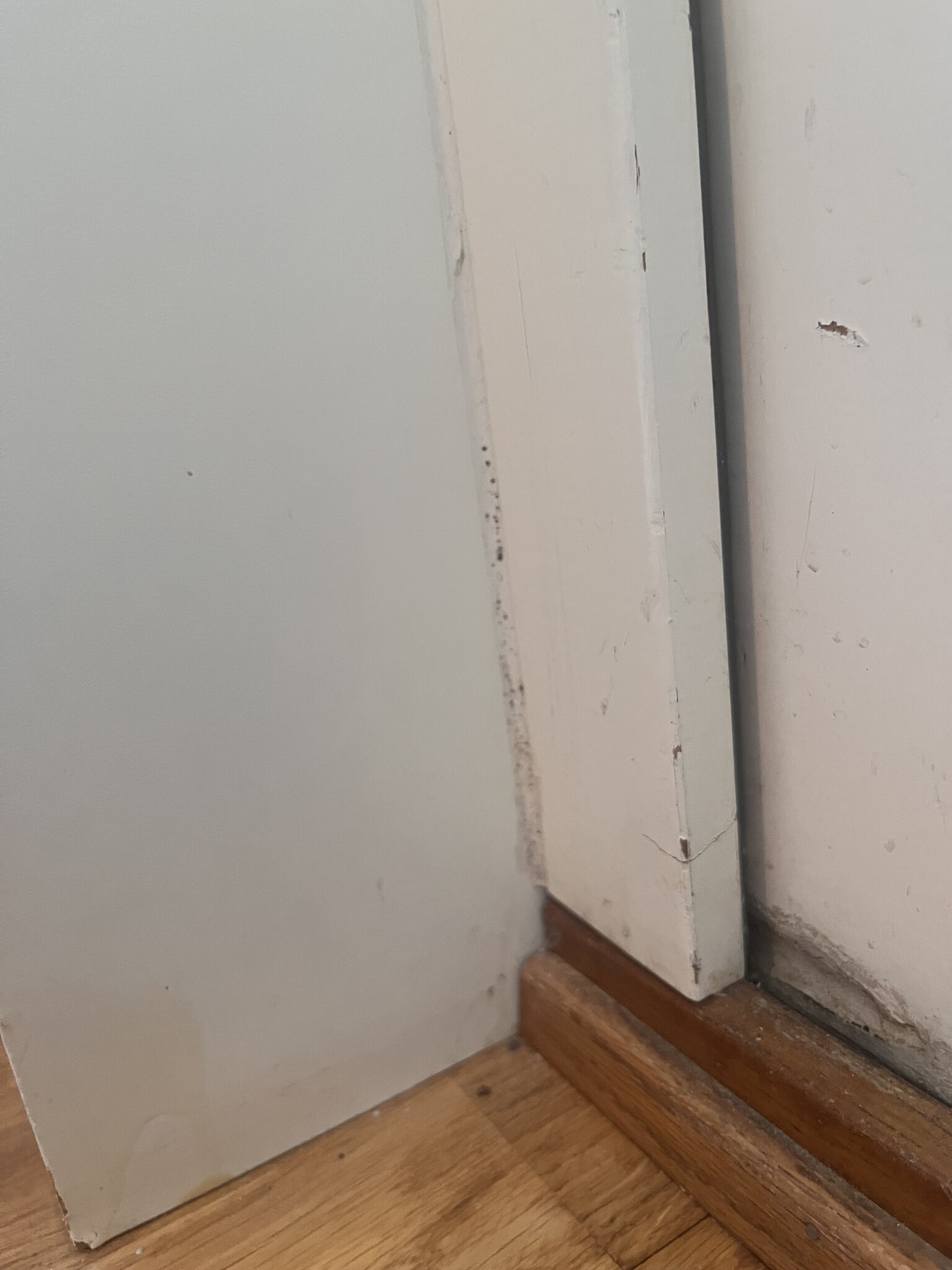

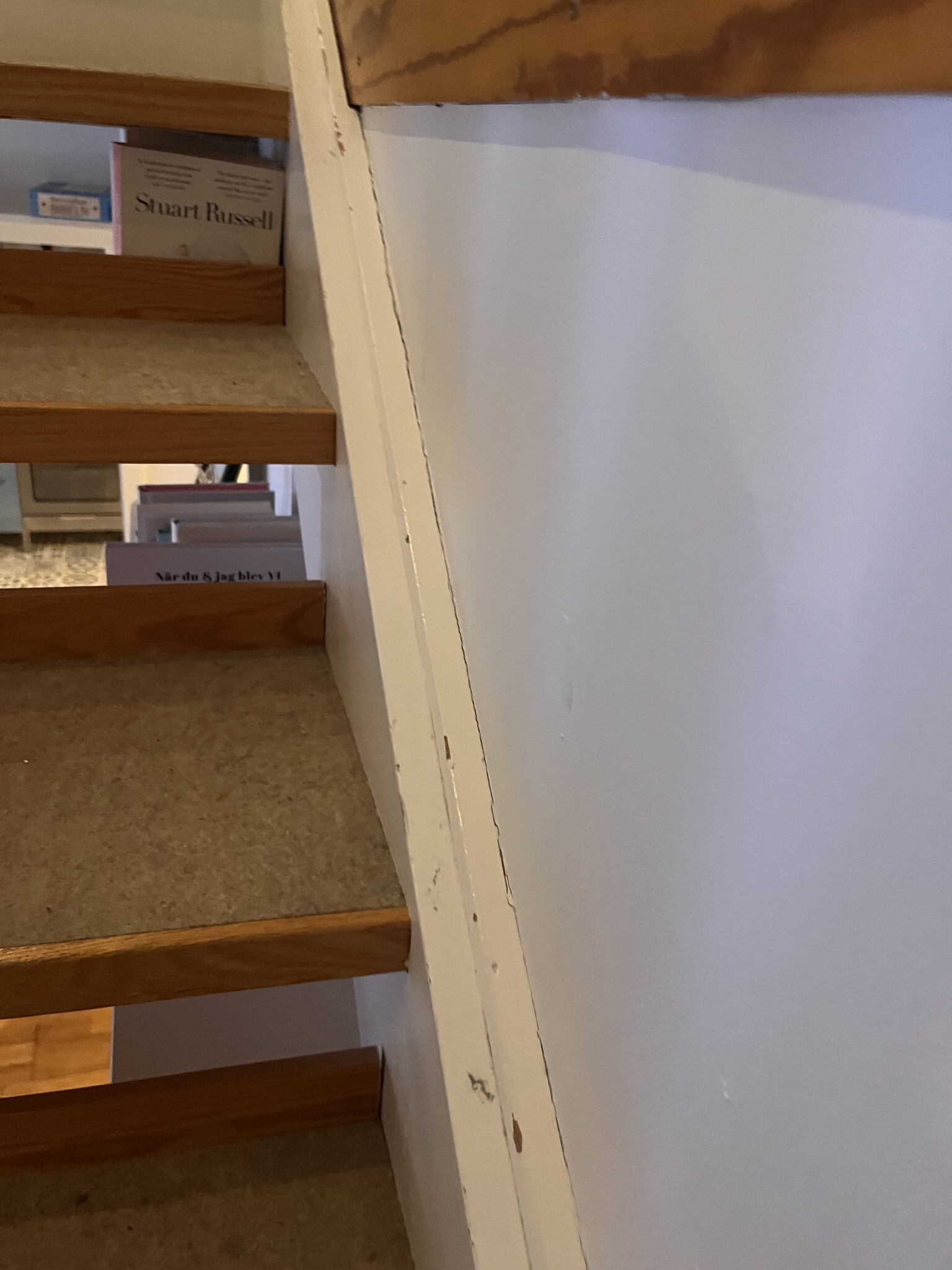

Moldings and trims
– Several moldings/trims have worn surfaces and flaking paint.
– Some I suspect need to be completely replaced.
– Total about 10–20 meters.
– Dimension of existing moldings: about 55 × 10 mm.
– Especially by the stairs, there is a vertical “plank/molding” against the wall (unsure of the correct term).

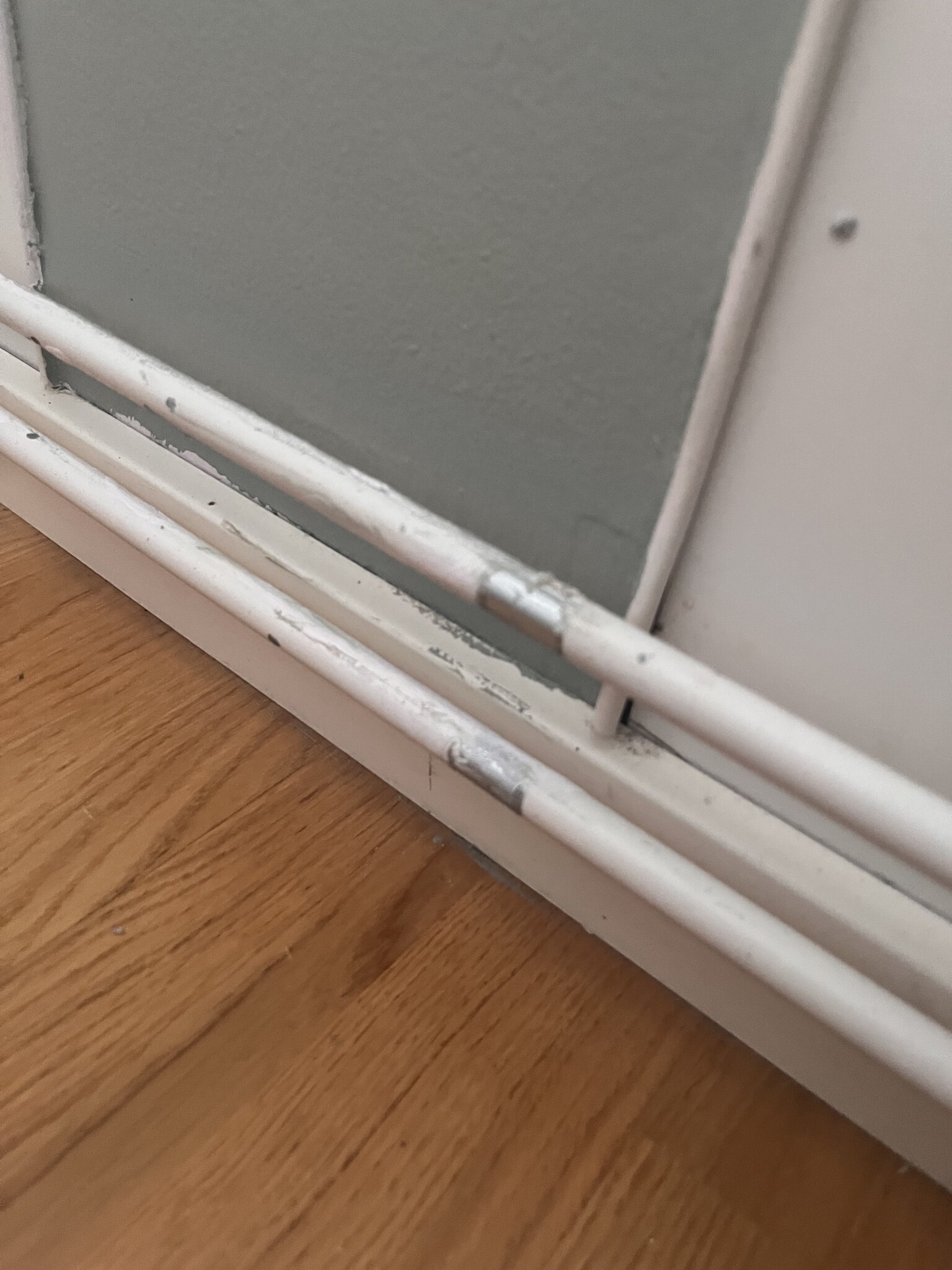

Pipes and radiators

What I'm leaning towards now is completely replacing the interior doors instead of trying to save them with painting, especially the bathroom door where moisture seems to be involved.
I'm also thinking of replacing the trim and baseboards that are very worn out instead of painting them. My belief is that this should be something even an enthusiastic amateur can handle with the right tools. Is that correct, or is there any particular step that tends to cause problems?
I plan to take care of the radiators and pipes myself. I'm inclined to spray them to achieve an even result. Is it reasonable to spray the entire radiator while just touching up the pipes where the paint has chipped, or should I think differently?

If the damage is small, I think it has worked well to just paint over with touch-up paint, small bottles with a built-in mini brush.E Emilvar said:
Maybe a new sealing strip will suffice.E Emilvar said:
The moisture damage on the door is probably difficult to repair. Water on panel materials causes them to swell, so you would need to plane/mill away the swelling and then fill it. It's rarely worth it. Regarding the leakage at the patio door, I believe the damage will recur if the leakage is not fixed, so that should probably be done quite soon.
