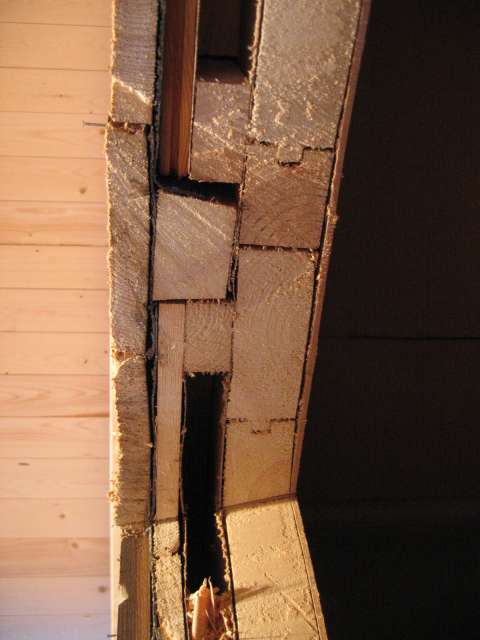

Well, started tearing a bit in the kid's room. What is what in our exterior walls? The house is from '47. Counting from the inside:
1: Wallpaper
2: Masonite that is 14-15mm thick
3: Paper that is red/gray and wavy
4: Wood frame?
My question is then, what are the paper and masonite for? Vapor/wind barrier or can you simply tear everything out and then put up drywall instead?

I think the cardboard is just there to keep the insulation in place while putting up the tretex boards. There's no point in having wind protection on the inside.
Tretex has the ability to insulate a little when it comes to cold, but quite a lot when it comes to sound. I would say it's not a problem to tear it down and put up plasterboard instead.

you are guaranteed to have a plank wall behind. you don't put gypsum against it unless you want a wavy wall.
set up the framework with 28x70 and align it with 60 cc, then plywood, then gypsum, then you have a nice wall.
otherwise, just put gypsum directly on the tretex.

have just been through the same question.
I tore off everything old and put windbreaker paper on the frame, then 45*45 studs with 45mm insulation and nailed on OSB board and then renovation plasterboard... done

Could there be some type of insulation in the outer wall or is it just plank?

If it is a egnahem, then this construction is likely.
Three layers of tar paper are present. One under the facade and one on each side of the sawdust.
(Left is the outer wall without battens but with the facade boards left, right is inward, with masonite on.)

Should I make a big hole in the wall to see what's there or should I go with one of the previous suggestions?
