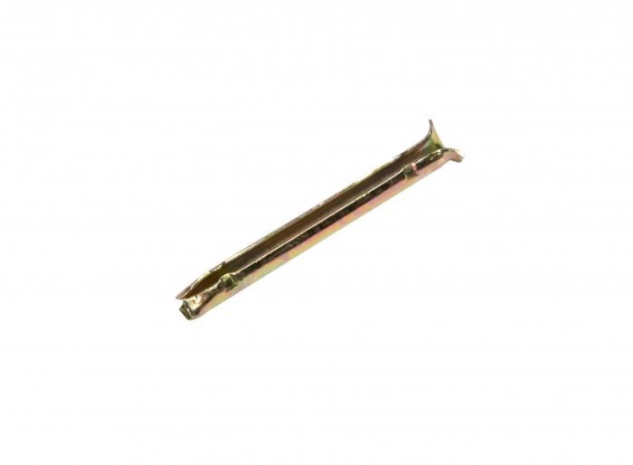

Why not use expanderspik? Cheap and good.
Two metal expansion nails used for secure fastening in construction projects.
  • Image of an expansion nail, suggested as a cost-effective building solution.
Mikael_L
KnockOnWood said:
Why not expansion nail? Cheap and good.
Doesn't work in lightweight concrete. The LECA lacks the strength for the expansion tube's pressure and surface hardness.

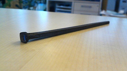

A bit like with the cut nail that my neighbor recommended to me.
A cut nail on a wooden surface, related to a discussion about its use in securing a garage sill to LECA blocks.
It was "his" carpenter who thought cut nails were perfect for LECA, and promptly nailed the sill to his garage with them.
And then I got a box of leftover cut nails sent with me to attach the sill to my garage.
But suspicious + curious as I am, I tried nailing one into LECA and could then pull it out basically with hand strength. It holds a little bit okay at first, but as soon as you move it a millimeter, it comes loose completely. Pretty obvious really.
I wonder how many garages that carpenter has attached with cut nails.
But probably none have blown away anyway, I can imagine...

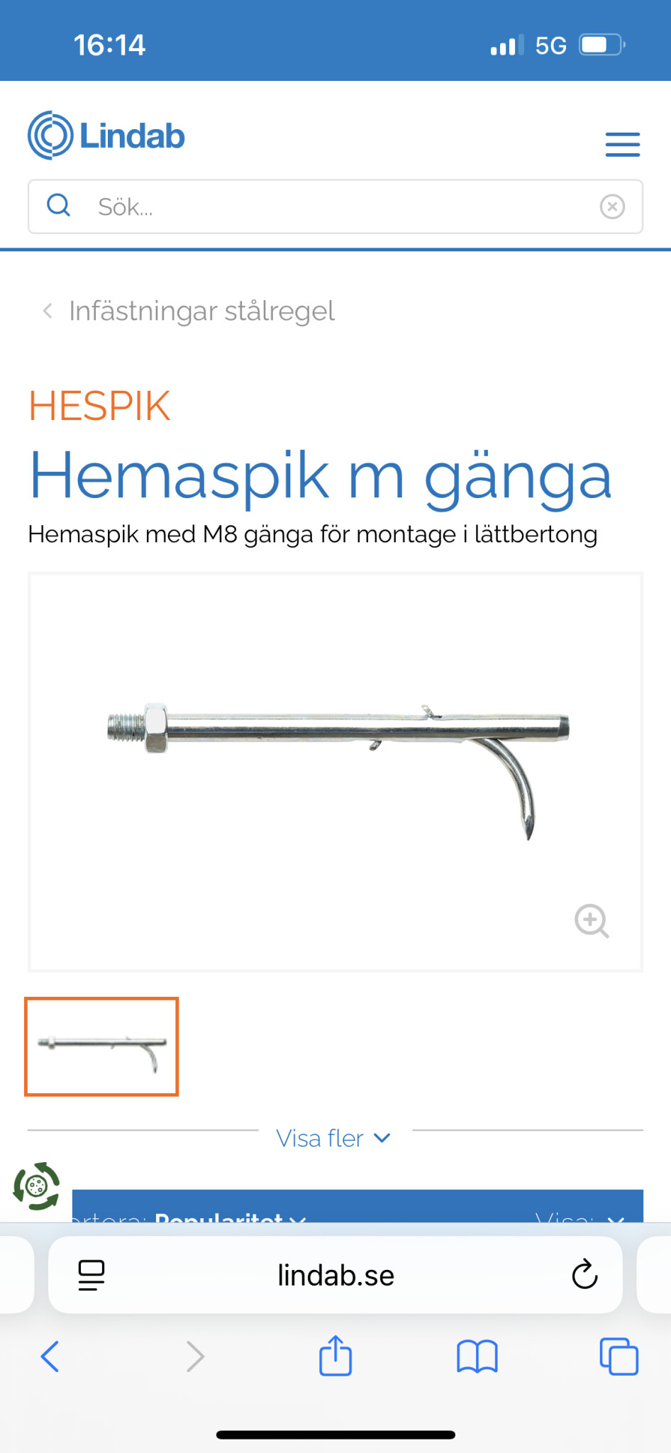

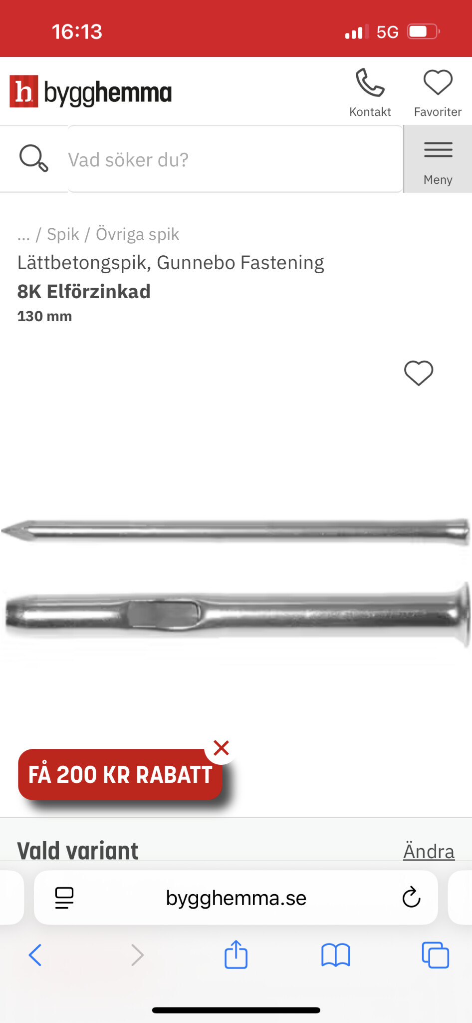

Adding to an old thread, maybe someone will find this useful...
I've used hemaspik, they hold like a rock. Expensive but well worth it. Tired of all the other variants that don't work so well.
Gunnebo sometimes calls them lättbetongspik:
Galvanized concrete nail by Gunnebo Fastening, 130 mm, suitable for concrete surfaces and designed for strong hold, as listed on bygghemma.se.
Available with nuts as well:
A threaded anchor pin called "Hemaspik" is displayed on a webpage for mounting in lightweight concrete.

Yes, if we are going with necro, I think it's better to drill through the lecablock down into the concrete below and attach threaded rod with chemical anchors (or even better, cast them in place when making the slab).
