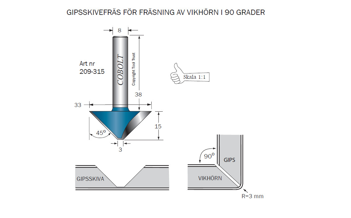

Is there anyone who V-notches their drywall boards to avoid open gypsum edges at 90° corners?
I've been looking for a tool to do this but have come up short, so now I'm thinking about how to solve it with existing tools. Some form of jig to allow me to run the multitool at a 45° angle against the drywall needs to be constructed, but it shouldn't just give me the angle; it also has to limit the tool's depth so I don't go through the paper on the front of the board.

In this case, I'm going to encase a drain pipe that runs down the inside of a wall in my kitchen, so I'm just going to make a drywall channel around the pipe. That drywall channel will then (unfortunately) need to be recessed into an overhead cabinet, so I'm planning to make it look as neat and tight as possible and then paint it black so it's as inconspicuous as possible inside the cabinet.
I have now bought a router (Bosch POF 1400 ACE). So now the hunt for a decent router bit has begun. All the dealers I've checked so far have too short 45° router bits. They need to be 13 mm deep to handle a plasterboard. On Aliexpress, I found fantastic "router bits," but I need the router now... not in 4-6 weeks.

I have now bought a hand router (Bosch POF 1400 ACE). So now the hunt for a decent router bit has begun. All the dealers I have checked so far have too short 45° router bits. They need to be 13 mm deep to handle a plasterboard. On Aliexpress, it was possible to find fantastic "router bits," but I need the router now... not in 4-6 weeks.

This must be the very definition of the term "spot on!"
Now I just need to "only" find a dealer with this on the shelf, I tip my hat to you!
If the edge is folded in this way, it will only be held together by a layer of paper, right? Do you think it's strong enough for it to be a durable corner?

If the edge is folded in this way, won't it be held together by only one layer of paper? Do you think it will be strong enough to be a durable corner?
Planning to screw it as well, but I want to avoid raw edges on the plasterboard.
