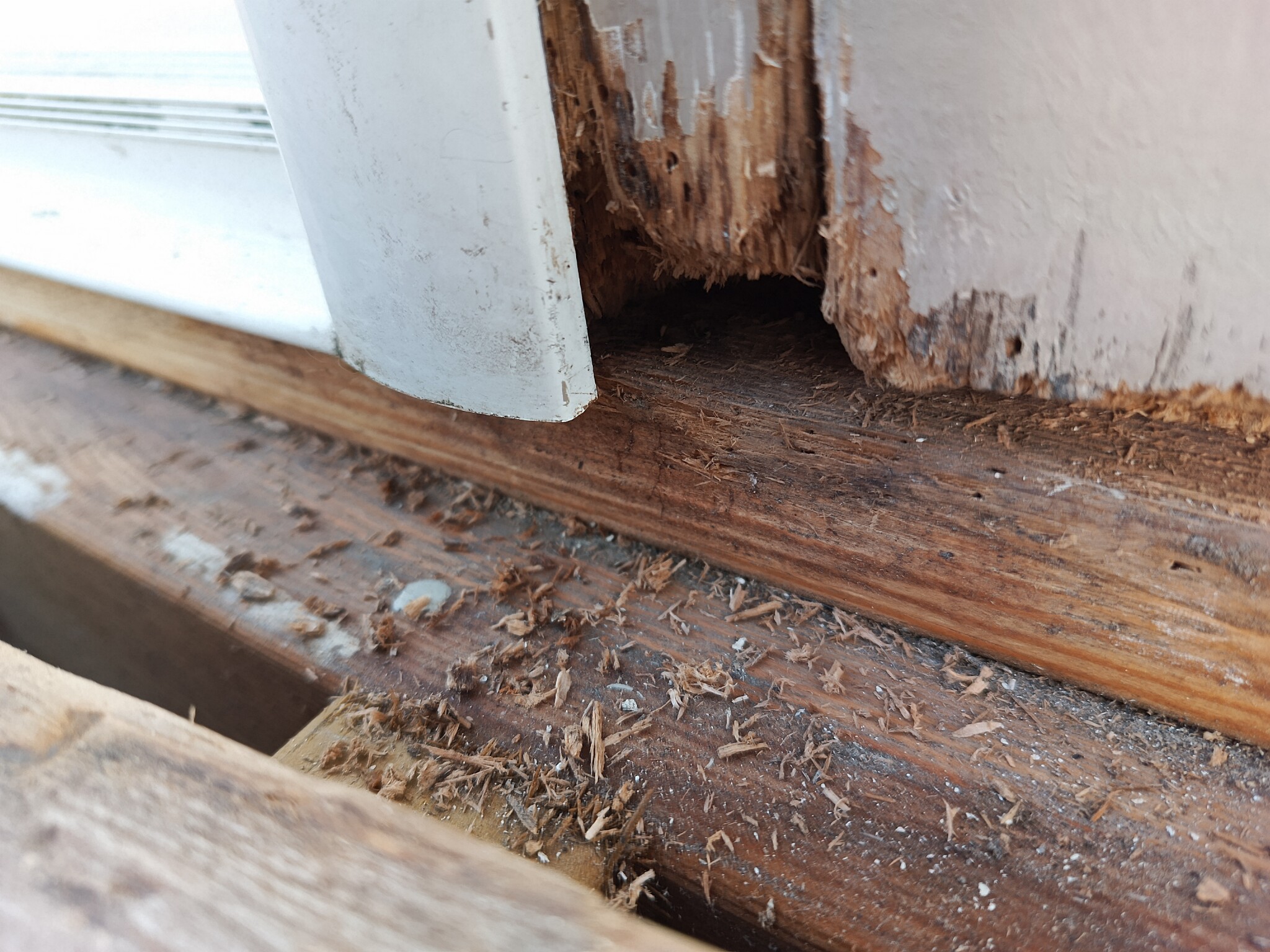

Hi, does anyone know if I can remove the white trim belonging to the Skånska Byggvaror conservatory? The wood is as damp as tinder, i.e., rotten behind the trim (measured 54% moisture yesterday and just over 20% today from the side). Other visible wood between 9-15% moisture, i.e., oil and paint = ok. I want to remove as much as possible and place a new block behind (oiled and painted). I'm considering putting sealant under the remaining wood, good/bad?
  • Close-up of a deteriorating wooden frame and a white plastic trim in a conservatory. The wood shows signs of rot and wear, with sawdust scattered around.
The list is fastened with 3-4 alu clips on the back of the alu list you want to remove. You just need to pry it off, and it will release. Try pulling it out a bit from the top, then when there's a gap, pry it out with a screwdriver. Check the instructions. Available on the skbv website. Search for s30 original design. Same instructions regardless of optimal or Isolent.
