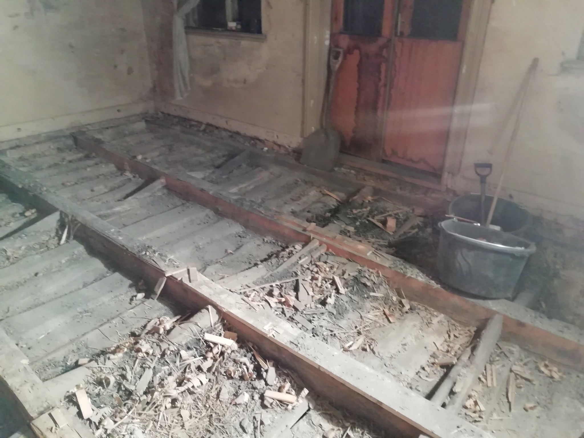

I am planning to reinforce a floor in a room that measures 6200 x 7200mm. The current beams are approximately 270x200 and are spaced at 1000cc. The floor is made of tongue-and-groove boards about 40mm, but it sags severely. Deflection is about 50mm in the middle compared to the edges.
What complicates the project is that there is a really fine ceiling painting in the plastered ceiling of the room below, so the utmost care needs to be taken to avoid cracks.
I can go up about 20mm above the existing beams and still make it look nice with a new tongue-and-groove floor. I am considering glue-laminated timber 270x90, but 270x115 in the middle. The new beams would then be placed 10-20mm above the existing ceiling to allow for some deflection. Reinforcement would be along the existing beams as well as cross beams.
Am I on the right track? Do you see any other options? I realize it will be costly with so much glue-laminated timber, but pillars are not an option.

Your existing floor joists probably have permanent deformations for some reason that is not obvious to me. In fact, that dimension should handle the span of 6.2 meters, but they have been subjected to extra large loads for a long time. The best solution is to keep these floor joists and insert new glulam beams in between them. The dimension of these beams should be slightly larger than what you mention. Suggestively 165x270 mm (width first). To achieve a reasonable c/c distance for your floorboards, I also suggest that you screw in new battens on the side of your old floor joists. These battens, which don’t need to be taller than necessary to screw in, should be leveled so they align with the glulam beams. On top of this, you can either lay new floorboards or combine a screw-glued chipboard with thinner floorboards. The latter option provides a stiffer floor.

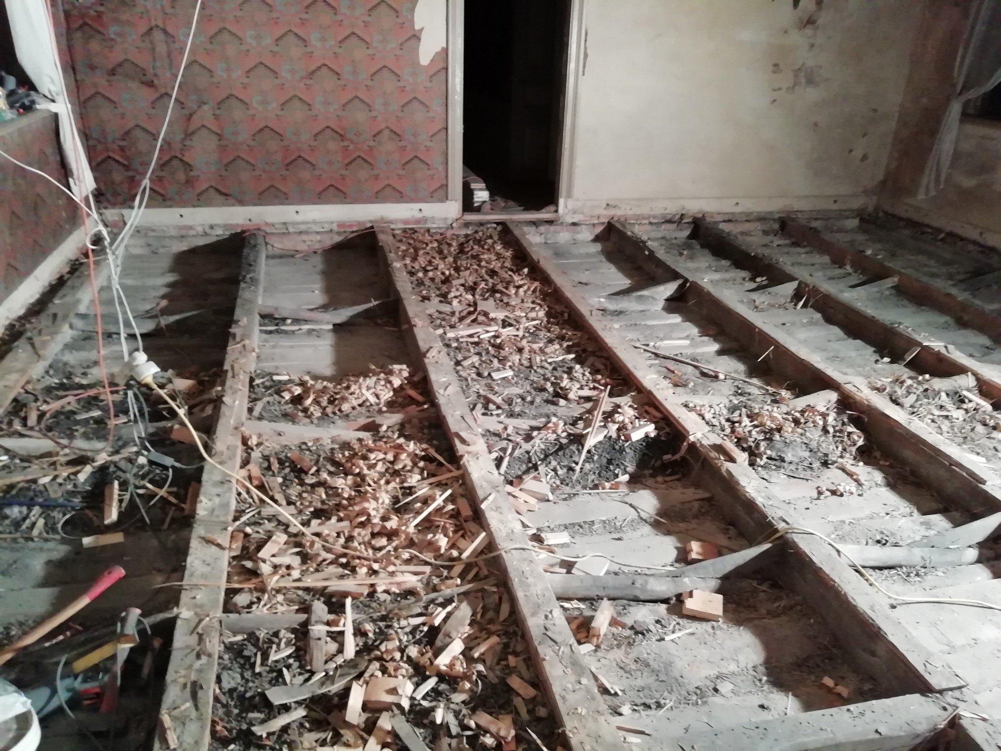

Can probably confirm long-term load, as you can see in the pictures there is a beam along the joists. On these rest boards and logs. On top, there was over 10cm of lime plaster mixed with reeds, and finally coal and gravel. We've probably shoveled out a ton and are not done yet..J justusandersson said:

I do not envy the work, but it seems to be an interesting building. The cracked panel on the underside of the beams, which is most clearly visible in image 1, suggests that the ceiling in the floor below consists of plaster on a reed mat. You must be careful with that. The diligently done cross bracing was intended to limit the floor's deflection but has had no effect on the excessive loads.
That's correct, there are some cracks in the ceiling but overall it is in good condition with a beautiful ceiling painting in the hall below, so the work is carried out with great caution.J justusandersson said:I do not envy the work but it seems to be an interesting building. The cracked panel on the underside of the beams, most clearly visible in image 1, suggests that the ceiling in the floor below consists of plaster on "rörning" (reed mat). You must be careful with that. The diligently made cross bracing was intended to limit the floor's deflection but hasn't had any effect on the excessive loads.
